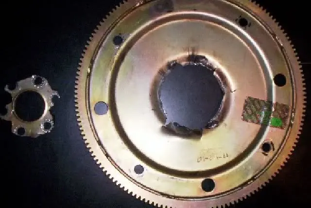

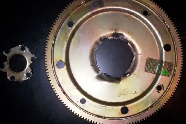

This was at 2am in the morning:

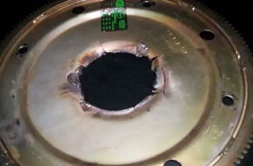

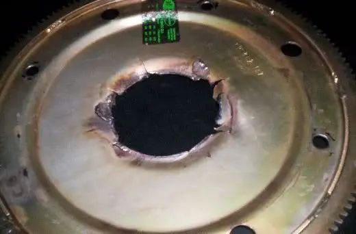

The aftermath when I droped the tranny:
Keep in mind, this was a SCAT SFI racing flex plate, I have since purchased a JW "The wheel" Flex plate, and never looked back:nice:
-Will

Will,
WOW!! I always wondered about some of the flexplates, they just didn't look strong enought to me to hold this kind of hp and torque. Glad you found a good one! Now I see why you were not there.:D
