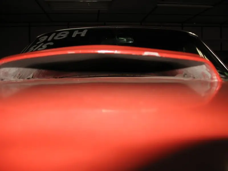

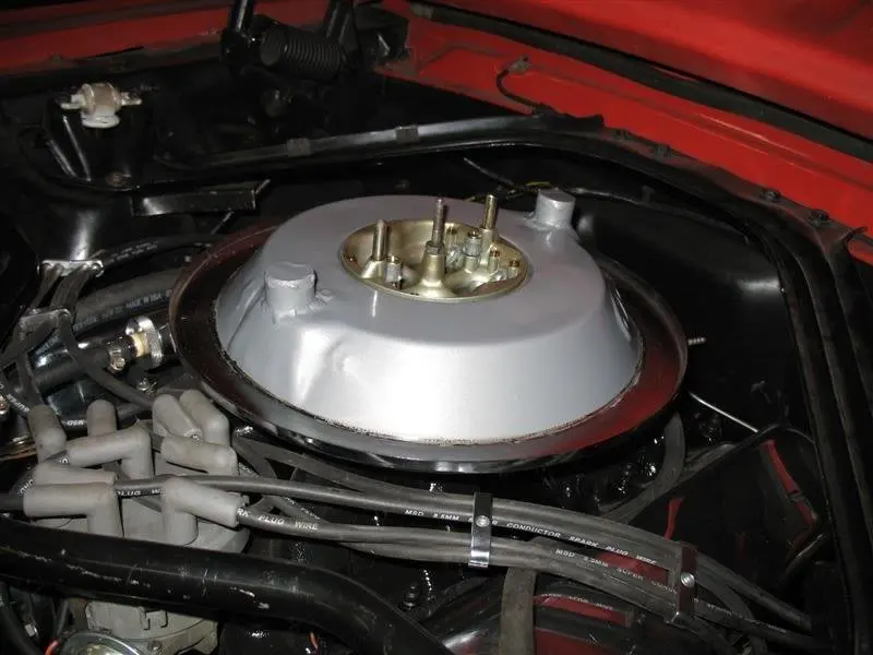

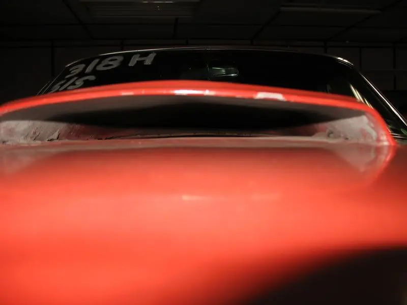

I have a Vic Jr on my 393w under a shelby hood scoop of my 65'. The scoop was grafted on for looks and is not needed for my Vic Jr. installation, although it does allow me to use a fancy air cleaner hold down.
Here is how I did it:
1. Drop the motor in the chassis as far as it can go. I used 65' pedestal motor mounts which puts the pan just above the tubular crossmember.
2. Angle mill the carb flange on the Vic Jr. You need to take .300 off the front of the pad and near zero at the rear. This lowers the front of the carb and makes this swap possible.
3. Use a carb that originally was produced without a choke. The bodies air cleaner flange is physically lower and you don't have to worry about the choke being in the way.
4. Modified a 14" drop open element air filter housing so it sits even lower on the holley.
With these mods I use a 2 3/4" high air filter element. It provides the desired minimum 1 1/4" filter base to top clearance.

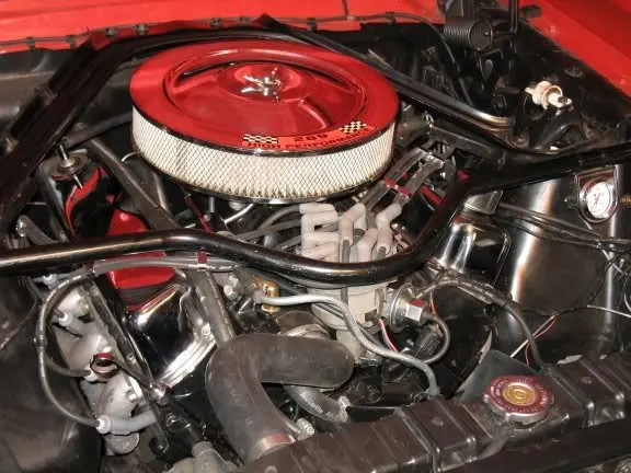

After installation I have 3/8" of air cleaner top to hood clearance. To keep the motor from twisting and lessening the clearance, I use a torque strap to hold the motor into place. This has worked well with my 393w 4 speed street car--even at the drag strip using slicks the controlled torque keeps the air cleaner from hitting the hood.
Here it is using in 289 HiPo disguise:
