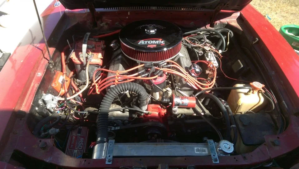

Aftermarket EFI is honestly not a bad solution. I've got the MSD Atomic EFI on my car. I like it a lot, though I wish I'd gone with either the Holley Terminator or the FAST EZ-EFI (having now seen all three systems in action in person), especially now that Holley bought MSD.

There's mine. Mine doesn't clear the stock hood due to the 1" spacers on the motor mounts for oil pan clearance (running a Milodon 8-qt pan), combined with my Performer RPM intake, but it would with a shorter intake and without the spacers on my motor mounts.
How was tuning yours? Did you take it somewhere or did you do it yourself. Im wondering because if i need to take it somewhere idk what shops can work with that system
