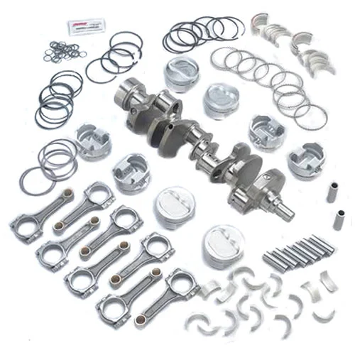

That may have been the case back in the day, but now days, a 351 w block, and 1000.00 gets you 408-416 c.i.
Crank, rods, pistons, ( hyperucraptic ) pins, bearings, and locks. For somebody that is just looking for a big power, big torque " big block in a small block" pkg, that isn't looking to add a power adder on top of it, this would be perfect.
