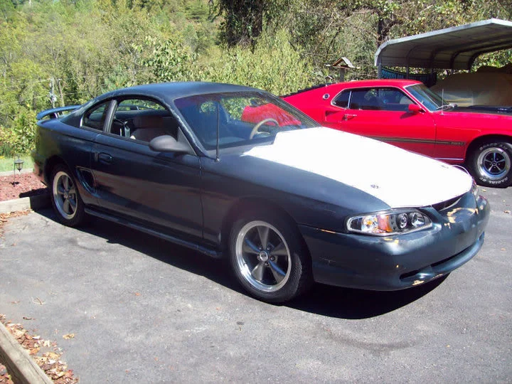

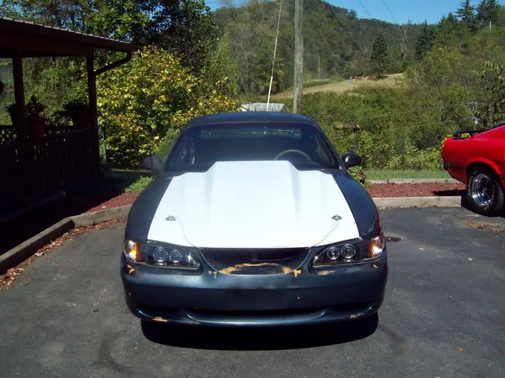

How big of cowl did you need?
Good work!
zap-o-matic
Sep 10, 2010
44
Oct 5, 2010
#25
  • Oct 5, 2010
  • #25
Good work!
Its still VERY rough, I'm getting it running and reliable before I paint, or do any body work.
And that was the smallest cowl I could get away with to make everything fit lol.

I have a 4" cowl too. I think it looks great. Car needs to be lowered pretty bad.
Kurt
zap-o-matic
Sep 10, 2010
44
Oct 6, 2010
#27
  • Oct 6, 2010
  • #27
I would lower mine, but with the horrific roads of Eastern Ky, its not such a good idea. Mine sets pretty level surprisingly, but I may get brave enough to take it down just a little bit...with the long tube headers hanging down, it may be a challenge on these roads.
