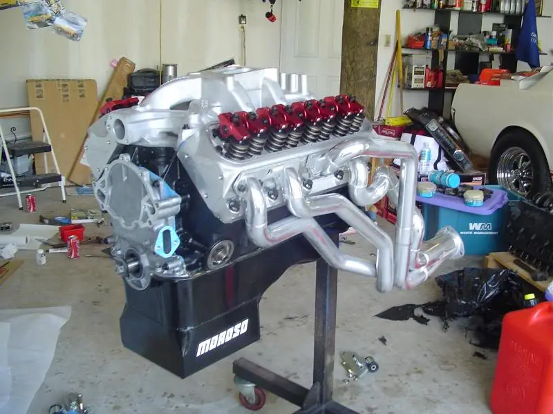

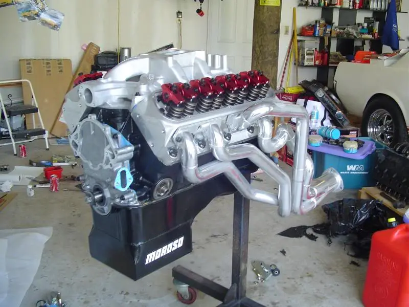

Build Update
For those interested, I thought I'd provide an update:
I'm doing a 408W, build is nearly complete. The specifics are:
Stroker 351W=>408
CR about 10.4:1
Forged Crank, forged Rods, forged pistons, RA internally balanced
AFR 205 Heads prepped by FTI
Custom HR Cam by FTI. (23xI/24xE)
Edelbrock Vic Jr intake
Ford C6 w/ converter by Ultimate Converter Concepts
Ford 9 inch diff
Ford PowerTrain App. 1 3/4" LT Headers
Still along way to go on the car as it needs wiring and paint. Will let you all know how it goes. Thanks.
Engine is just being finished up now. The C6 is not in yet. The shop dropping in the motor and trans put a 460 Big block and C6 in a '66 Fastback a while back so they're not expecting anything they can't deal with. They typically like to fab up whatever they need to make things work. Originally, I wasn't planning to use a C6 but it was given to me so the price was right.
