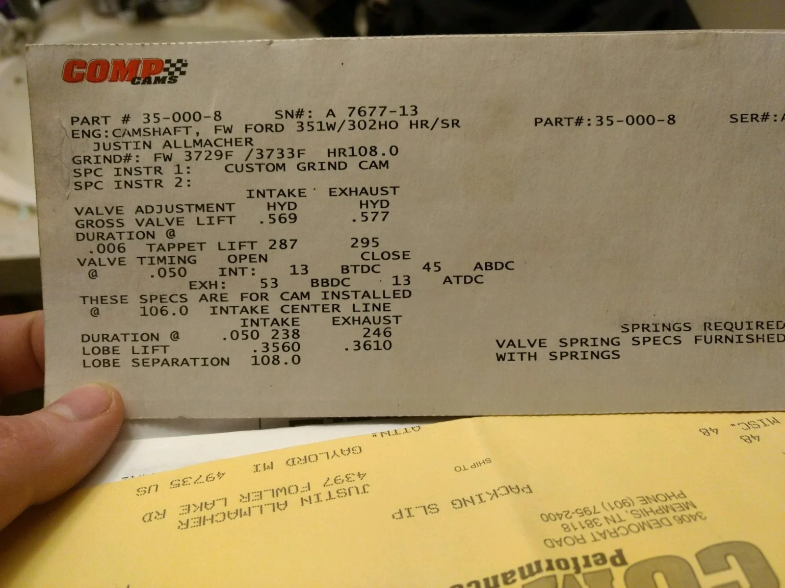

Hello all,
I purchased an 84 mustang GT with the following engine specs (at least what I was told):
351w bored .30 over
.577 lift comp cam
Edelebrock heads.
750 holley carb
Victor Jr Intake
I don't know much more about the engine but know the cam in the car was a custom comp cams grind. Would anyone be able to enlighten me about the specs posted about the cam.
Thanks,
Jay
