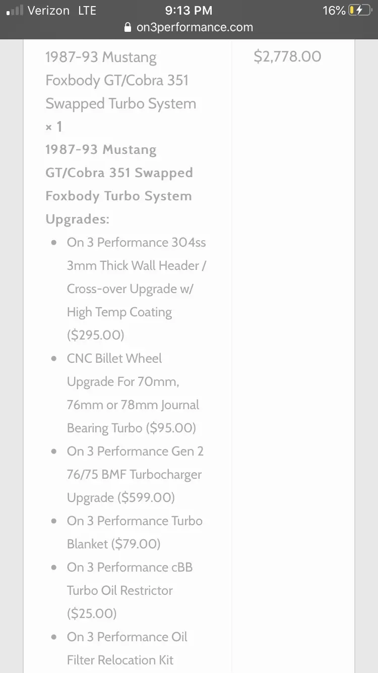

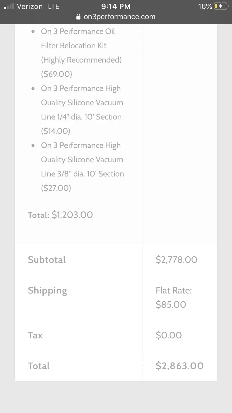

I’m running a PiMPxs and have most of the parts to convert to CNP with the expansion from Stinger. I have read/ watched videos that state I should wrap everything!! Thanks for the heads up about the weak clamps. This is what’s in the cart as of now, I forgot to add them.

I didn't purchase anything extra from them. You can get a turbo blanket on ebay for $25. I guarantee it's the same thing they're just making it convenient. I purchased an aftermarket vacumn tree on ebay and mounted it on the pass. side firewall. This allows you to run all the vacumn for the turbo without messing with anything else. Also,if you dont have a MM clutch cable,get one! Gives you tons of room to get around the forward facing header. I would skip the oil relocation kit as well,haven't heard anything good about it. Unfortunately,the FMS filter adapter is on national backorder. You can source one from a 5.0 Explorer though.

I actually bought and plan to convert to a McLeod hydro clutch, so no cable there by the time I get this installed. I will look at eBay for a blanket. I thought about the old explorer one,Thanks for confirming that had one back in the day. I’ll also look at that xtra vacuum tree.
