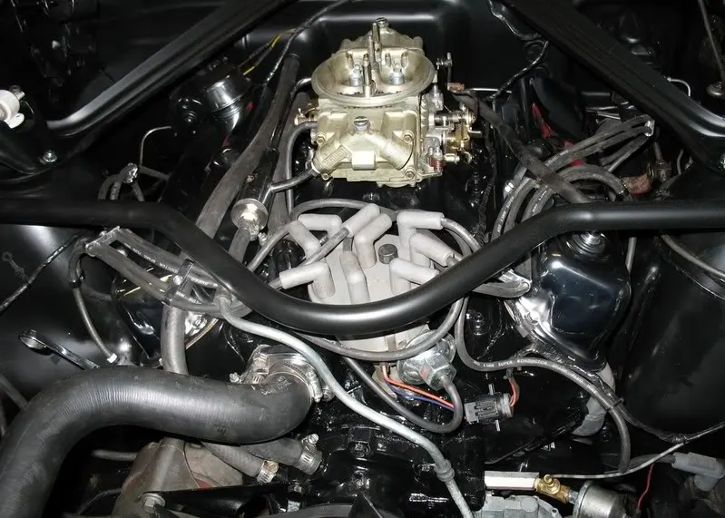

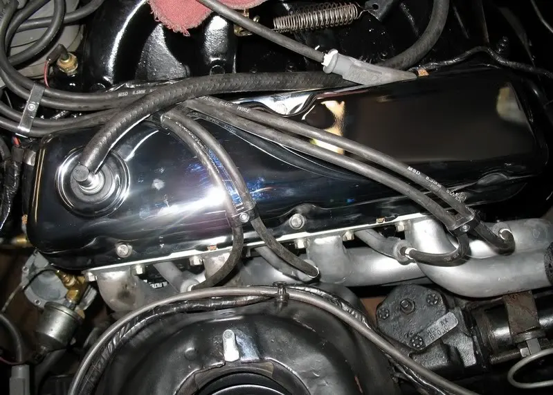

dennis112 15 Year Member May 15, 2005 1,561 36 79 Amish Wonderland of Central PA. May 21, 2007 #2 May 21, 2007 #2 nitequill said: im putting a 351W into my 65 and it is a tight fit but my steering column is touching any way around this? Click to expand... What exactly is touching the steering column? The block shouldn't as there is lots of room there. Headers might hit. Need more info. You should be able to bolt the motor in using the 65' 289 mounts. About the only difficult area is the exhaust. Custom headers are a necessity. Here is my 351w block with stock steering column 65' stang: Here is the a top shot of my 393w motor:
