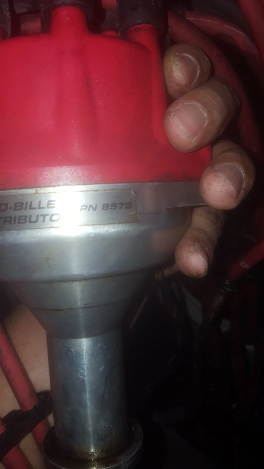

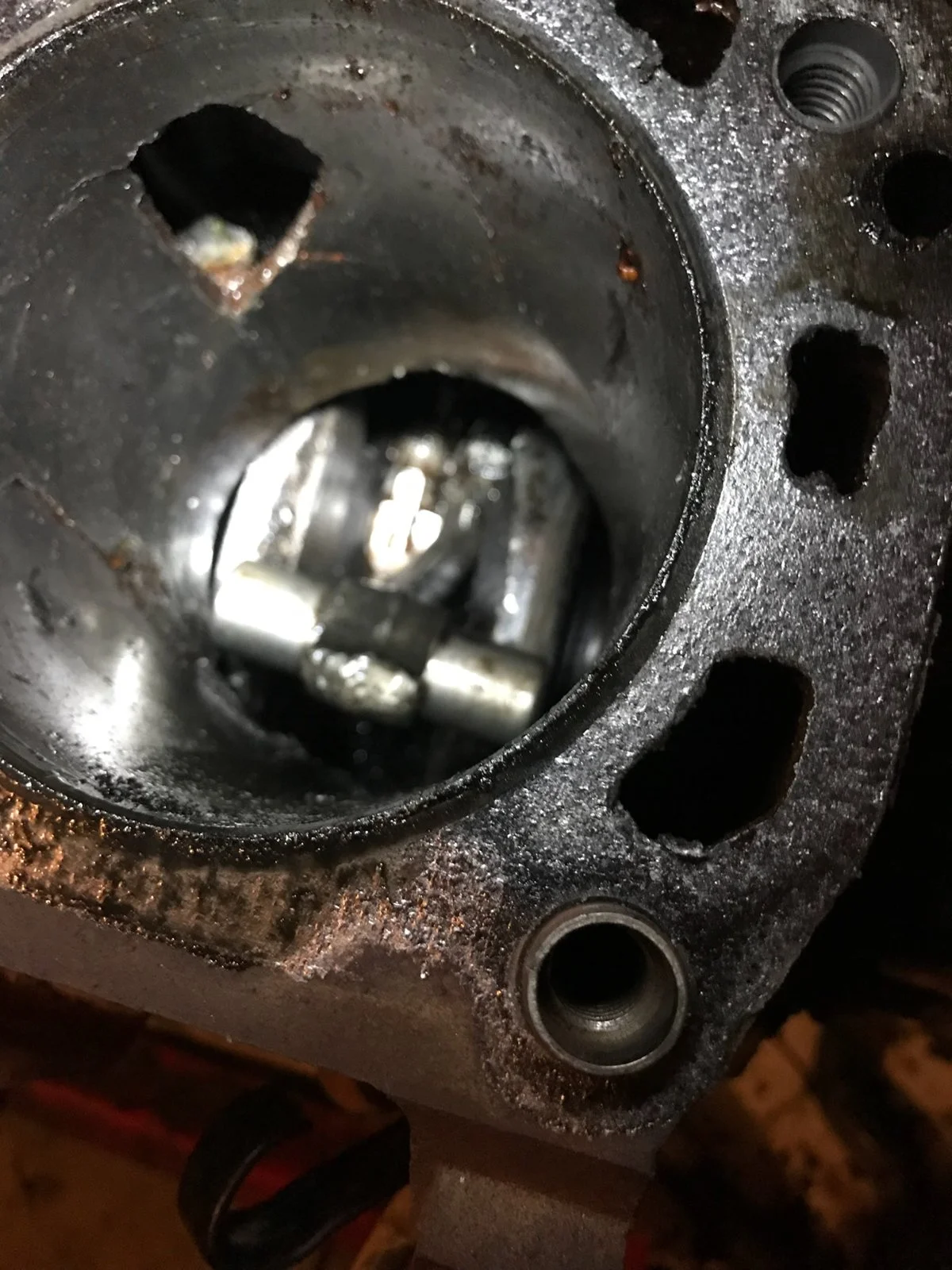

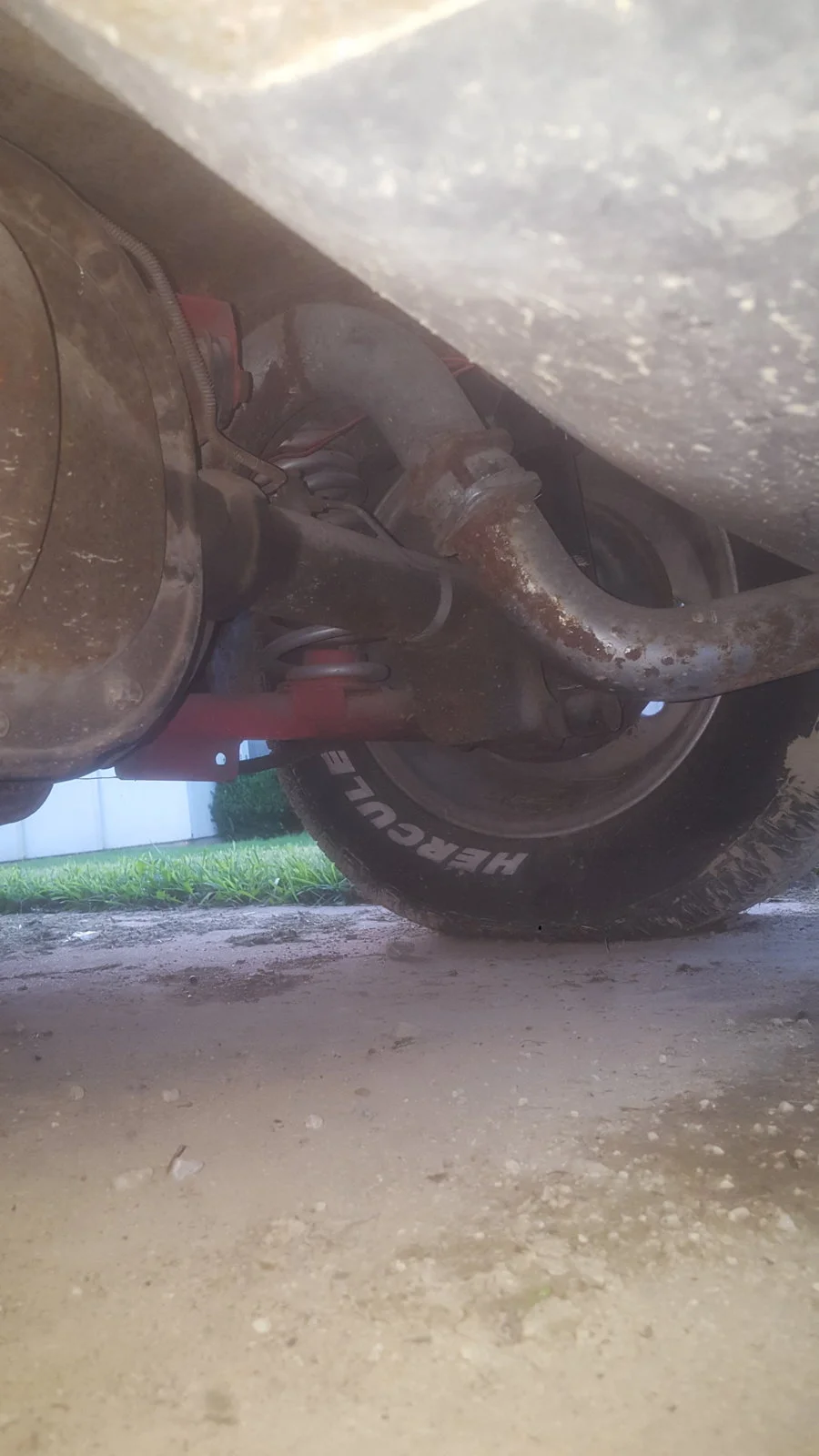

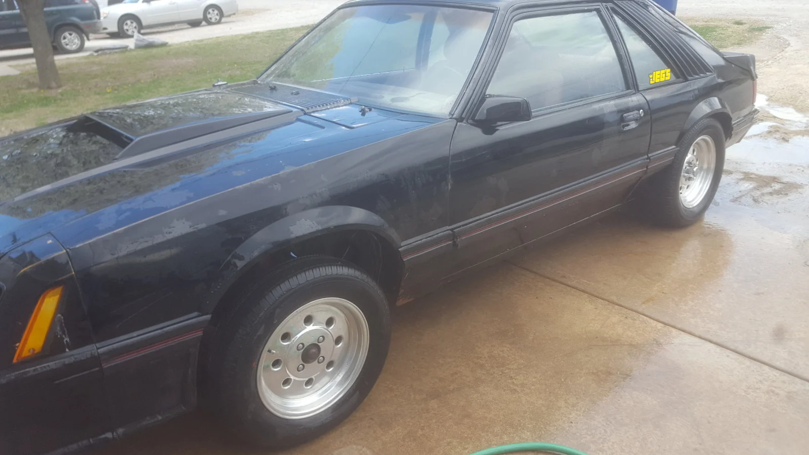

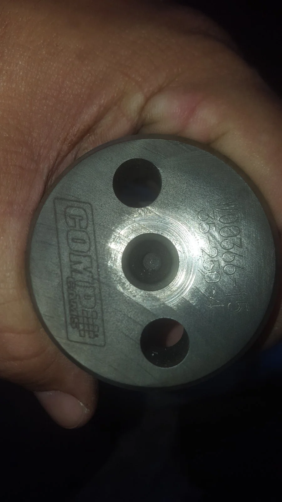

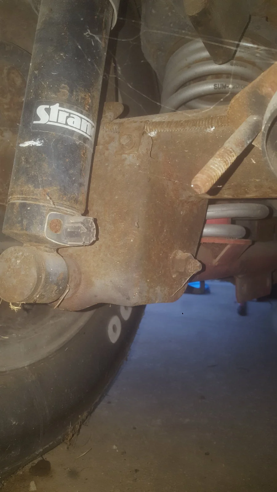

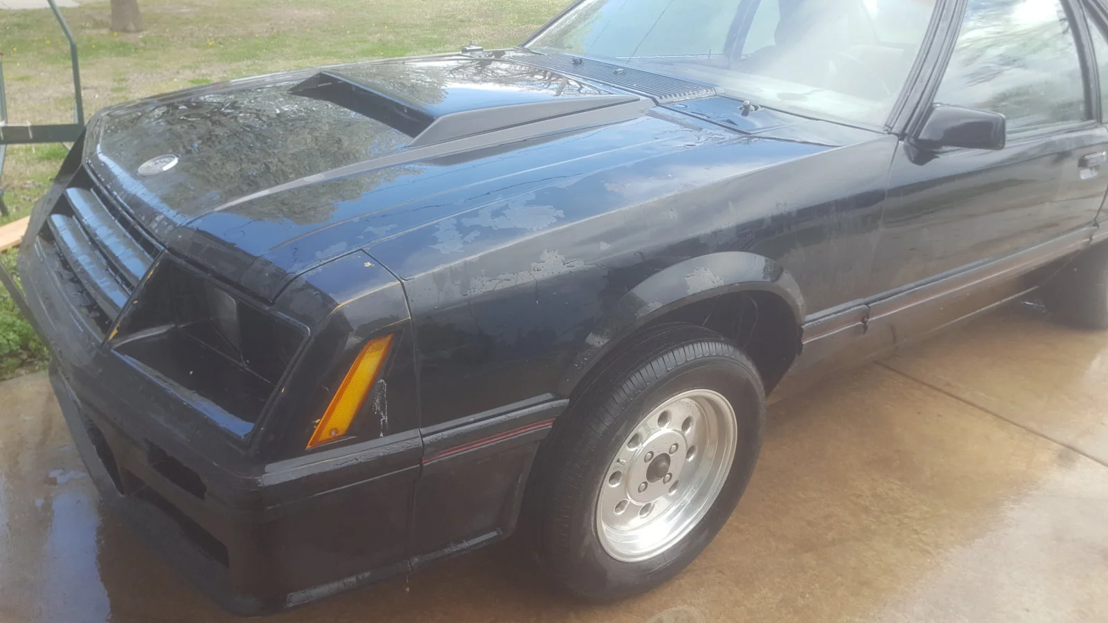

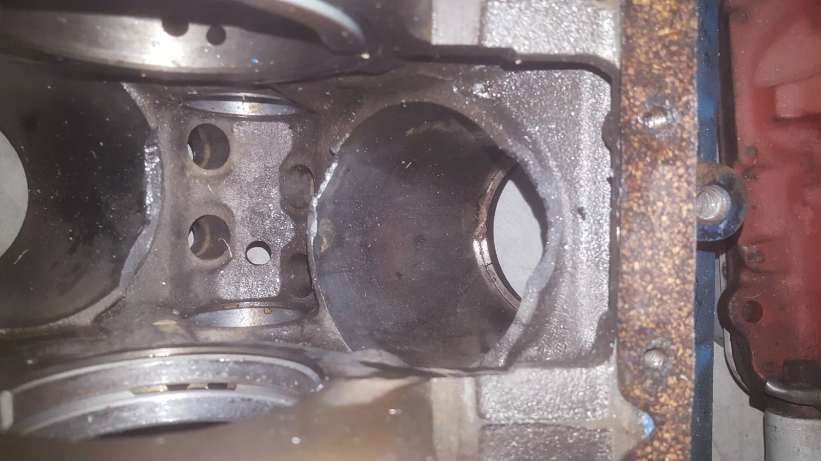

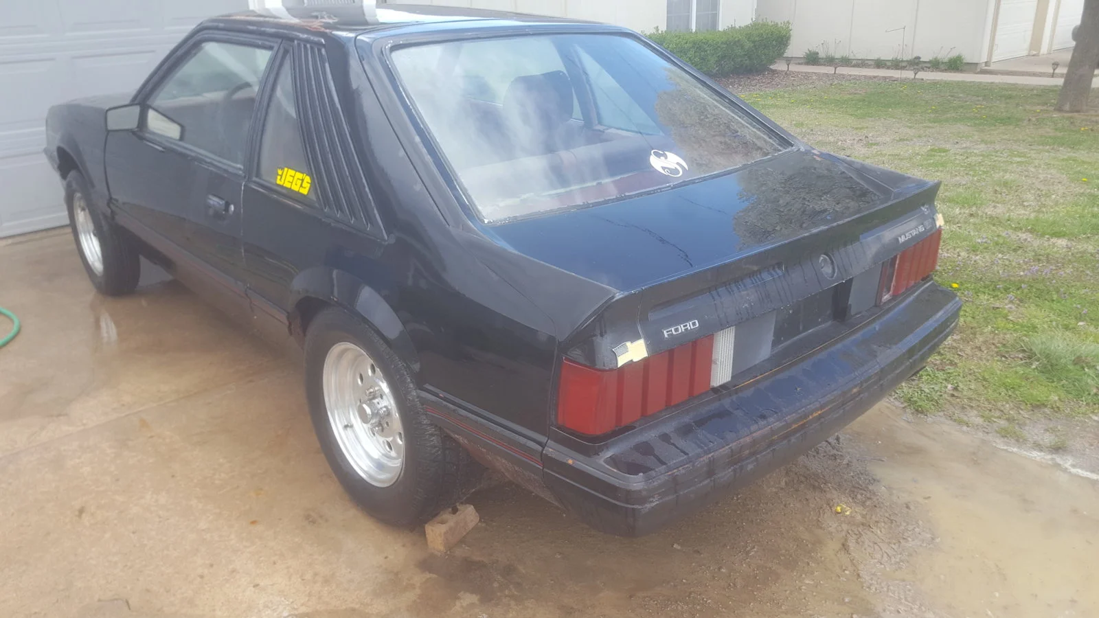

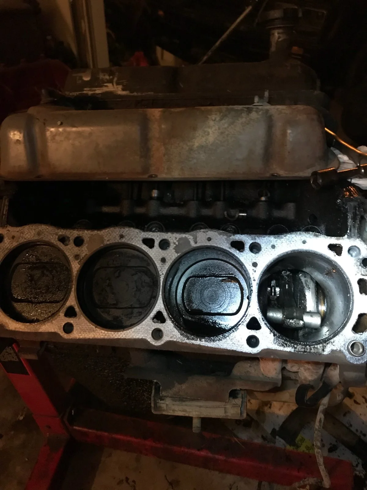

Ok herr is where I am at. Heads were wp windsor jrs which I sold. It had vic jr intake and msd distributor(change gear) with xe284h cam(get different) and a holley carb (can not find numbers). I picked up a 351 out of a f250 that I am currently starting to tear down to the short block and wodering how swapping these parts on stock heads would do.
Plan is to get running so I can drive the car cause pointless to have a car sit. I am on a budget hence the title. I plan on saving up and going 408 with aluminum heads but that will take time. I have a spare block sitting for that.

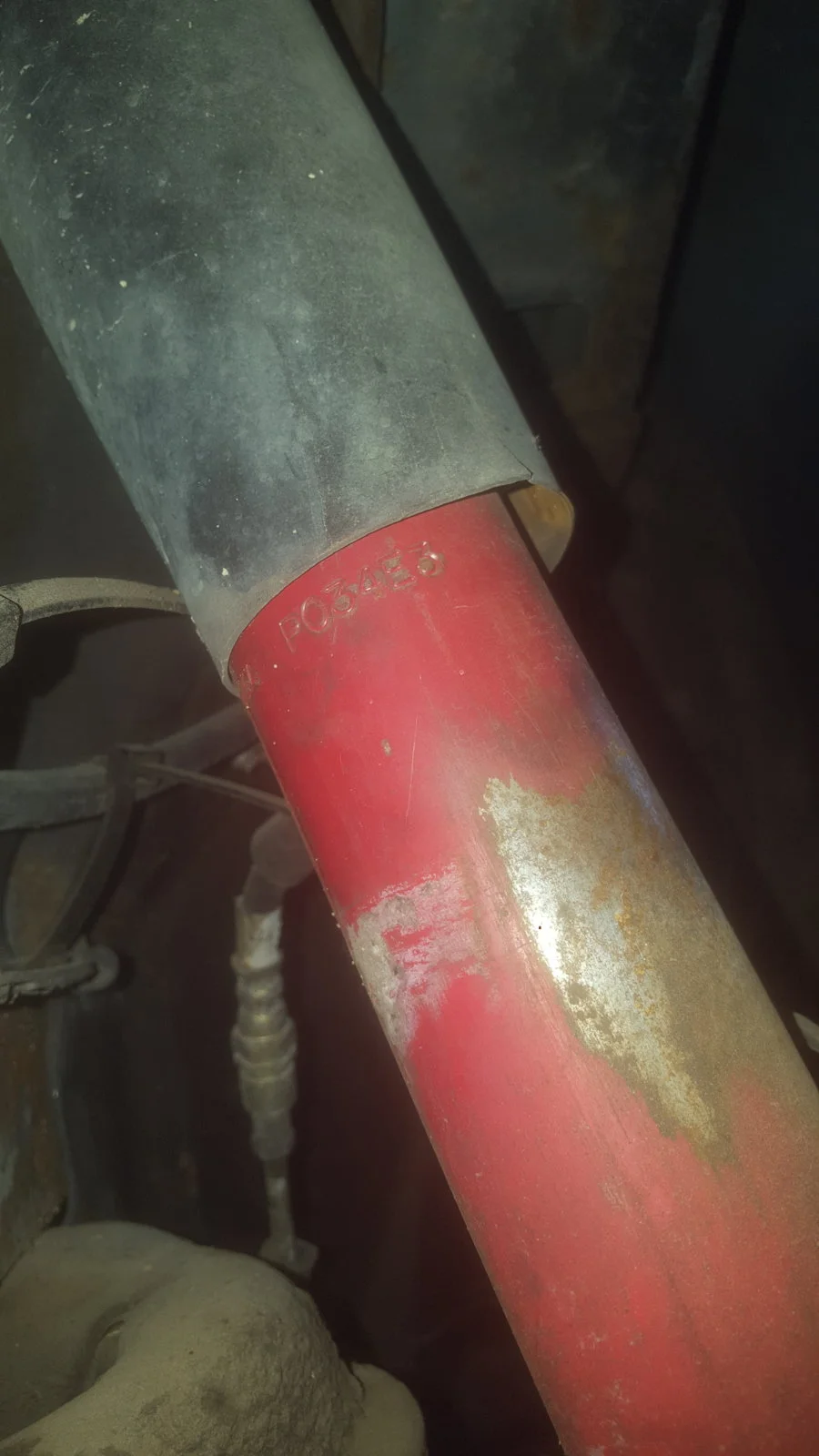

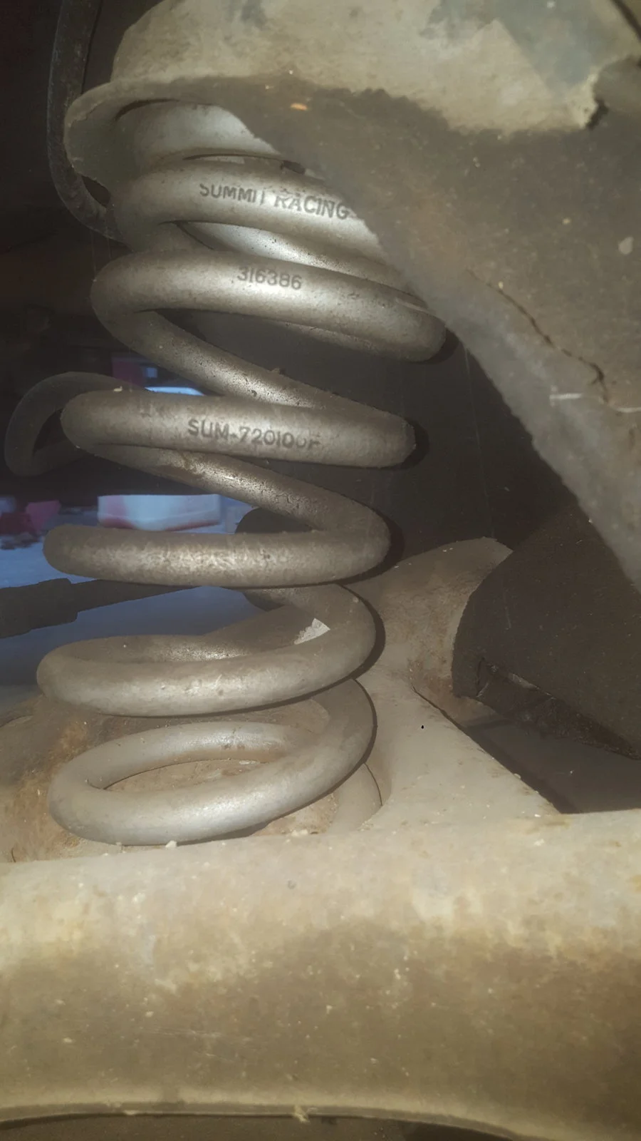

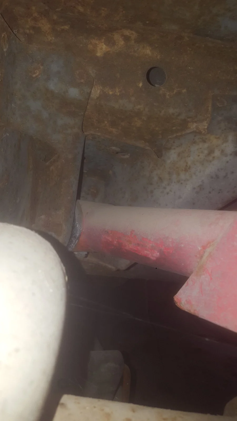

Thoughts and coments are appreciated. I have not got to mess with engines in cars for awhile and never messed with ford engine. I added pics of broken block and I will get casting numbers off of other block tonight. I can not figure out what shocks on front. There are strange adjustables on rear cant tell what control arms on rear and has summit lowering springs. Rear is 8.8 was told trac lok with 4.10 gears.
