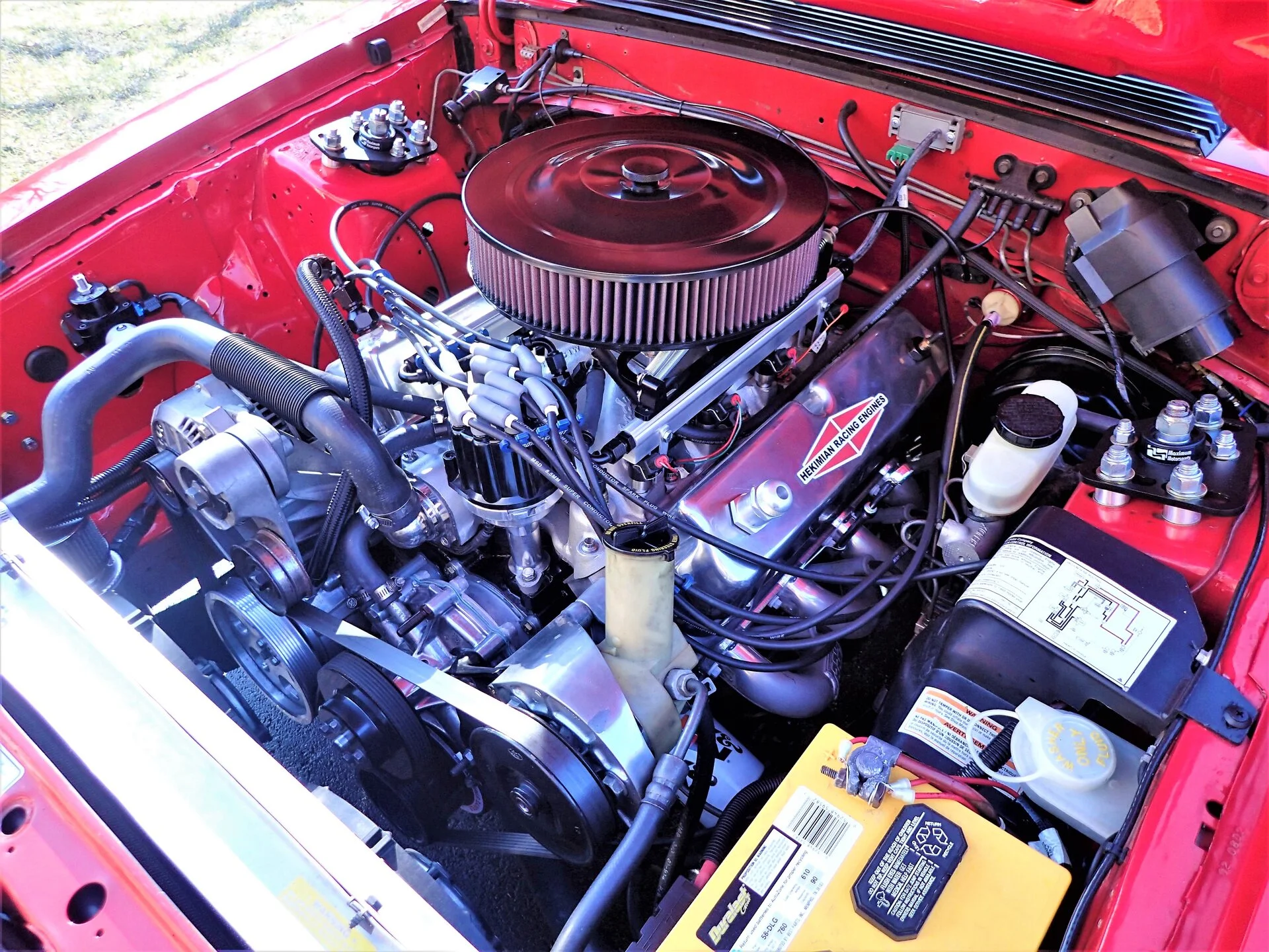

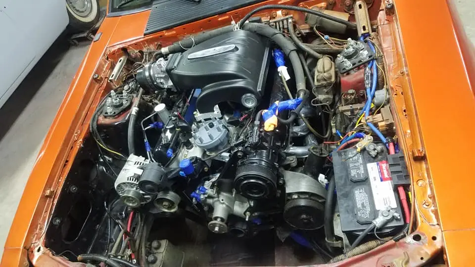

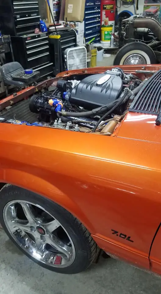

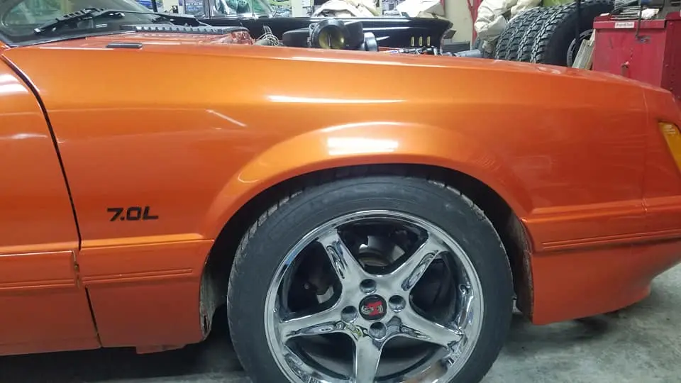

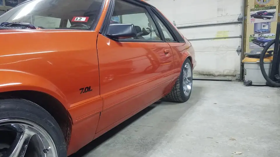

Just put my 351W in last week. Let me know if you need tips. I can share what worked for me. So far it is in the car but not started.

Very nice brotha . What cam and valve train you running? Hydrolic roller
Very nice brotha . What cam and valve train you running? Hydrolic roller cam?

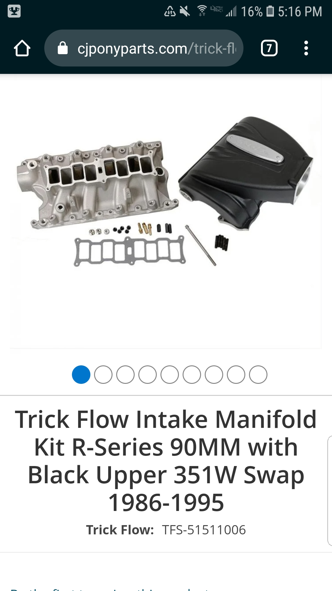

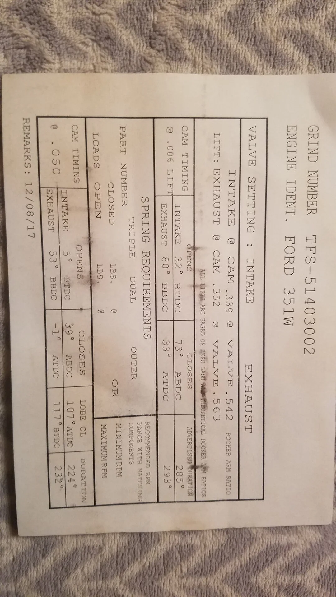

Pretty much trick flow all the way through. Stage two cam. Pistons are weisco, Scat crankshaft, 205 heads but professionally built at Creb Engineering, intake, plenum are trickflow with a cute little 90mm TB.

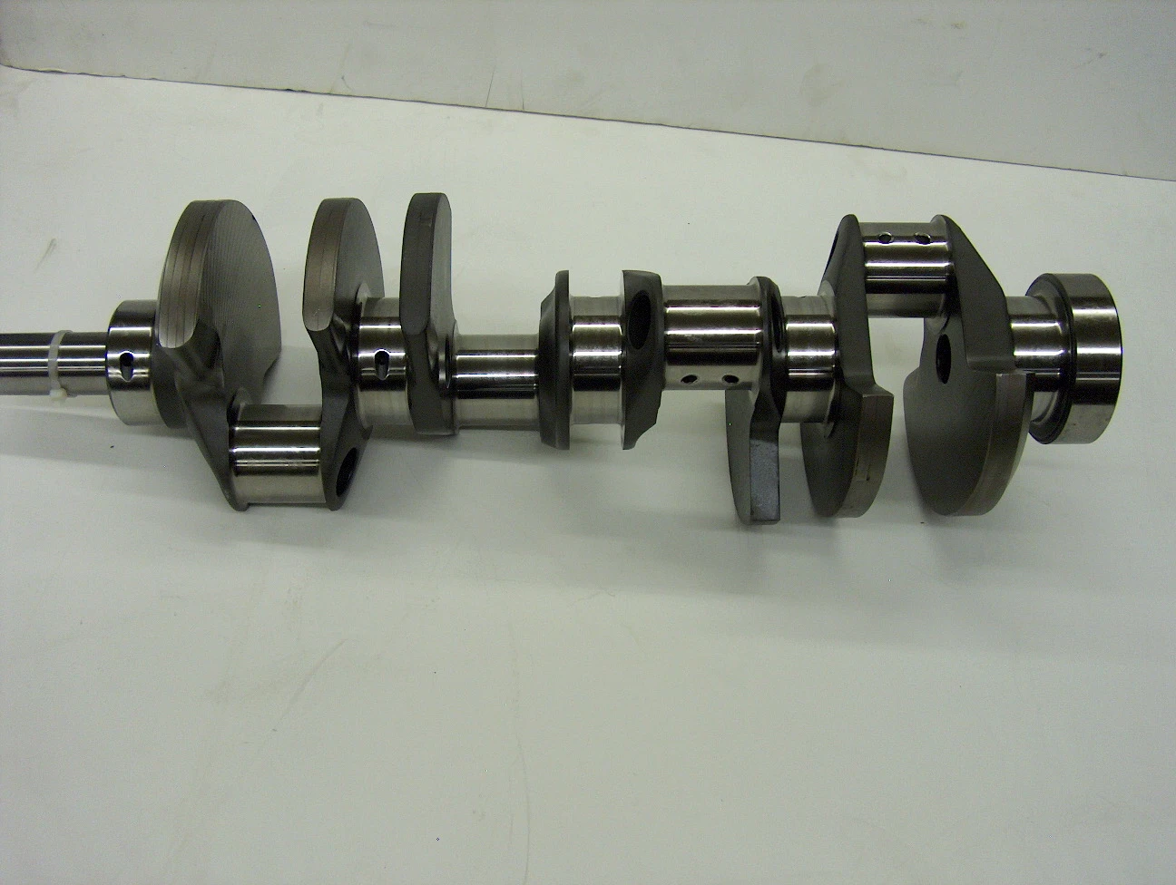

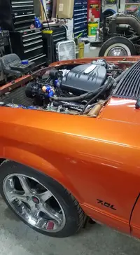

It's been a while...here's my 2 cents. I stroked the 351 to 427. I'm running a holley hp efi. It made 630 flywheel hp & 600 lb/fit torque. Solid cam, 7200 rpm shift points.
I went with a dart block
PA racing drop k member. Dropped the engine 1.5" (I did this to have more under hood clearance) I didn't want a 20" cowl hood. You will probably need this k member since you want to go with a carb.
I went with coil overs
I needed a longer steering shaft.
Offset steering rack bushings
Maximum motorsports caster camber plates
Intake Manifold
Sway bar brackets from a 95 mustang, needed to drop the sway bar
351 accessory brackets
Distributor
I think I used 302 long tubes, because I dropped the engine with k member. A 351 header would run too low.
Steeda bump steer kit
Cervini hood
Youre going to need a different throttle cable from older fox body.
Oil pan

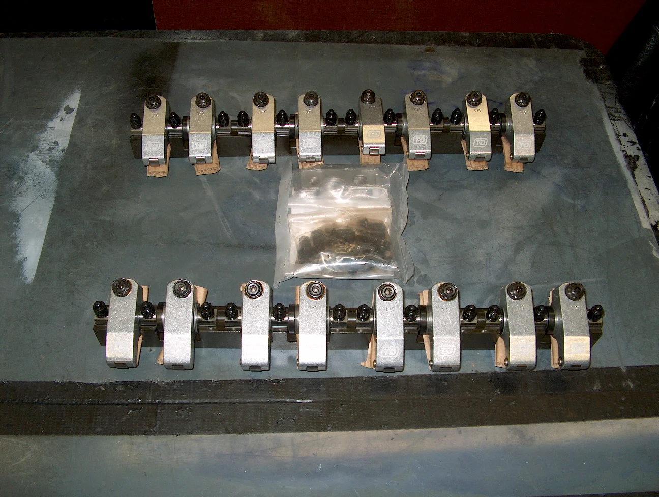

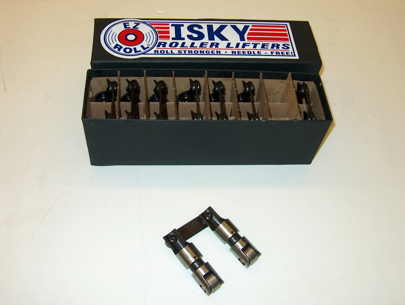

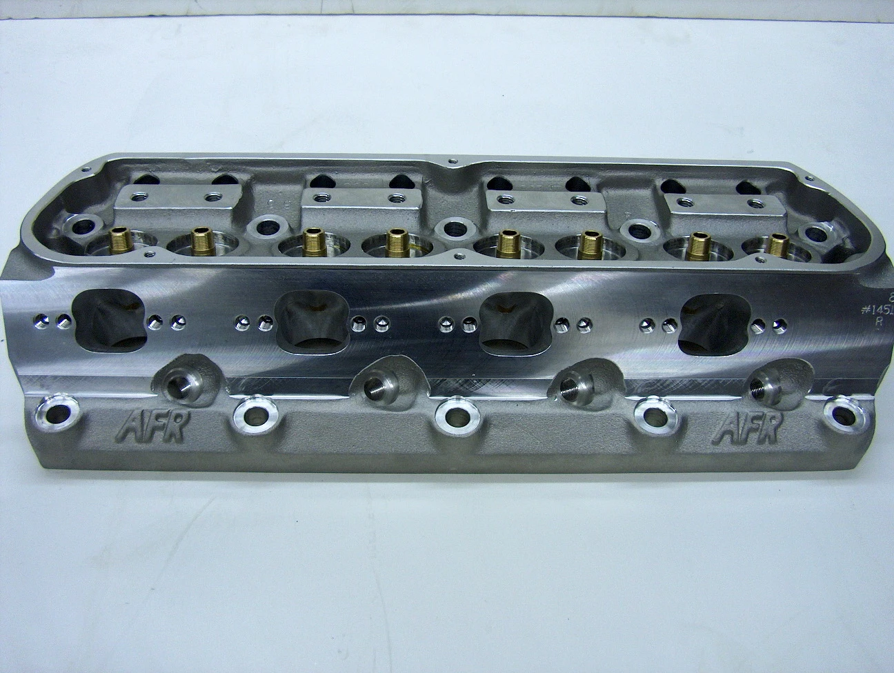

What brand and part number shaft rockers did you use? I've been looking for streetable shaft rockers. Beautiful build by the way!
Thanks! The rocker shafts are made by T&D. Mine are 1.7:1. They're not cheap. Nothing about this build was cheap....all top notch forged callies internals. I wanted all forged and machined in America. Here's the link for the rocker shafts. http://tdmach.com/product/small-block-ford-afr-205-220-225-aluminum-heads/. I used Isky solid Red-Zone EZ-Roll Roller Lifters as well....cost almost as much at the rocker shafts.
Here is some engine p-o-r-n
One more thing for the OP....If you use the PA drop k member, you can use the stock hood if you use the same style of intake like Driver460SZ....the passenger side pointing efi intakes. I went with a tall super victor efi intake utilizing a 4 barrel throttlebody. I needed all the clearance to fit a properly sized air filter and had to go with the larger cowl hood. If I were to do it again, I would sacrifice some top end power and use a stock style configuration to maintain the factory hood. My car has all original paint except for the fiberglass hood....it actually pains me to have that cowl hood.
Also- This particular combo started life out with a carb. It was misery with todays gas. Turn that engine off for a few minutes and your fuel will boil/evaporate off in the bowls....making a restart difficult. Under hard stops, it would stall. Misery.... I through in a Holley HP EFI throttlebody....universal kit....and it worked out much better than the carb...across the board.

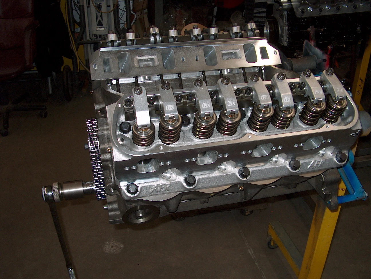

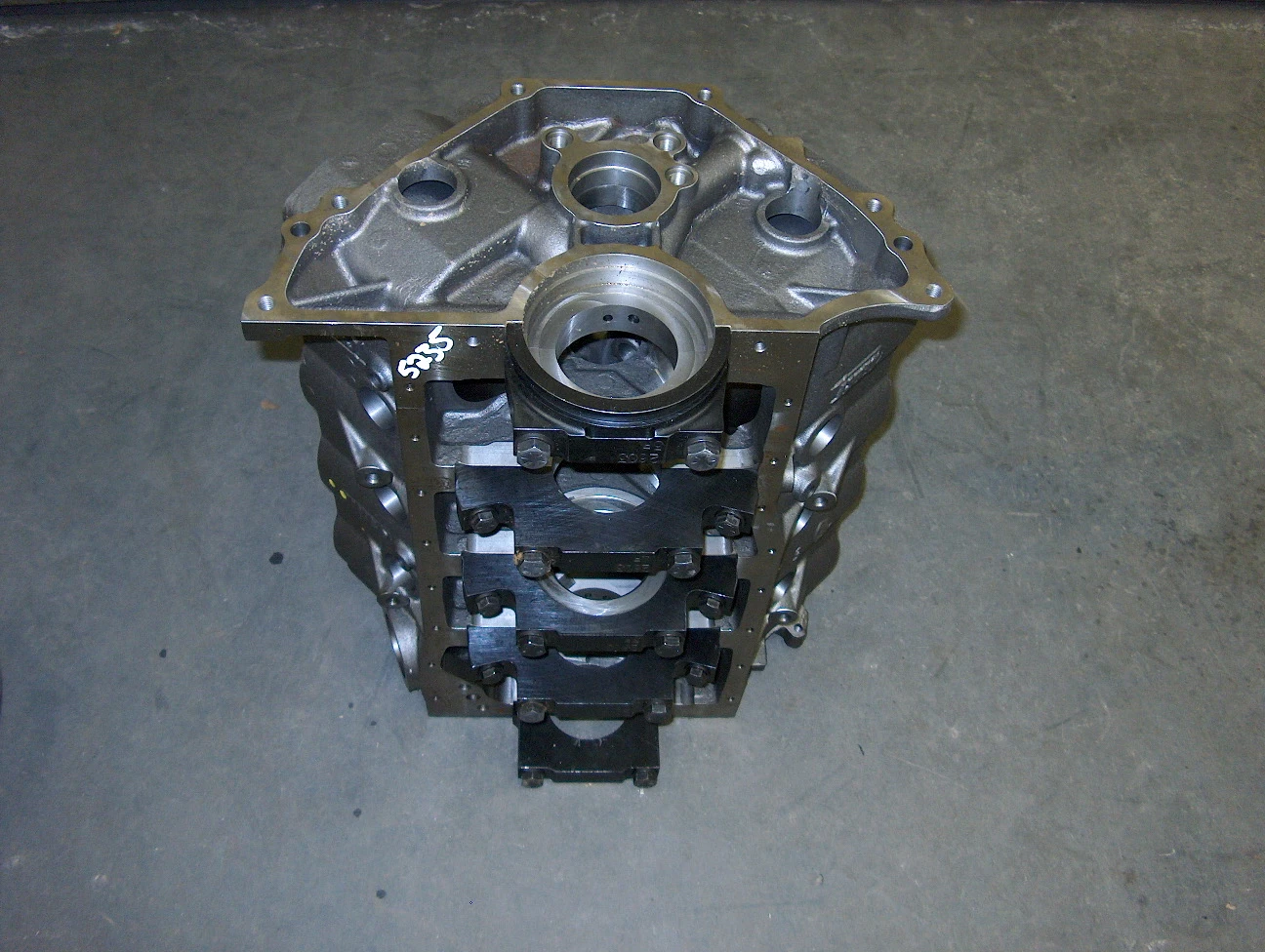

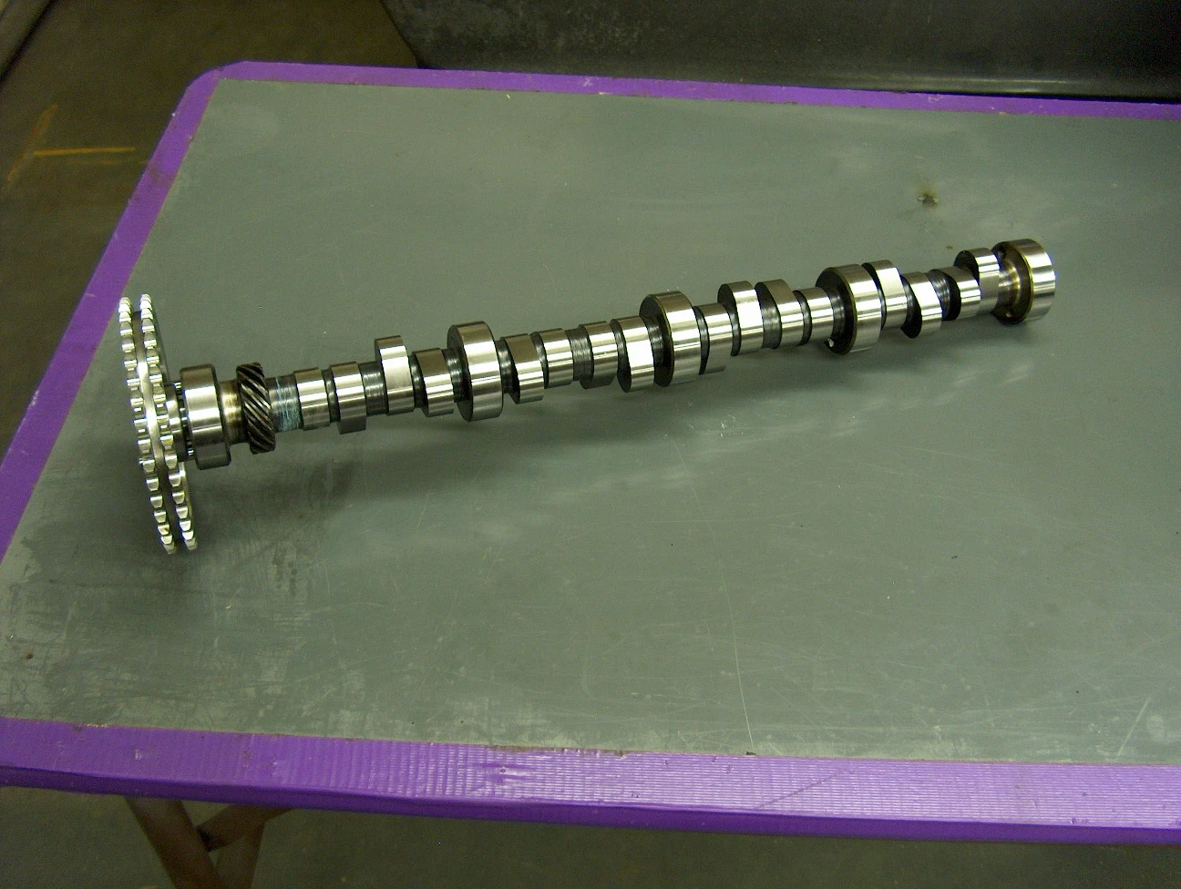

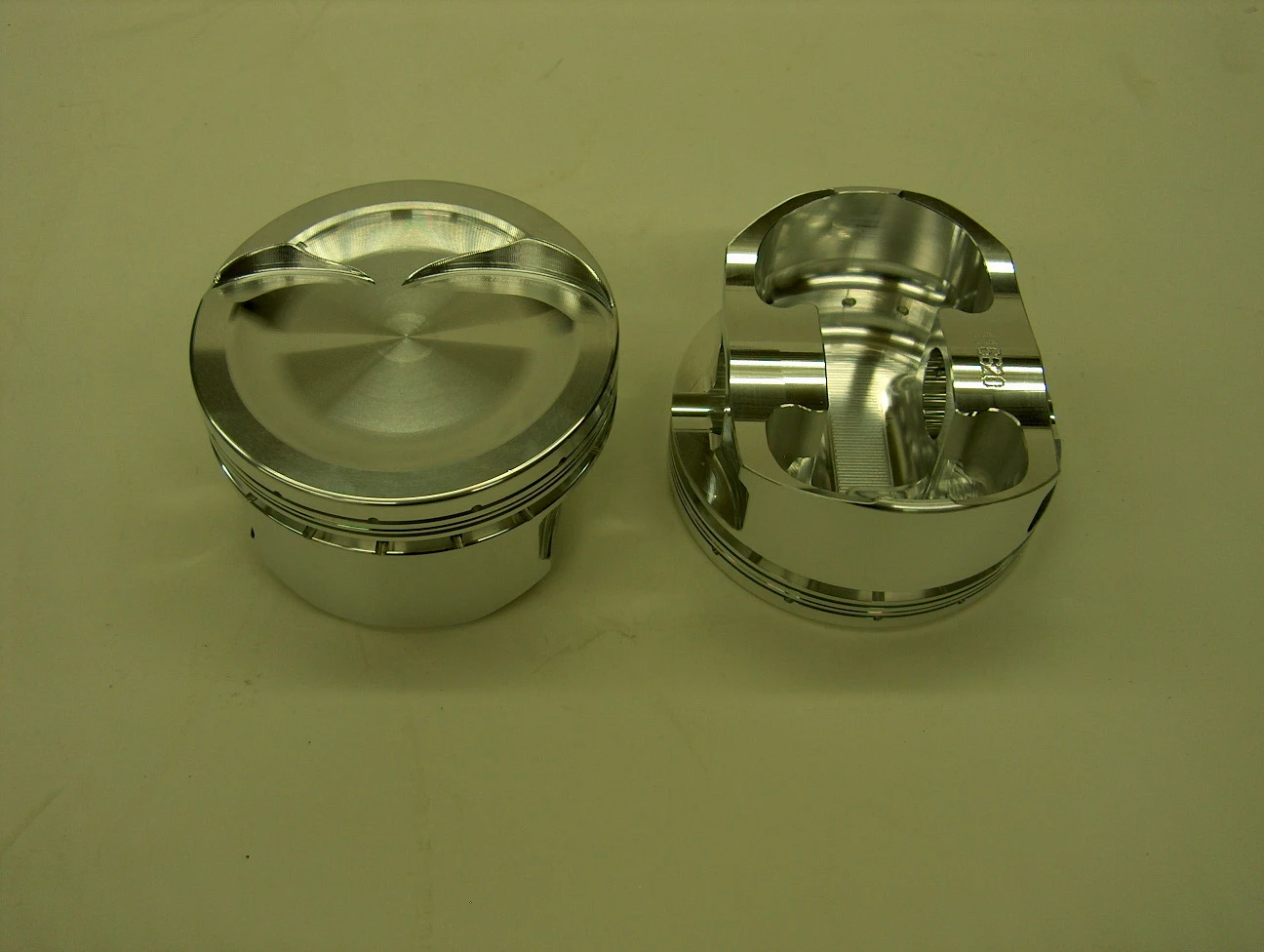

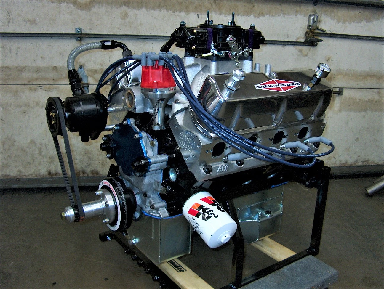

Found my list of things!!!
427ci Ford Small Block

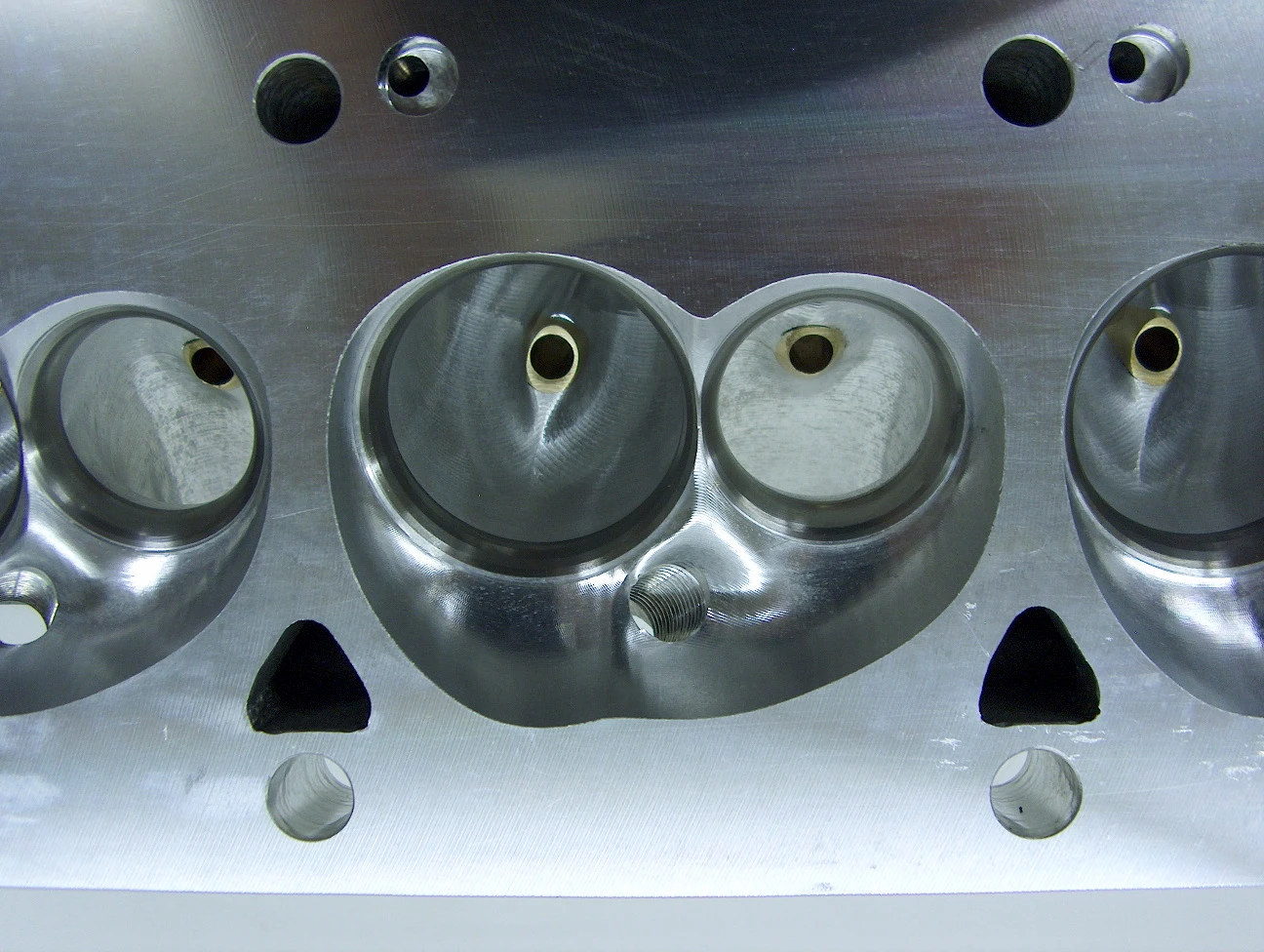

Cylinder Heads are 210cc Pro Comp Aluminum
60cc Chamber, 2.020 In valves (severe duty), 1.600 Ex valves (severe duty)7/16 rocker studs, 10 degree machine keepers, 10 chrome moly retainers, 1.460 dia valve springs.

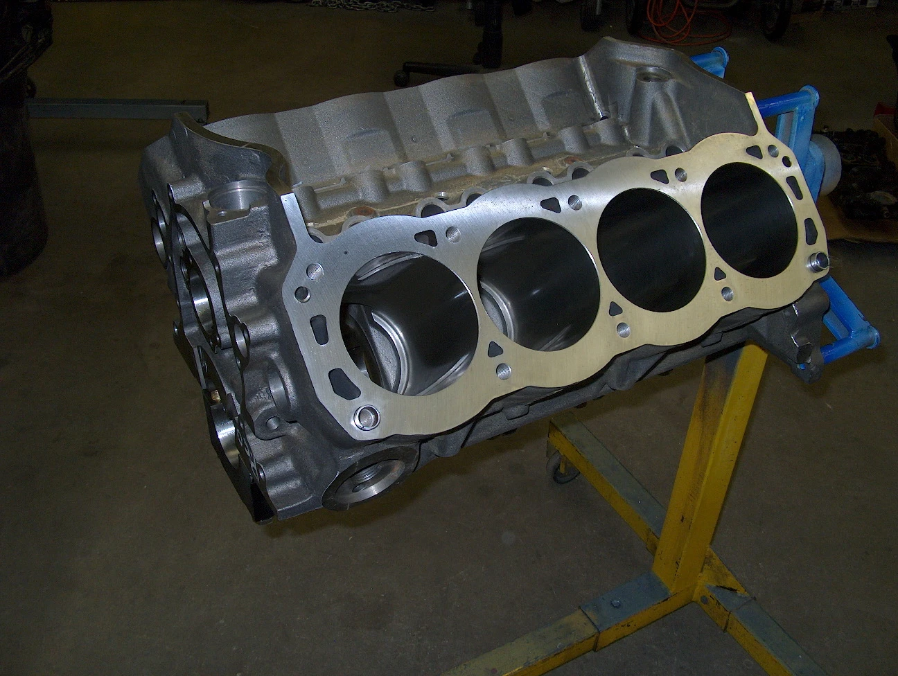

351w Ford Engine Block - A Ford Roller Block Was Used.
Block was square decked
Block was line honed
Block was square bored and honed with honing plates
Engine was trial assembled twice
Lifter bores are honed
427ci Ford Parts List Break Down
Forged Wiseco pistons .040, File Fit rings .040 over, Clev H series std bearings, 4340 steel 4.170 stroke crank 28oz, SIR 4340 rods 6.200infloated, ARP Main Bolts, Felpro Rear main seal, Brass freeze plugs, Durbond Cam bearings, Trickflow Hyd. Roller lifters, Double roller Timing set, Mellings oil pump pickup, Mellings Oil Pump, ARP head bolts, A complete gasket set, Oil and Filter 15-40w, A Foxbody conversion rear sump oil Pan, Stage 2 trickflow roller cam, Harmonic balancer 4 bolt, A set of 1PC Pushrods, A Aluminum Timing Cover, Trickflow 1.6 roller rockers

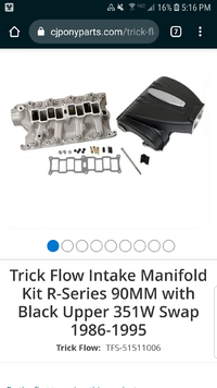

Intake Trickflow TFS-51511006 Upper and lower 90mm with 3/8 spacer.
