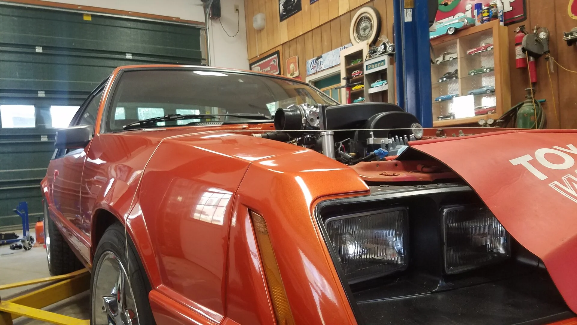

hay 460 you said stock hood fit but your list states 3 inch cowl hood? What gives?
