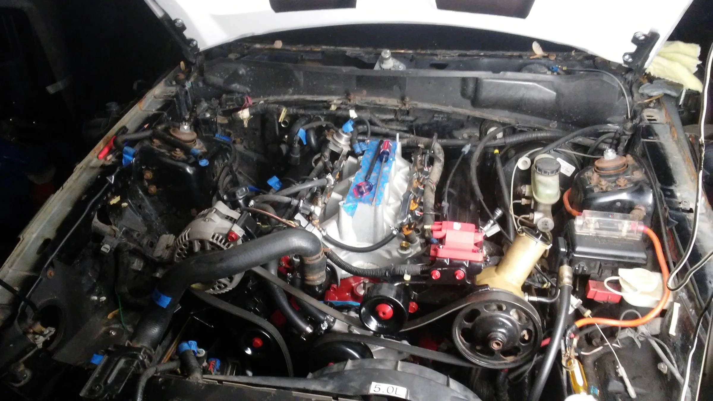

Give us an idea of what you have, stock cam (flat tappet), intake, throadel body, stick or auto, also a pic of the engine/compartment.

It is a stock (marine) block and heads. I have an edelbrock performer rpm 2 intake on it. With a comp cams exteme energy 35-246-3 XE274H flat tappet camshaft. BBK shorty 351 swap headers, and a CAI. Everything else on the vehicle is from the stock 302
The car is a 5 speed transmission. I have it timed at 12 degrees.

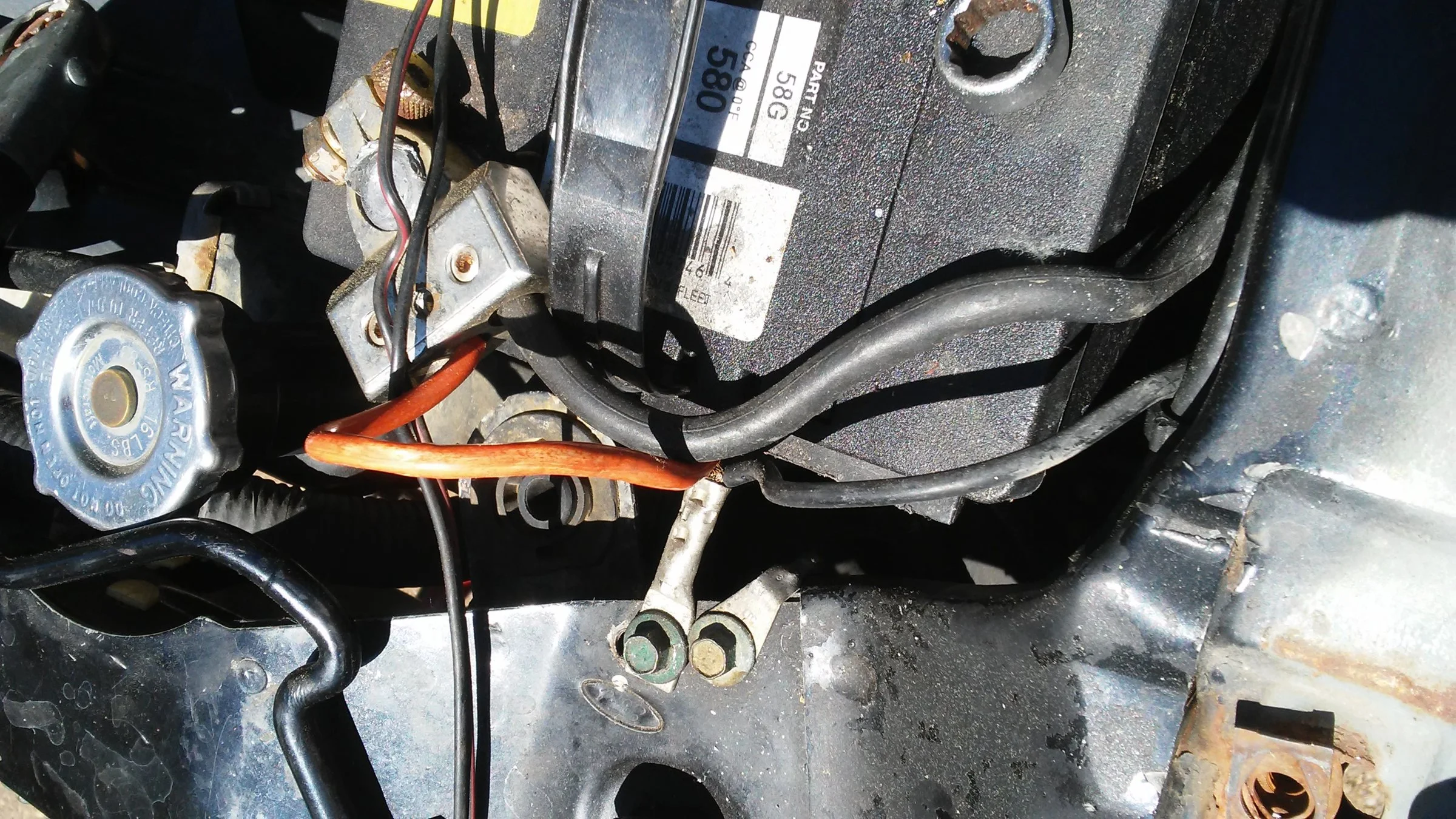

On the subject grounds, there are several that are important to the computer and related stuff reading correctly. The battery ground to the block, there is a small wire that gos from the battery neg to a small bolt between the battery and the solenoid, that same bolt will have another small wire that gos down to a cylindrical connector then into the harness below.
One from the back of the head on the drivers side to the firewall and another on the passenger side on top of the intake, it comes out of the injector harness and bolts to the intake or back of the block, also one by the computer in the passenger kick panel. Very important that these grounds at there and have good contact.

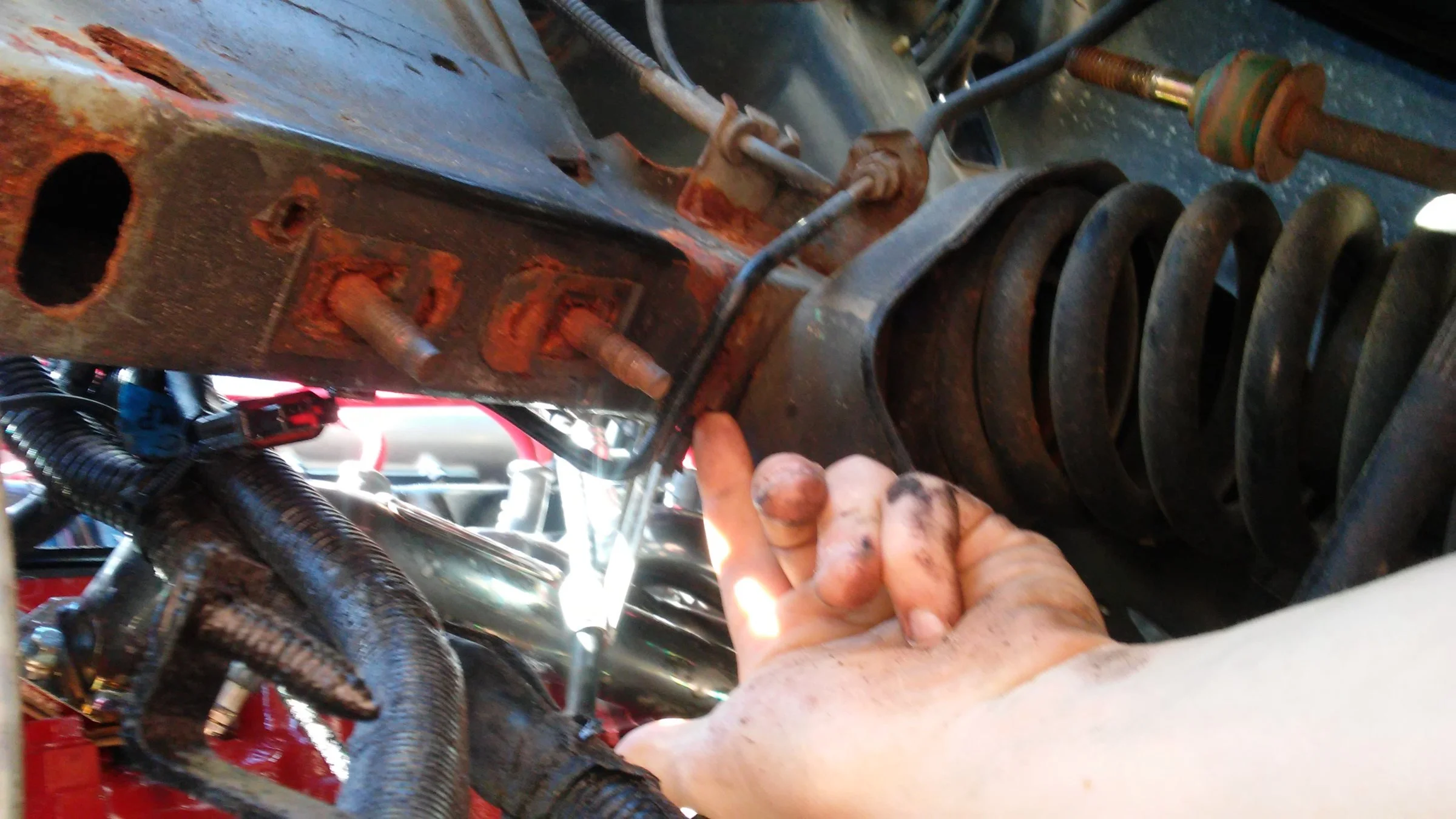

All of the grounds near the battery look in order. I will attach photo. By solenoid do you mean the starter solenoid? The ground that runs from block to firewall (drivers side) is non exsistant and i cannot find any ground coming out of injector harness on the passenger side.. And i will attach a photo of a wire terminal on the bottom of the drivers frame rail. There is no broke wire near the terminal..
Look for a ground wire at the ccrm, I believe it will be on the passenger side between the shock tower and radiator support, that should be the one for the injector harness, put a ground wire from drivers side head to firewall as well.

My ccrm is mounted on a bracket between the radiator and the engine. I do not see any ground wires running off of it. I will run the ground from cyl. head to firewall.
