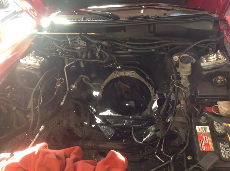

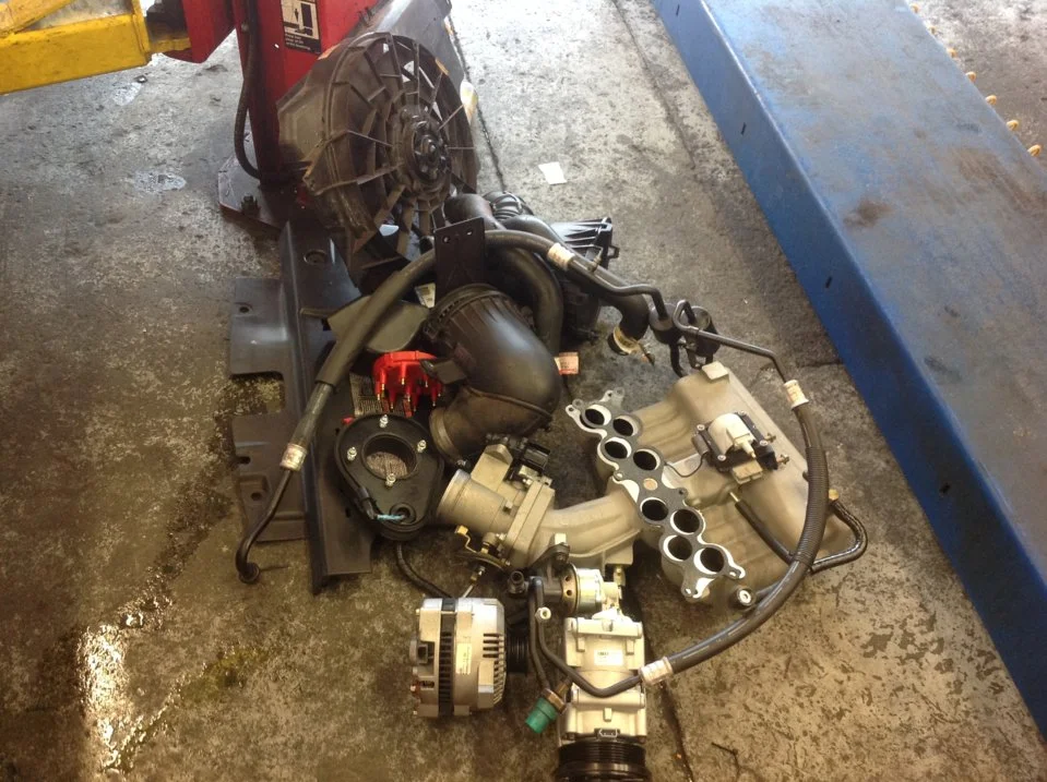

The car originally had a Cobra long block. I basically removed the 302, inserted a 351, and put all the same equipment (some parts new, some used, some fabed) back on top with 24lbs injectors. I used a 351w from the same model year or newer. One can go newer, but not older.

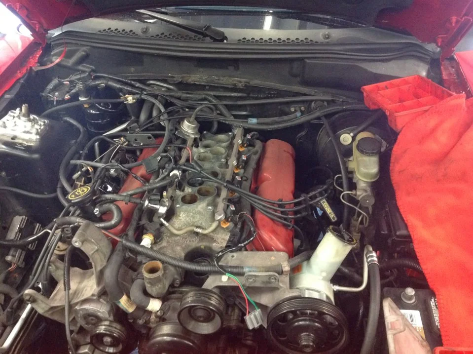

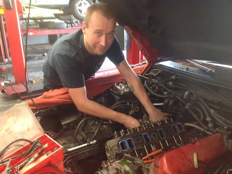

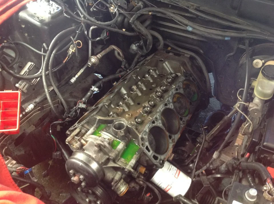

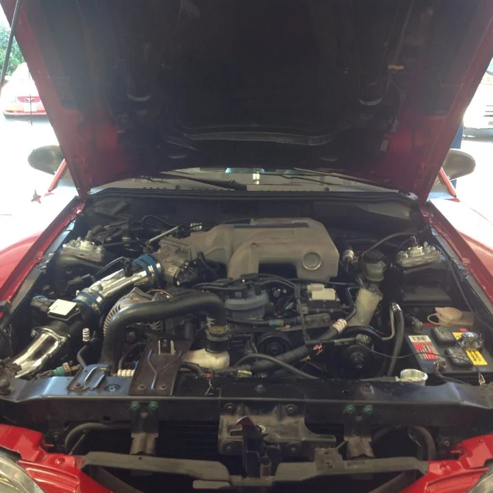

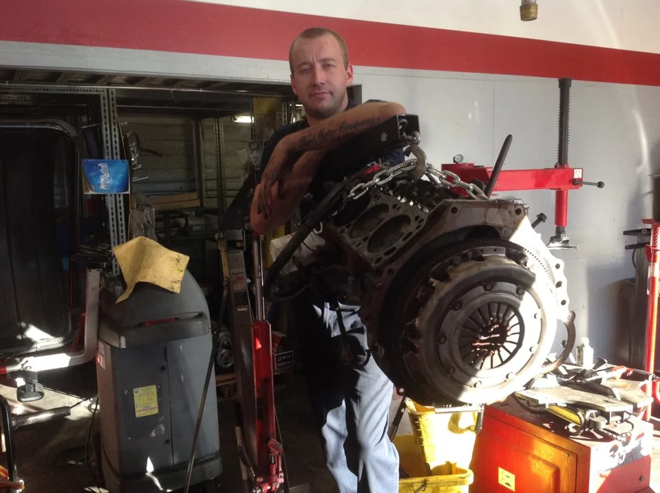

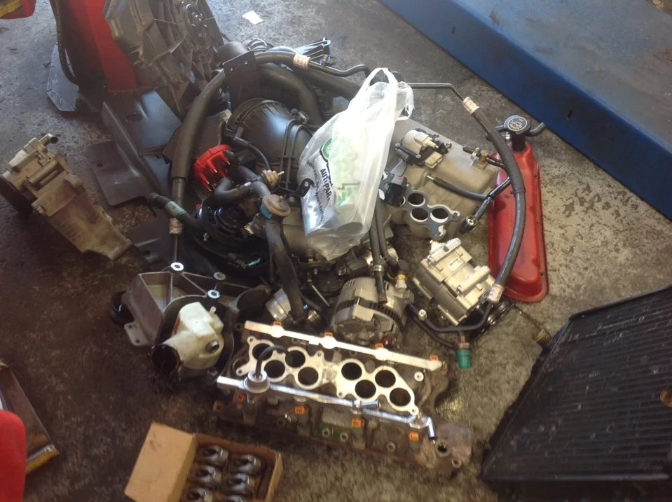

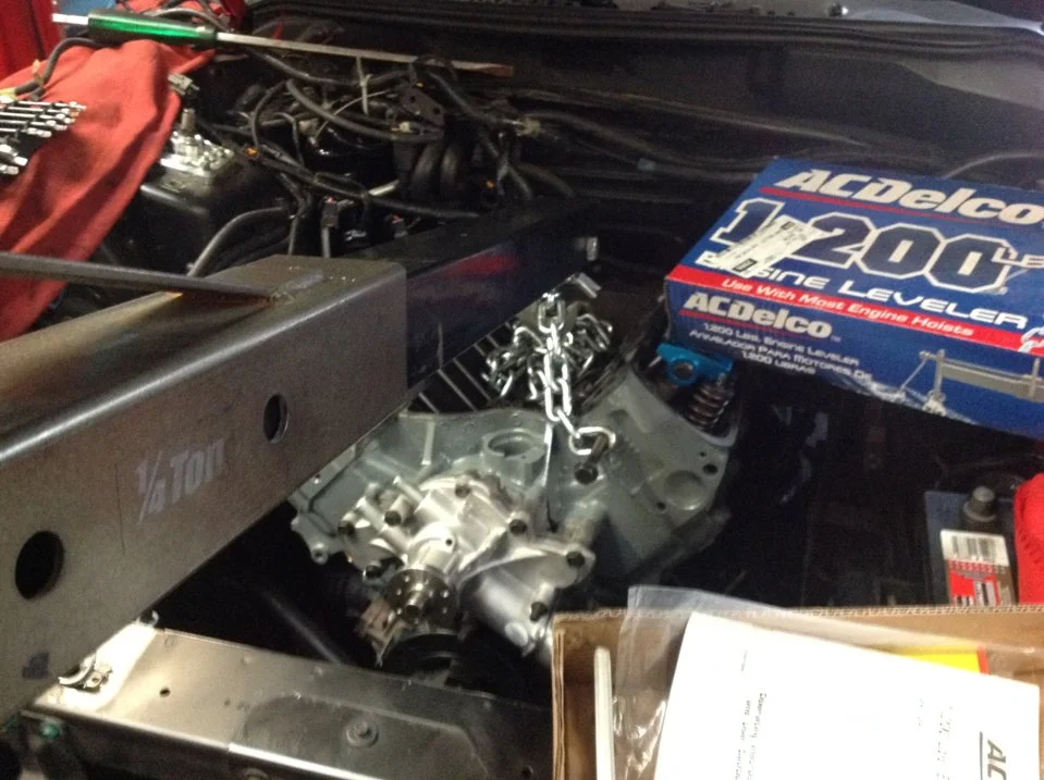

"Big Red" is back together and running. We just did the 1st 50 mile oil change. We are now working on the 500 mile oil change/clutch break-in, and tweaking small issues that always pop up. Below are some pics. Many more will be posted as soon as we get it 100% and cleaned up!

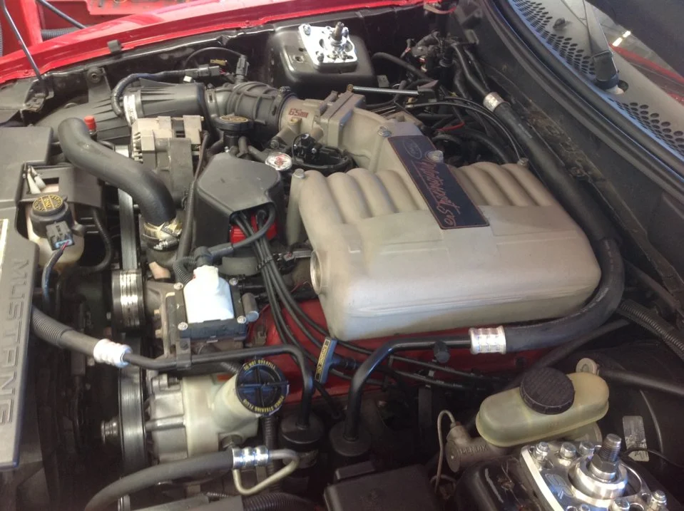

The 20 year old 5.0 (still in decent shape)
And the new 351w!:
More to come...

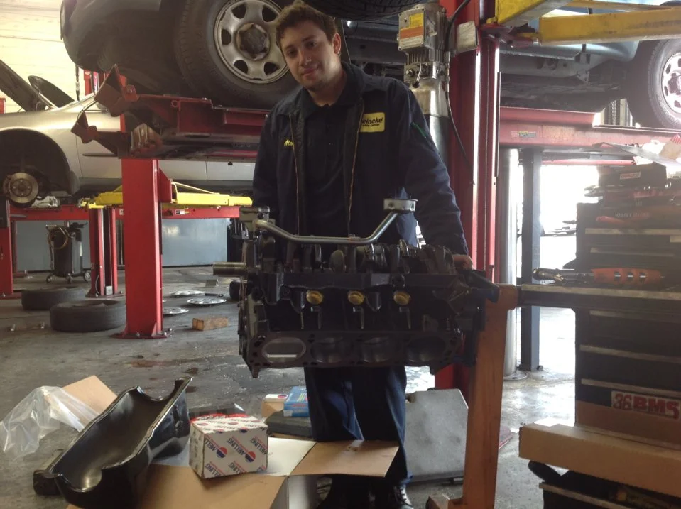

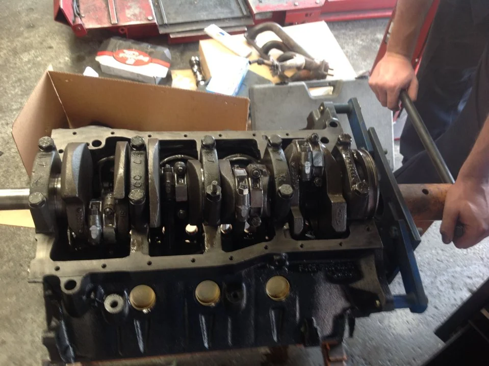

Alex poses with the HARD TO FIND 351 swap oil pump. There is only one oil pump that will clear the crank and fit under the swap pan at the same time. No, its not a 302 pump, no its not any old 351 pump HV or otherwise, and no Late Model Restoration does not sell the pump even though they advertise a 351w swap pump. Their pump [will not] fit. The only pump that will fit is a S.V. oil pump from a 1991 Crown Vic w/a 351w since that's what the 351w swap pan actually is -a '91 Crown Vic.

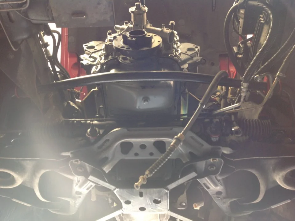

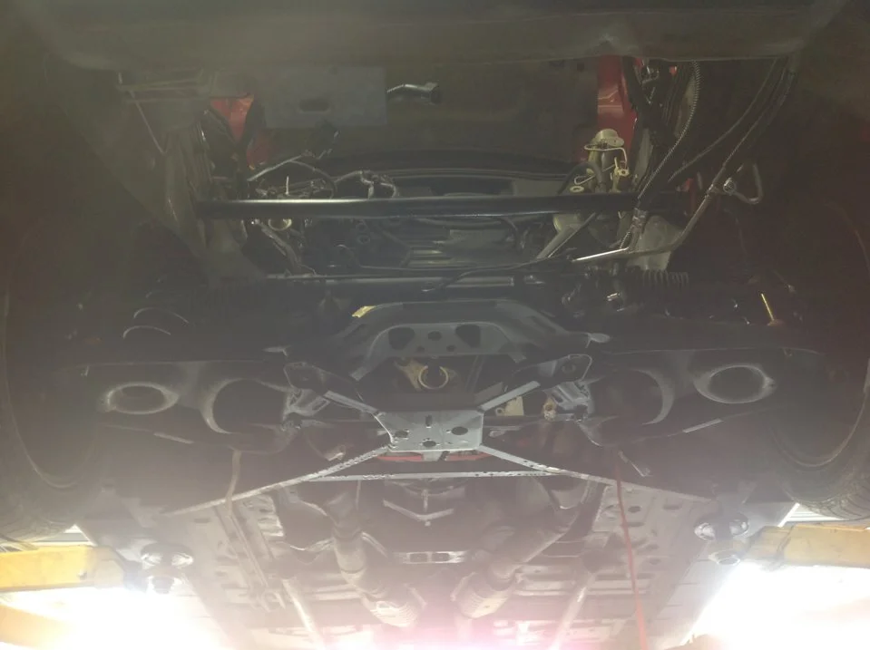

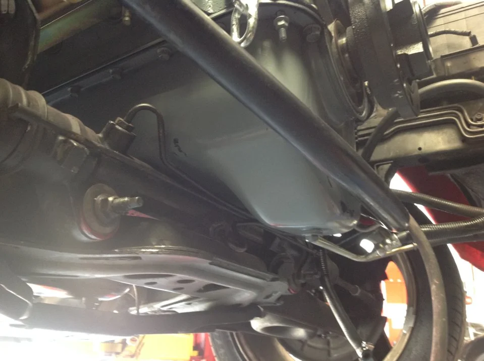

Bottom side of the car. On a Vert the K-Member XBrace can stay, but the lateral bar on the rear of the brace will require removal to accomodate the oil pan (with drop mounts or convertible mounts, we used Energy Susp vert mounts). Also, you will need offset steering rack bushing to push the rack down, and spacers (washers) to push the sway bar down so it doesn't rub into the oil pan.

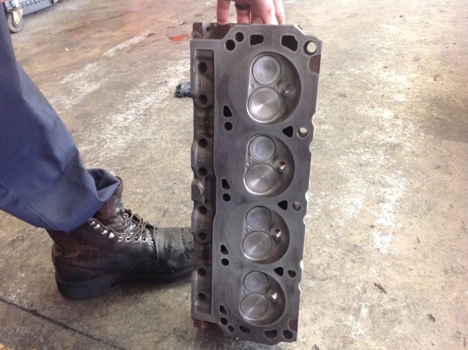

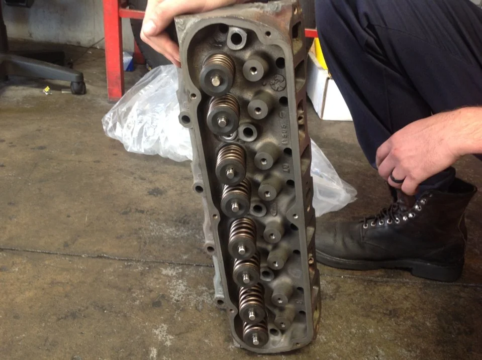

A set of genuine 1995 Cobra heads (GT40). We had them cleaned, refurbished from top to bottom, Ecam springs installed, and 3 angle valve job peformed. Again, the goal is streetability, reliability, smog legal, and budget friendlyness.

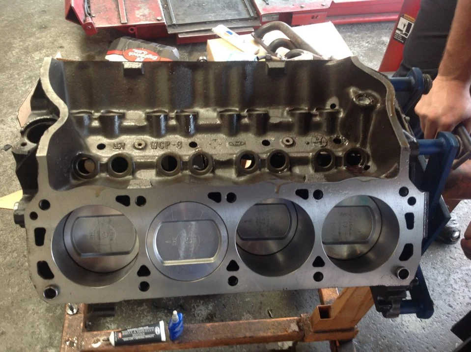

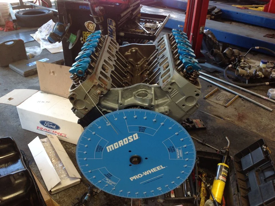

Degreeing the camshaft (a must). Don't worry eagle eyes, the heads got turned around. Also, the rocker arms pictured (Pro form 1.6), got swapped out for some Scorpian 1.6 Endurance rockers.

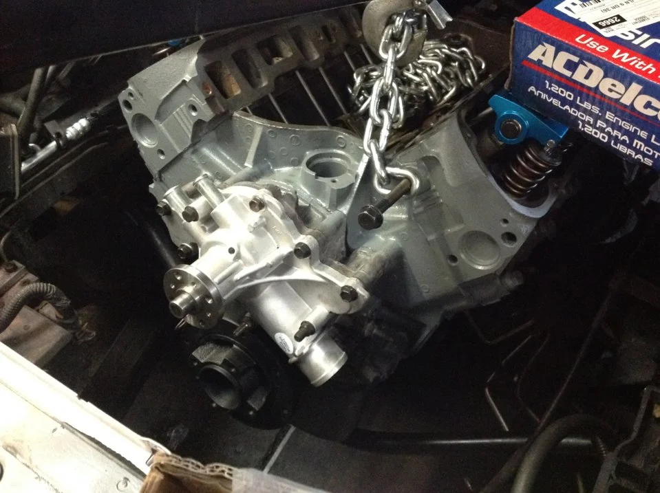

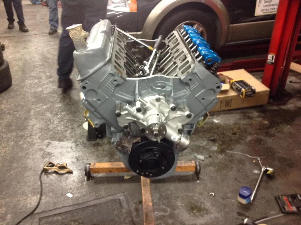

302 Motorcraft water pump & stock 351 balancer (no spacer needed in 94-95s)...yes, the heads were reversed prior to startup.

Plopping it back in the car. If you do not remove the front bumbper you will need an extension for the picker.

Underside...

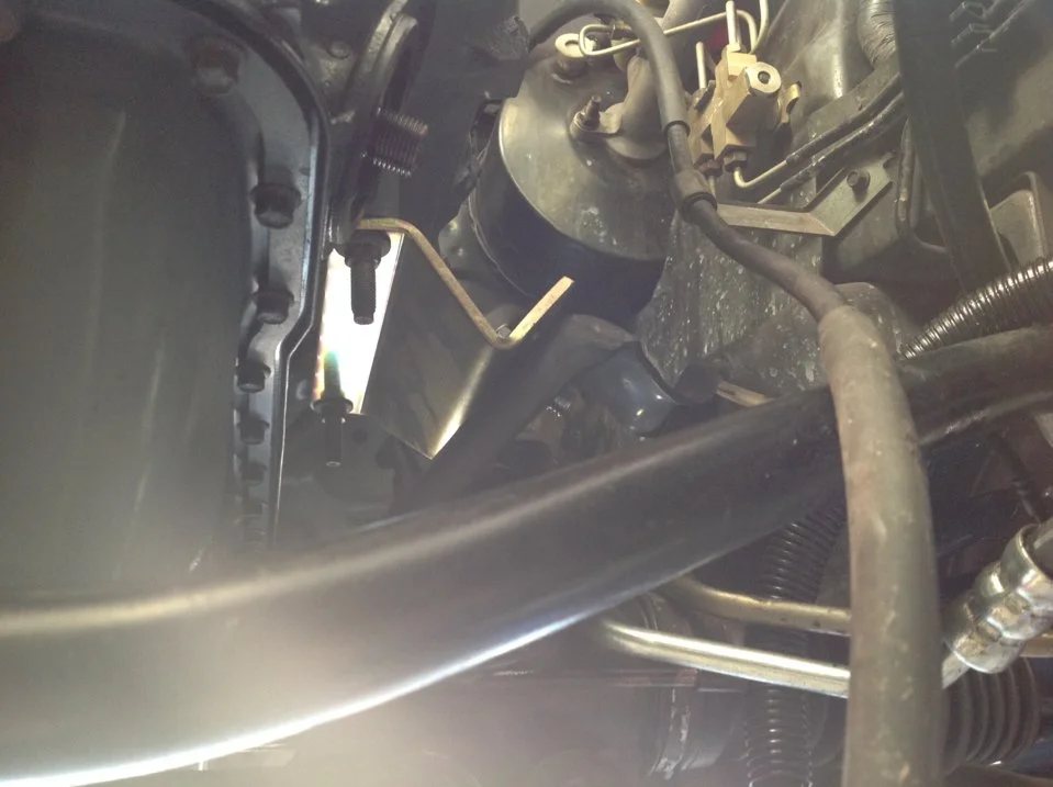

Oil pan to steering rack fitment: again, offset rack bushings were used. The sway bar is too close here and will rub. We did not yet have the spacers in place.
Solid drop mounts. We later switched them out for Energy Suspension (ES) mounts. The ES mounts supply a much better driving experience (IMO). Both styles of mounts allowed the motor to fit under my 96 Cobra hood. However, the Urethane mounts which are styled after the coupe mounts are too tall for my style hood.

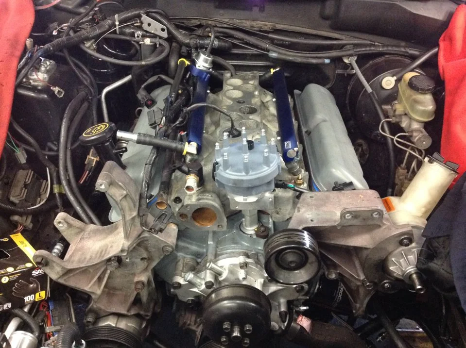

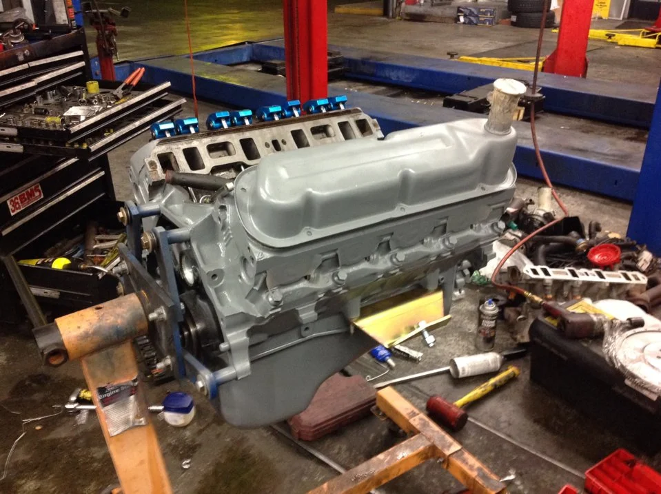

Coming together. One advantage the 94-95s have is that the accessory brackets can bolt right back and a stock 351 balancer with no spacer can be used. Everything aligns perfectly. The fuel rails are BBK rails. They are a horrible design, they came with missing parts, and not all the bolt holes were threaded. They also leaked and required clamps. Also, the front passenger side rail mounting tab will require some grinding down if you wish to use the heater core line as we did. The tab is too fat and pushes the injector out so that it intersects the heater line -and that also causes leaks. Avoid them unless you like trouble. Nonetheless, after some effort, we got them to comply. Lastly, a Richmond distributor from a 351 F250 was used. The Richmond unit has 100% new electronics (incl PIP). You will need to switch out the gear for a stainless steel gear...

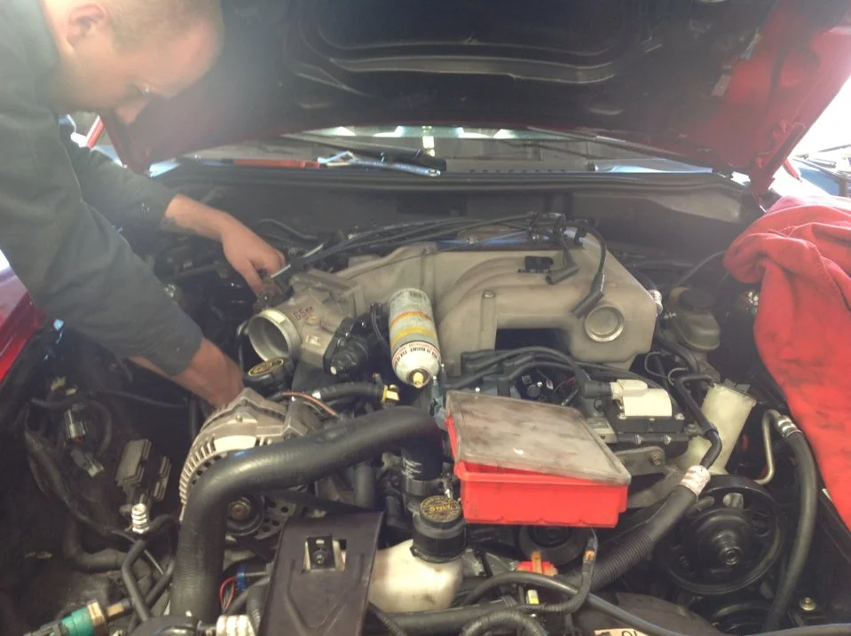

Upper & EGR tub: The tube will need lengthening just as the air tube will in the rear of the heads. We used FRPP 302 headers for less headaches and ease of fitment. They are long enough to fit with the ES vert mounts installed. However, because of the motor's width, you will need to cut, bend, and weld your mid pipe to make it wider. The usage of FRPP 302 headers not only physically fit, they also fit our budget mindset, and allowed us to retain the EGR tube for state inspection.
Before start up...
