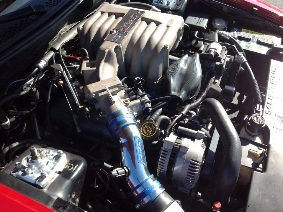

After kinks worked out and 300 miles on the clock...
If this looks like a stock 302 save the CAI then we achieved our goal. After driving this thing for awhile we also installed a set of DynoMax 14" Super Turbo mufflers in place of the FlowMaster 44s. The Flows were too loud with the 351 & Ecam. Setting off people's alarms on the way to work in the morning is not the kind of attention I desire. With a Magnaflow H-Pipe,DynoMax mufflers, 351, and Ecam the car has a nice muscular/refined sound.
Parts list is on the way. Any questions, comments, crys of shock, or outrage?

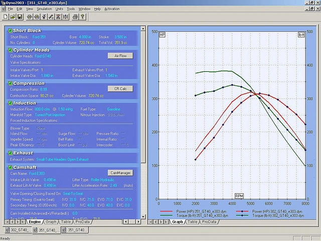

Yo, have you got any dyno numbers on this, very curious of what numbers you pulled off this DD!!

So I found this, just moved it down on the powerband but the Torque was higher, Gt40 trademark lol
.... this is Ecam with Gt40 heads with a 302 v.s. 351
Given my dyno rwhp/rwtq numbers with my Ecam - 302, this is pretty good read of what iron heads and ecam slapped onto a 351 would do. We all know lots were left on the table doing this, but just to see a dyno graph puts it into better perspective.
Even in a heavier vert the torque was MUCH better. And no, a 347 is not the same.
