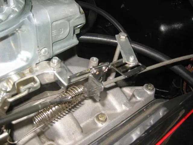

I am installing a BG Speed Demon carb on a Weiand Stealth using the stock throttle cable. I need to fab a linkage bracket to support the throttle cable on the intake. Anyone got a pic handy of their setup similar to this on a 69? Any linkage recommendations are accepted!!

Here's what I did. I've had two different brackets and both of them only use one mounting point. With only one mounting point it gets pulled forward and doesn’t allow full throttle unless I really over tighten the carb nut that it mounts to. There are nice throttle brackets that use two mounting points but are $60+. I rigged up a little piece, doesn’t look good but works. Thats a 750 demon with a torker II intake.

I take it the stock 4V bracket doesn't work? They're availbale in repop, so if it fits, it would be the easiest solution.
you have to modify them to work with a demon carb because of the pcv port in the back
