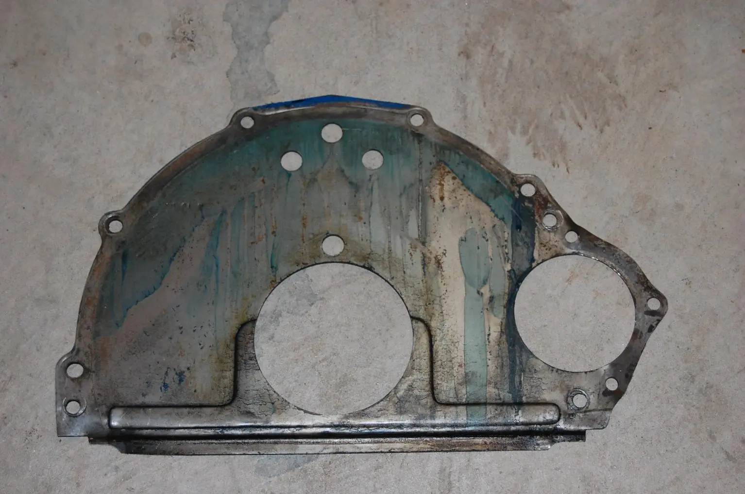

I recently purchased a 390 big block and it came with the block spacer and flywheel for an auto transmission. I have a 4 speed manual but I am not sure if the block spacer is the same for the automatic as the manual? I have seen pictures on-line with the description noting it both ways?
Thanks in advance for your help!!
Following is a pic of the plate. It also has a code of 4 10 D 3
Thank you for all of the help!

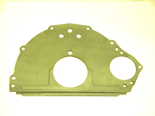

There are actually a couple of different plates. The difference is in the access holes above the crank. They are interchangeable, though. They fit either auto or manual bellhousing the same, and align correctly with both the auto and manual inspection covers.
