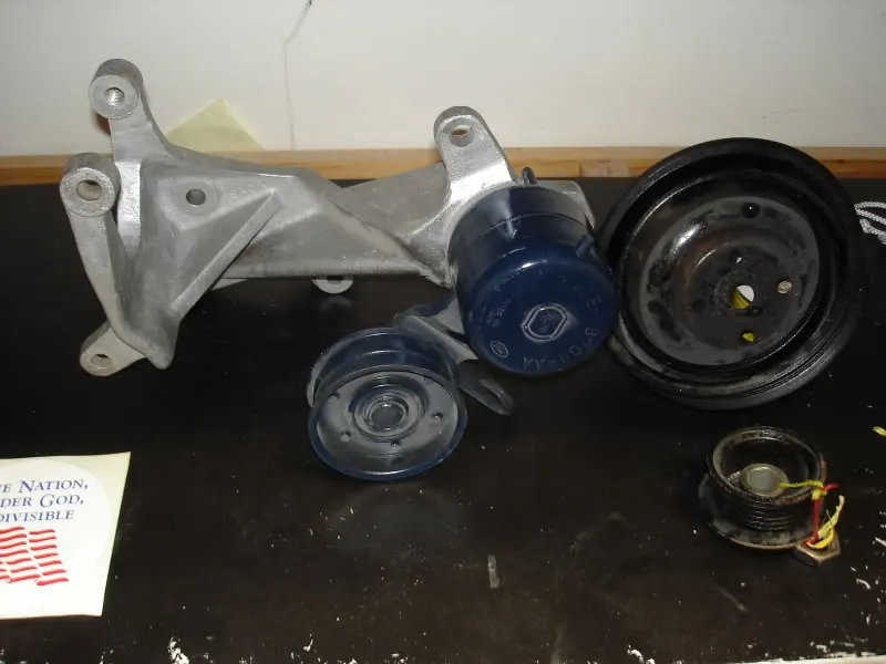

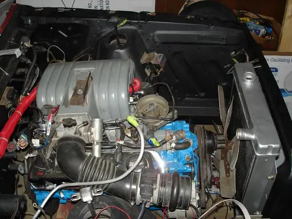

I have a bracket for a serpentine setup which appears to be the '80s model from what I can tell from the ID tag.
on the bracket: E0ZE 10156 BA
on the tensioner: E2ZE-6B209-AA
and the 4-bolt crank pulley
Can you help me find out which 3G alternator I can get that'll work with this bracket, and if the bracket would definitely work with my setup. I have a 302, EFI engine with the upper radiator hose on the p/s.
Here's a pic (only 1 drive belt):
And in the bay:
I hope this serpentine bracket is the right one, I'm afraid it might interfere with the air intake. Anyone know where I can get a set of bolts for this? I don't have any nor any extra's.
Also, would 1-wire be the way to go? I've seen some one ebay - probably cheaper than getting it at the parts store, 'eh?
So for this setup I have no-A/C (for probably another year) and no power rack. I would love to get a power rack - something like randals rack or whatnot.
Any info would be appreciate! ty!

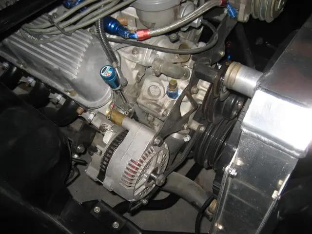

Here's mine:
I think mine came off a 1994 Taurus with a 3.0L v-6. I wanted the one with the small case and the small ears, but I think all of them will work if your using vbelts.

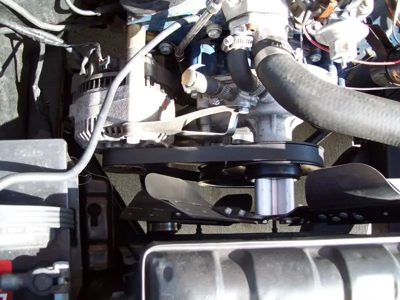

Heres what I did on mine. Junkyard alternator (still has Taylor Auto mark on it), along with about 6' of big gauge output wire from a 3.0L pushrod Taurus, a 5.0L fox body crank pulley, and a 5.0L Crown Vic water pump pulley, walked away for about $25. I wont gaurantee that the pulleys will line up on everyones setup since I used a Milodon water pump, but it worked for me with no shims.

That looks real good! Did you have to get the connector from the donor car?
An issue I currently have, is the P/O put in a GM alternator (60 amp) using the GM connector... And now I have the EFI system.

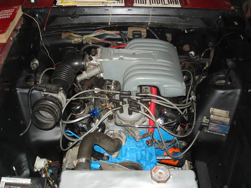

Here's the pic
It's obviously a crappy pic but you get the picture. Also the alternator I got wasn't the right size so I fabricated a little bracket which works perfectly.

No the pic is good. And I think that will interfere with the EFI air intake tube & air filter I currently have (stock 5.0 air intake tube). I greatly appreciate you posting that pic. I will definitely keep the bracket for the supercharger conversion (that'll prolly happen in 2013, lol), but I guess I ought to go to pick n pull in SA, TX to find me a 3G alt and water pump bracket. What donor veh's can I get both off of? (I'm in Corpus right now, but will go to pick n pull on 5/16 - any and all veh listings would definitely be helpful -the times I've been there the 5.0 mustang engines were all pulled, usually 3-5 of them there anyhow.... should have crown vics and mercury models - which year/model though are good donors?)
I'll go serpentine since my 60amp alternator isn't going to be enough to support the EFI, stock wiring on the '66 and 6 1/2" speakers (no subs/amp). I do plan on going with the taurus fan in the near future (1-5 months). I have no shroud, and when I used to drive the car to college it would overheat in traffic (dead stop, moving forward by the foot).
