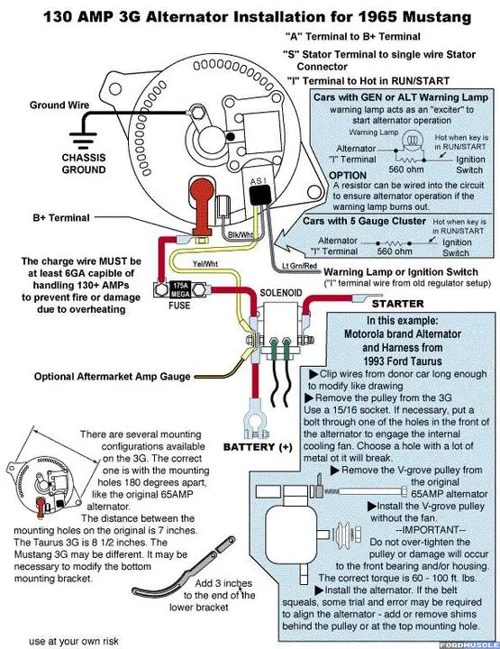

The above wiring scheme seems strange.
Why is the sensing wire (yellow) placed behind the fuse?
If the megafuse burns, yellow wire will pick 12.x V and provide full load to alternator's field, eventually destroying it - as the alternator's aoutput will be disconnected from the battery!
