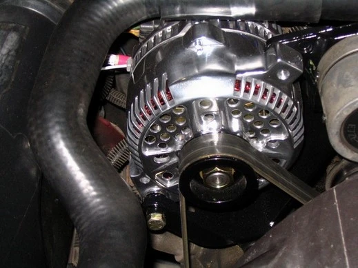

Hey guys,
Just finished installing the PA Performance 3G 130 amp Alternator and it works great!!...Here is a couple of pics...only modification needed was to trim/grind the stock alternator bracket to accept the larger 3G...(I decided to paint the bracket while it was off!!)

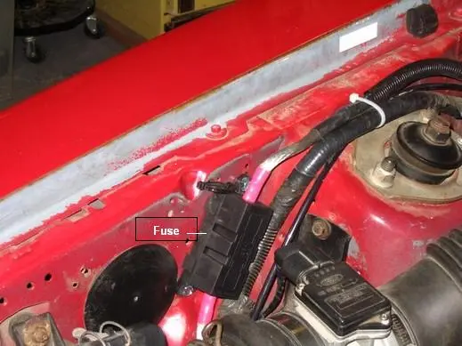

I was gunna ask the same question, except that if that fuse in the pic is betweeen the alt. and the battery it is not needed... If the wire is ran correctly there wont be an issue with it shorting on anything, I can put up a pic or two later of how I ran my 1/0 guage wire from my 240amp alt to the battery. Im not 100% sure but I dont even think that the stock wire is fused. Also did you do the big three for the wiring, if not you wont get full potential out of that 3m alt.

2) When fusing your alternator to battery positive wire, fuse it toward the battery end of the wire. As IMTfox points out later in this thread, the battery will explode if it's overloaded, while the alternator will only burn out its regulator which won't cause much damage except to the alternator itself. Exploding batteries are no fun!
I could be wrong but it seems like he wants the alternator fused but fused near where it connects towards the battery end on the alt wire?

For the general public, I would never recommend running any alternator without circuit protection. If someone wants to differ from that, fine, but I wouldn't condone nor recommend it to strangers on a forum.
JMHO.
JMHO.
Your right, Im not going to condone it for strangers or the general public... it would be better to fuse it in most situstions, especially if you dont know what your doing because you can hurt yourself. I have a lot of experience in car audio and in my situation it can do more harm than good, also my wire from alt. to bat. is only about 2 feet long.

I agree with JT on running some sort of circut protector between the alt and the solenoid no more than 1 foot from the solenoid connection. This is the proper way to do it.
The factory wiring has a fusable link in it but is not heavy enough to carry the extra load of the 3G alternator. This is why you need to run one along with a wiring upgrade.
Also in the unlikely even of an accident it will pop the fuse instead of grounding out and possibly causing an engine fire.
