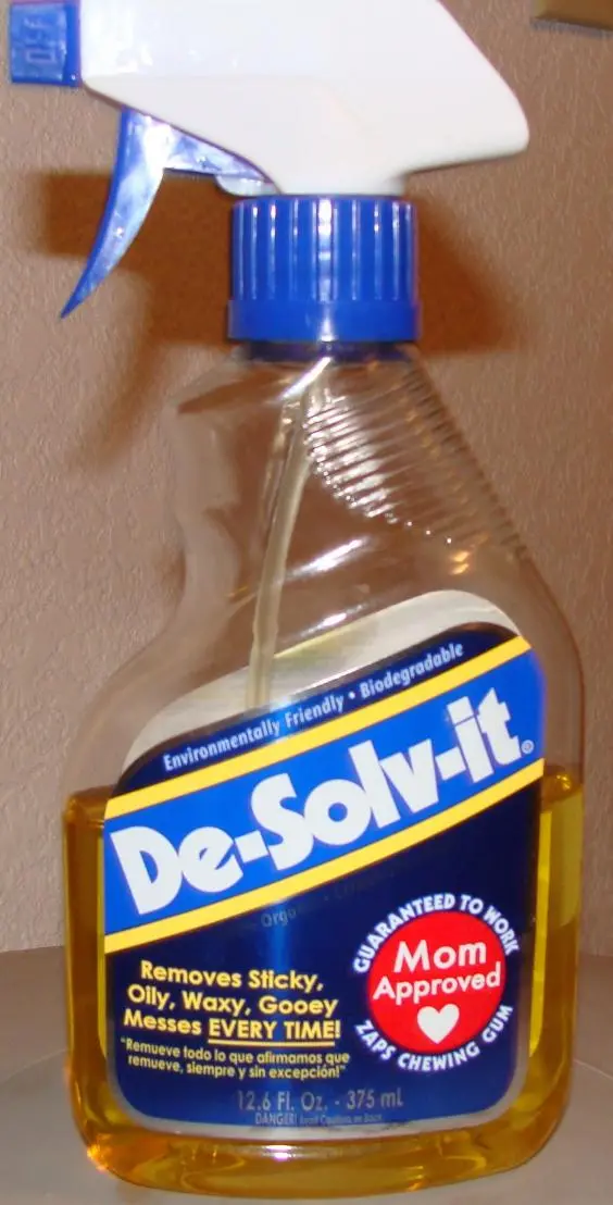

I recently had to remove some automotive 3M tape from my vent shades on my 06 GT, the back section had come loose due to my high speed adventures and I had to remove the tape to reinstall some new 3M tape. I have used this stuff for about a year and it will remove any left over sticky residue from all sorts of tape and labels. This is not the first time I have used this on my paint. You know those cheesy stickers they put on the back of the car for the dealership you buy the car from? Well I tried to be slow and steady and peel it off gently but no matter what I did I could not get that residue off without losing strength in my arm!!! I use De-Solv-it!! You can buy it at Wal-Mart, it is located mostly in the chemical isle with the Windex, I have attached a picture of it so you know what I and talking about. When using it you want to put it directly on a clean soft towel and DAB the residue, allow to sit for about 30 sec- 1 min and just use your elbow grease! You will have to rub several times to get it all, but it is not abrasive, it does leave a oily surface but I simply use some alcohol pads you find in the medicine isle also at Wal-mart to clean it off, followed by a dry wiping of a clean unused towel. ( you can also use a quick detailer for the last step if your car is clean)
Hope this helps!! sorry for the long read! That stuff is awesome, I also use it on stains in my clothes, it works wonders!!
