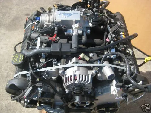

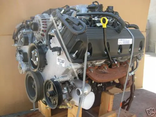

i found a replacement motor on ebay that looks very similar. the intake looks the same on the car in question... maybe with gold on the horse emblem.
but i dont see a oil cooler in this pic. item 260368592580 should get the car back this afternoon.
