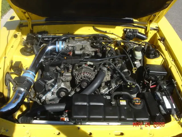

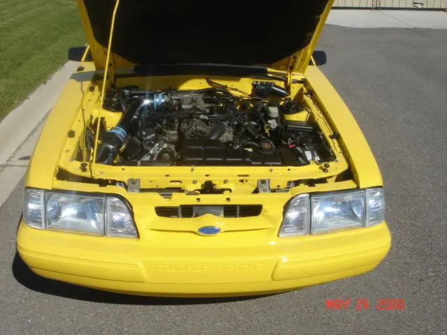

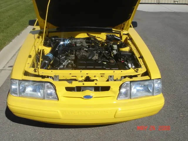

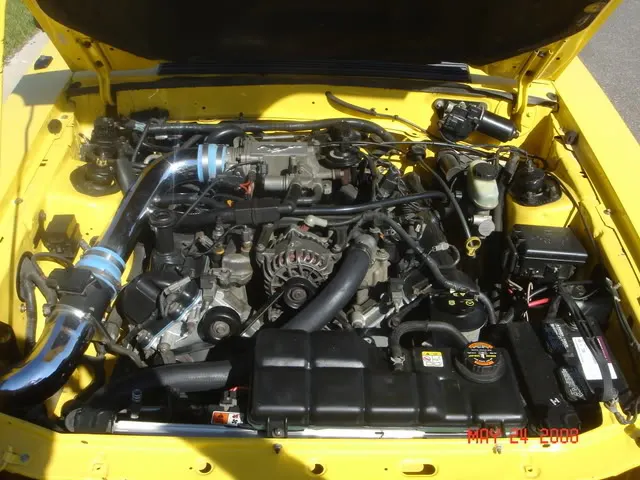

Check out my two links, that Stang1995GT kindly provided you with. Those were both my cars.
Here are pics...
4V
Hack Job
