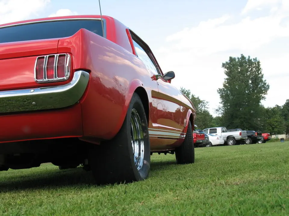

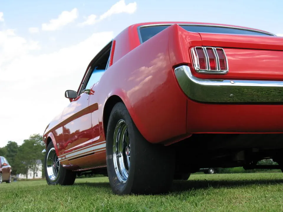

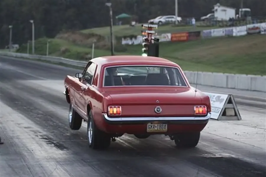

Agree that the car needs to be prepped for the expected HP. I also agree that a built 429/460 will easily make the desired HP and not be maxed out.
A set of welded subframe connectors and other similar chassis strengthening tricks are needed to help maintain the body integrity. With only subframe connectors, export brace, and an 8 point roll bar, for over 5 years I have raced a 500hp 393w and a 4 speed week after week and have yet to experience any issues in body integrity. 26x10 slicks, 5K launches, 1.5xx wheel standing 60's giving low 11 second runs in my heavy street car.

@ Dennis112 The 8 point cage and frame connectors make a huge differance. That thing looks straight as an arrow. 4 speed and all! Looks like it would be a ton of fun to race. Do you bracket race it? If so how well do you do against the automatic cars? We have a guy around here with a 65 Falcon Sprint running a 4 speed and he does just fine. Might win a few more races with a a C4 but he refuses to give up the fun factor of the toploader. I love it.

I run in a dedicated bracket racing stick class, both at my home track (Beaver Springs Dragway) and when touring with the Prostick Racing group. I rarely race the slushbox's but have held my own as this car comes on hard on the top end when it is least expected. The car and I were stick class champions in 2010 with 200+ runs that year.
I agree with your Falcon Sprint guy--a manual transmission increases the fun factor and, for me, is the only way I roll.
