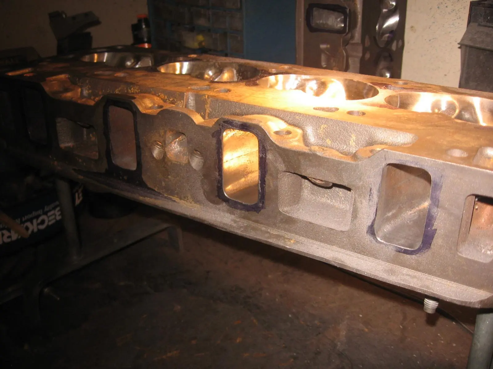

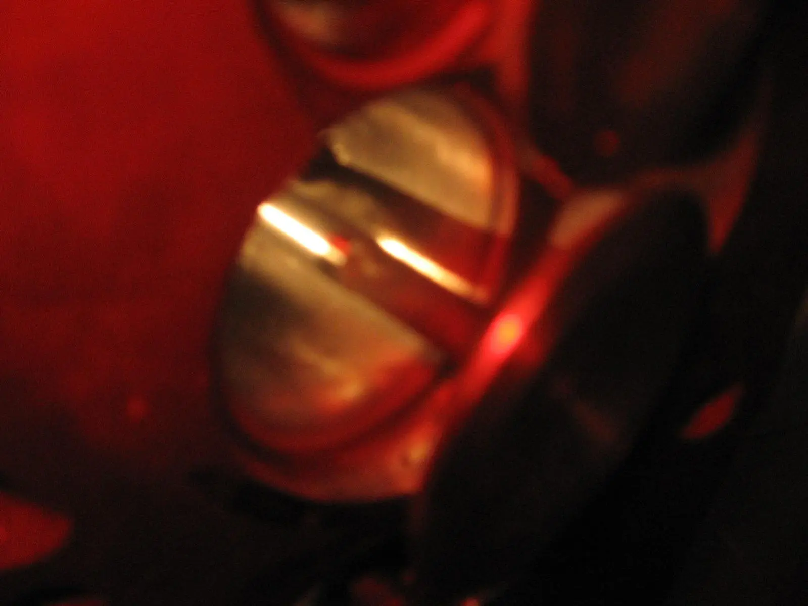

There's nothing wrong with Windsor sr. heads as long as you go in and clean them up a little. They respond very well to a bowl blend and some valve guide boss tapering, mine picked up 20 cfm+ @ almost every lift including a good valve job. Now 277 cfm at .600
I had very similar results on a customer of mine who had to run iron heads, with some work they can work well. I also had good results by working on the short turn radius a little. Now I would rather see a set of AFR205s on there ;)
