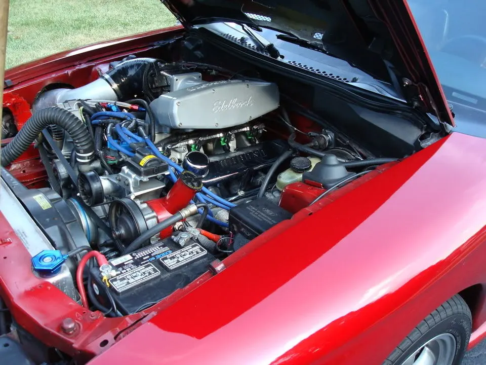

Hi Guys,
I am having the final bugs fixed:
1. Rear chatter - just needs a bit of lube.
2. POP and BOG at 2k rpm from LT's- PMS computer tune out.
3. Bucking below 2k rpm - PMS computer tune out.
4. Axle noise - Turned out to be the trans! Have the main bearing replaced.
5. 5th gear too high ratio (.64) exaggerates bucking and with my BOG it makes the car feel slow and non-responsive likes its in 7th gear or something - putting in a stock .68 5th. :SNSign:
