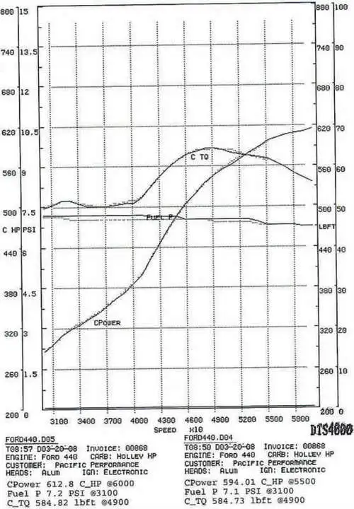

Give Ford Performance Solutions in Anaheim a call at #714-774-9027 and ask for Troy Bowen the owner. He will steer you in the right direction. They built my 427 but with a '74 Stock block. My motor is a pump gas 11 to 1 compression with Aluminum Avenger Heads with 2.08 exhaust valves and 1.6 intake valves. Motor also has a Solid Roller cam with 252/257 dur. and .683/.685 lift and 112* lobe separation. Using 1.7 ratio rockers too. As for intake ,it has a Supper Victor with port work and a Pro-Systems 840 cfm carburetor.They used a basic dyno headers (think they were 1 3/4" longtubes). Motor made 612/584 at just 6000 prms and was still climbing in the dyno sheet. Here it is:
