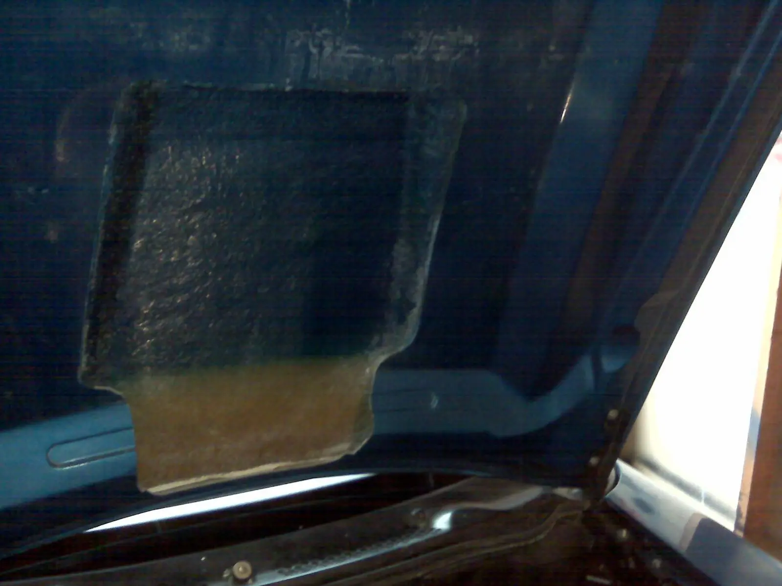

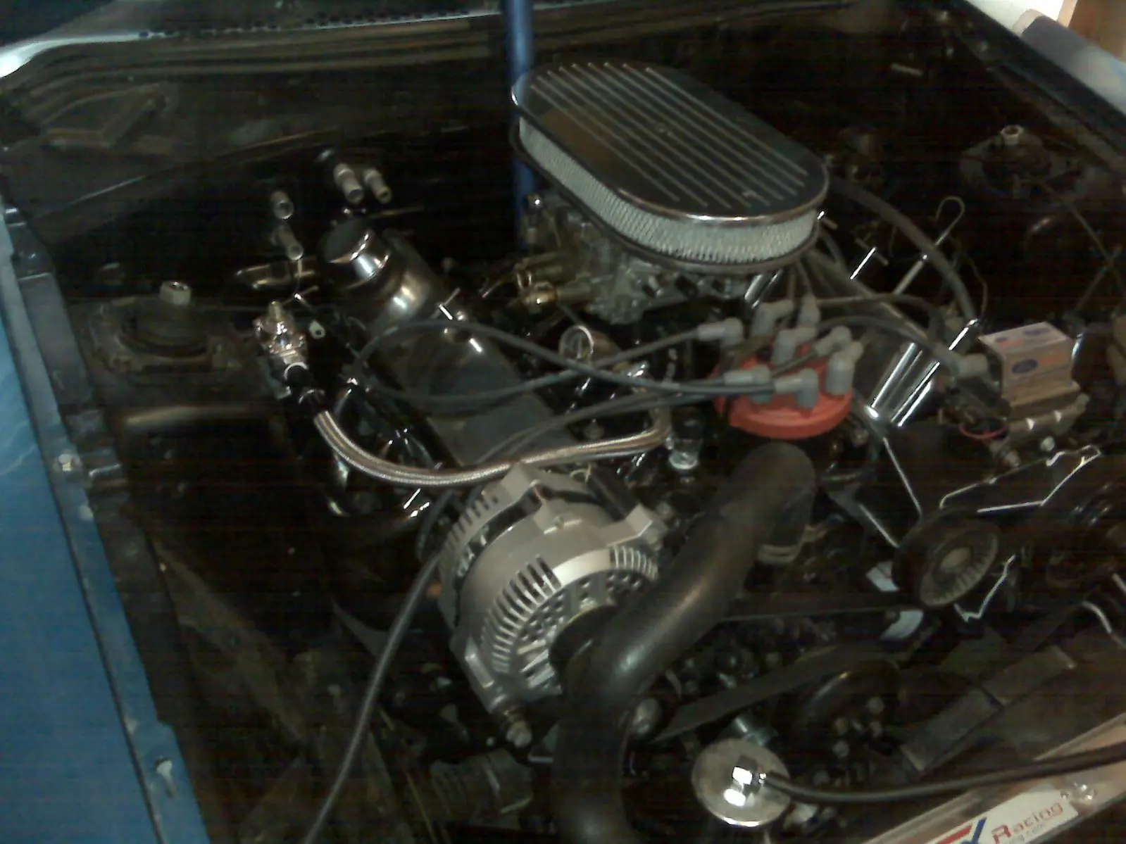

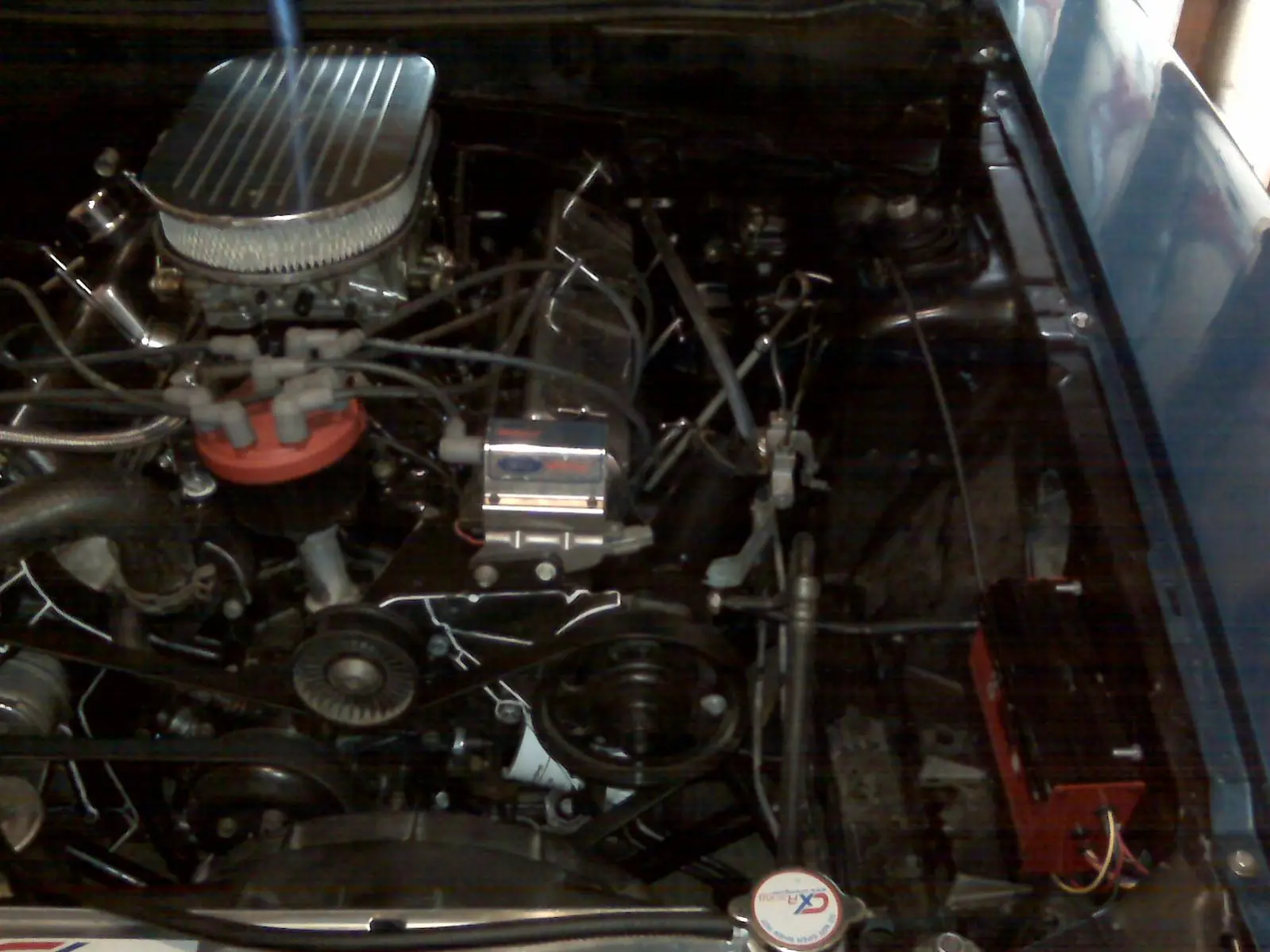

here are some pictures of it. I love the lack of wiring under the hood now.
included are pictures of where my fuse box and CCRM are now, the fuel pump and sump, where I had to trim my hood to get the air cleaner to fit.

I removed the fenders so as not to scratch them also made hiding wires a lot easier. I painted while I was at it too. You can mount the CCRM on the inside of the fender well. I ran a switch to pin 17 to turn my fan on, and I ran a power to the green and yellow wire to turn on the fuel pump. With this done it runs any time the key is on so I used another switch to disconnect the ground of my fuel pump so I can turn it off too.
The engine fuse box is mounted on the inside of the other fender well. I lengthened the alternator wires ran them through the bumper support and out the hole the air filter used to get air from so they didn’t go across the engine compartment. The alternator main wire, the battery wire and the starter wire all junction together near the fuse box.
The entire efi harness went away, I just matched up what wire went to the coolant sensor and oil pressure sensor and reconnected them on the back side of the plug. Right now I’m still missing my tach, haven’t really looked into it (any suggestions).
I used a plasma cutter to make swiss cheese of the bumper reinforcement, it now weighs much less, but still gives the bumper cover rigidity. As you can see the hood I have needed some trimming to fit with the air cleaner, but I think it worked out all right. I got a cheap overflow tank to get rid of the ugly piece of plastic one.
I flipped the tensioner around backwards in order to remove the smog pump and AC. Don’t know if this is recommended by anyone, but it seems to be working. I had to grind down the aluminum bracket a bit to get the range of travel I wanted.
A guy in town formed the sump for the tank and bravely welded it on for me. We ran water through the tank for a long long time.
Timing is set at 18 degrees at idle and quickly goes to 38. Timing chain cover and water pump and everything all worked from my 302.
