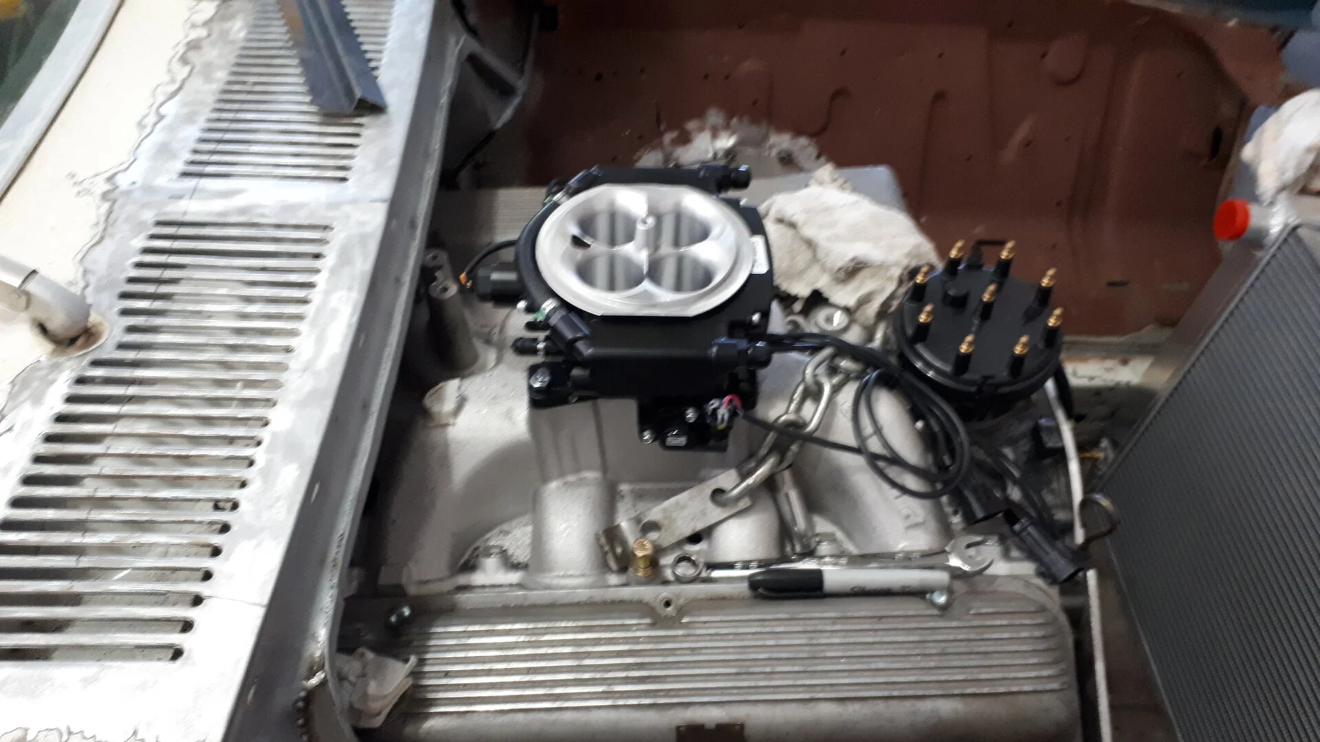

Oh and a surprise coming up to make my hood scoop fitting easier...
sniper xflow good for 800 natural aspirated, 4x100 lb injectors lower profile than a carb (slightly) but a much smaller body so I can shift or offset the air cleaner for filter clearance!!!!

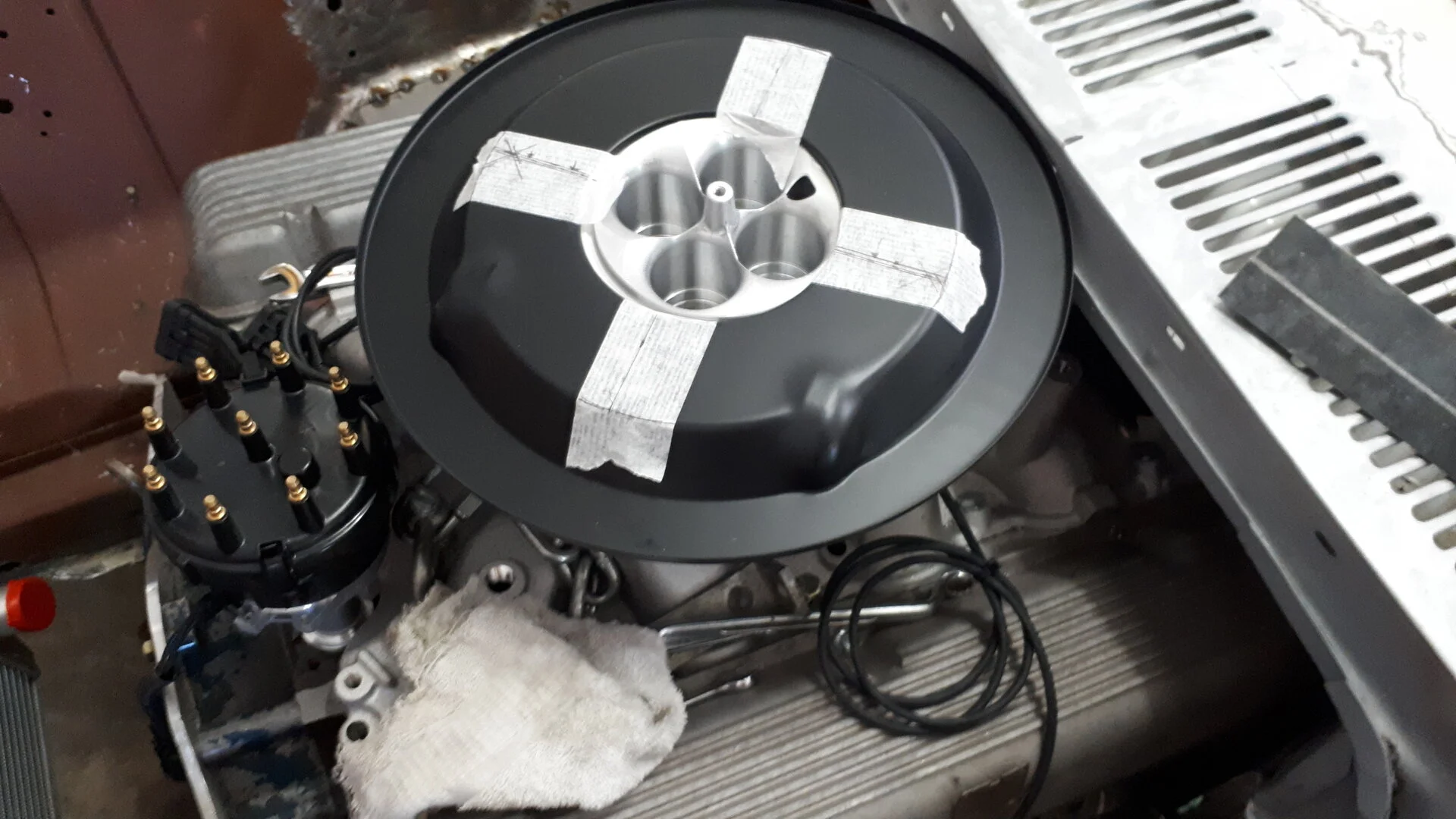

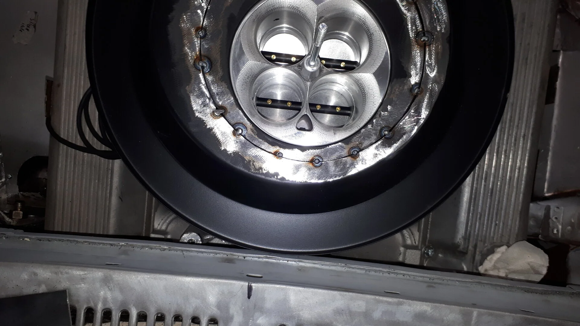

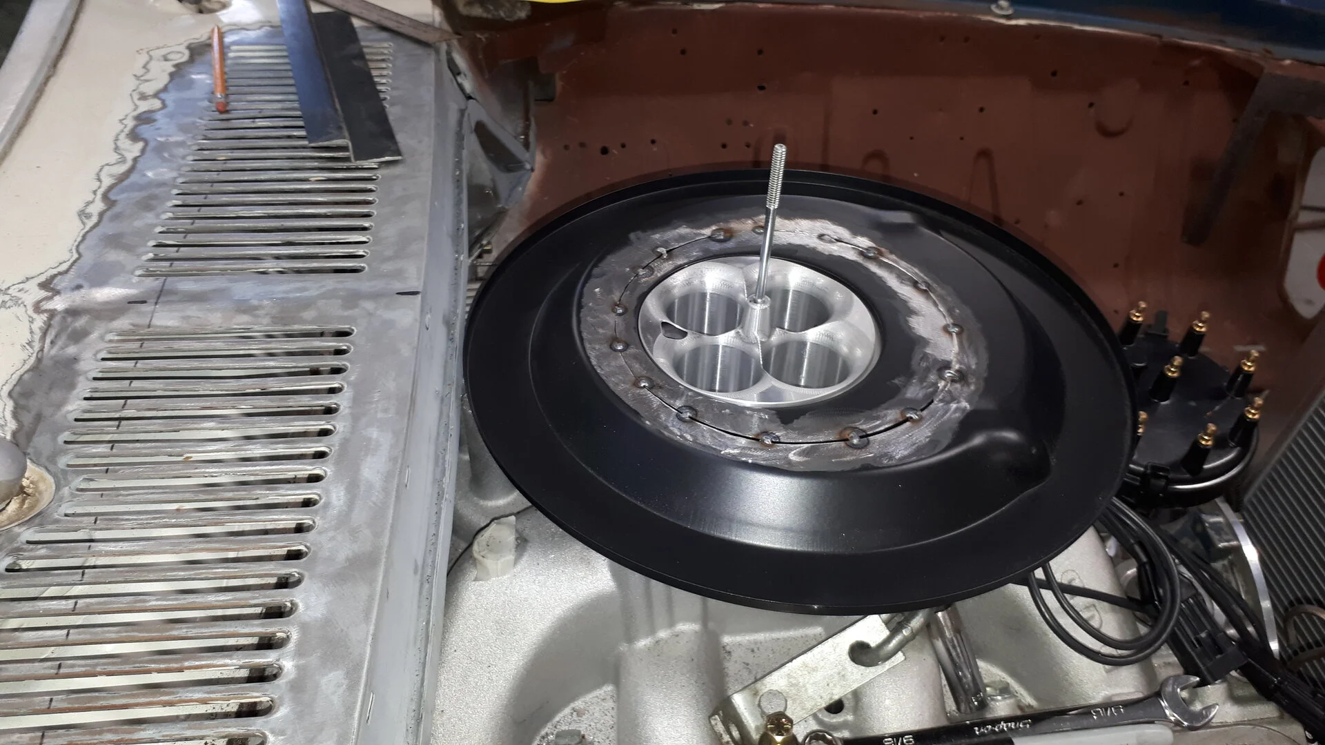

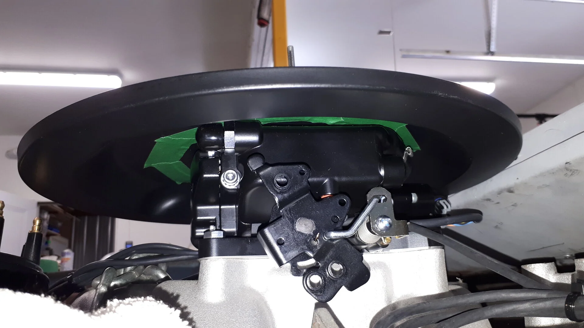

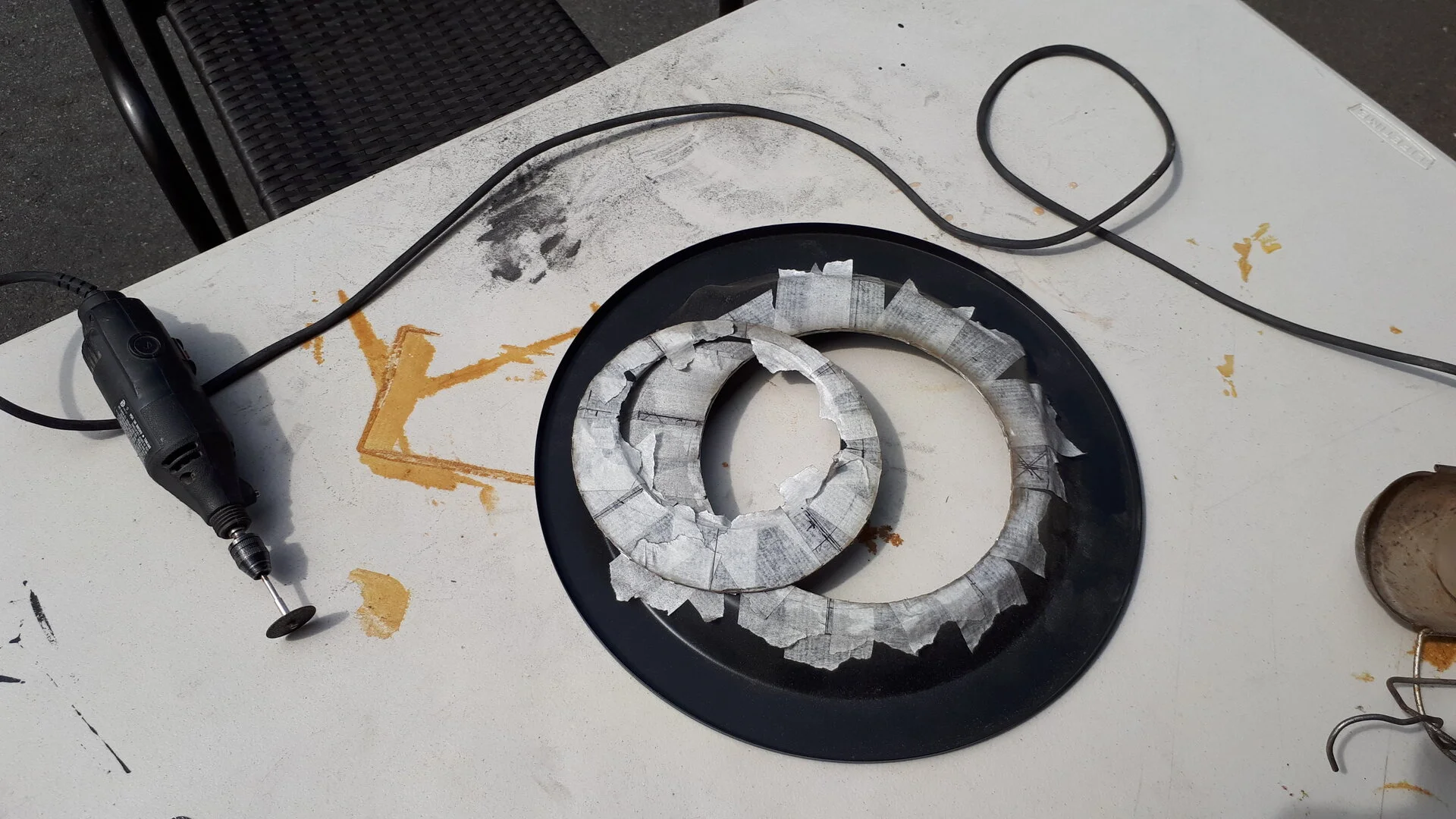

Put the sniper on, way more room to move air cleaner for clearance now. Never really liked the too small for performance air cleaner on Sudden Death, so I vowed to engineer mine to use a filter of sufficient size for airflow required. I'm assuming they must have removed their filter completely for races, because it wouldn't flow enough for a healthy 4 banger.
had to section and adjust the air cleaner base to offset forward and to the drivers side so I made a offset larger circle cut and spun the middle around to where the offset worked. Bunch of mathing was involved lol because I didn't want to have to add metal.
Mocked up and tacked at the offset. It looks like less in the pic, but have about 1/4" firewall drip lip to air cleaner clearance but it's the best I could get. I may have to massage the lip of the firewall or section the air cleaner step on the lid as there is a little more room than needed for the filter. I can either reduce the diameter all the way around, or just at the back where it's needed. Not sure yet. Engine should not move front to back, but I like as much clearance as I can get to save problems later.
underside. Lots more room without big float bowls. Edelbrock wasn't much better, plus they don't have a big enough carb. I needed 900 cfm based on engine volume at rpm for this engine.

Thats a heck of cut for a Dremel, nice job.
I like the non concentric circle planning. Making the ole melon earn its keep.
Now with the big ole air cleaner will you still be sectioning the big ole hood scoop?
lol.... re: Dremel ...years of modelling I think helps (building them..not trying on clothes) the dremel on a curve is hard but every other method I have just removes too much material and I wanted the welding to be easier since its thin and I have to set my welder on the lowest setting (I still have to use a brass backer in some spots).

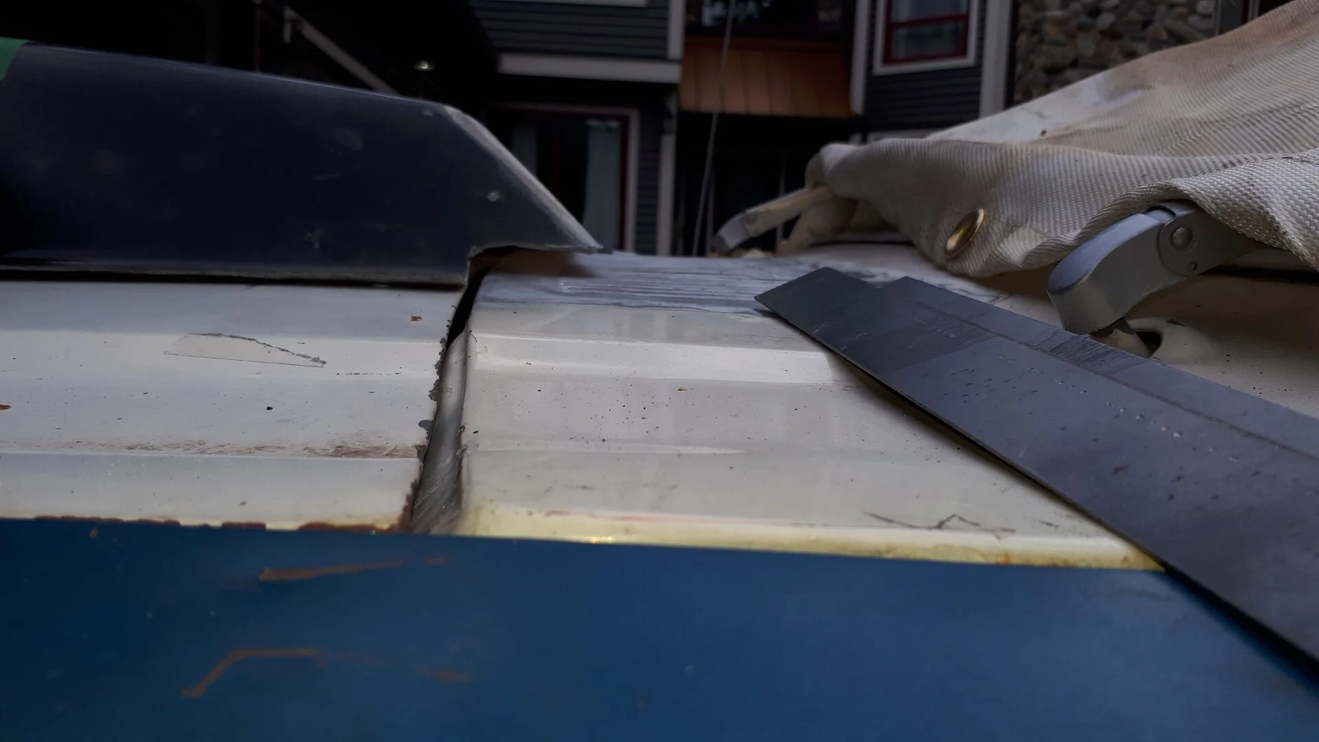

I still (maybe)have to make scoop smaller. I chopped down the length of it about 3 inches, not sure if I can trim down the height yet. Filter is still a tight fit believe it or not. Working on that math today and also whether I am having the filter located in the scoop with a seal on the base ala' L88, or regular filter on the base.
The main problem is still how far back the filter sits. The back upper corner of a 14x3" filter contacts the back of the scoop where it slants from the back up towards the top. So I am thinking of using an 11x3" filter with a k&N filter top in the scoop, and the l88 seal to the underside of the hood.
Or...
slide the scoop back a inch, it will overhang the cowl, but with the way these hinges work the hood lifts up as it opens so it wouldn't hit the cowl when opening, and the one inch overhang doesn't cover the cowl grille or anything so that could actually work too, and the added benefit of the more further back the scoop sits the better balance of the look of it. (big lump forward on hood looks weird compared to further back)
Experiments to follow..

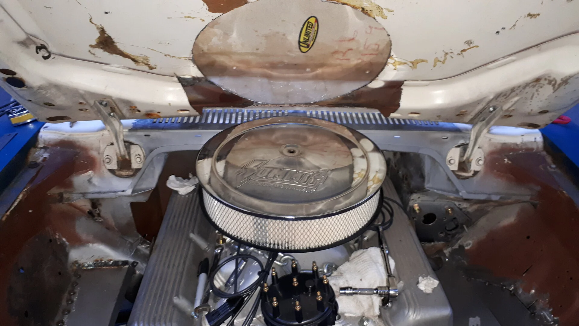

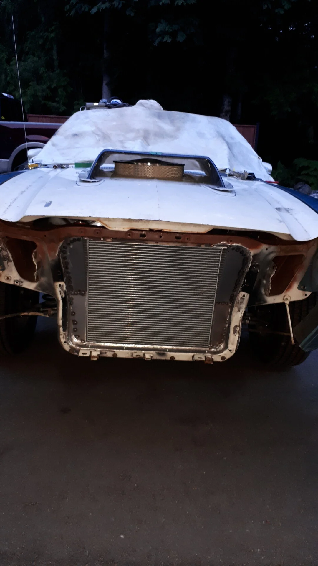

Decided to do the move the scoop back 3 " and clearance so it opens option. Fits a full on 14x3 filter, and room for a filter lid if I want as well. Set the rear glass bumper in place to see how it will look.
Reactions: Olivethefet, extra_stout, 2Blue2 and 1 other person

The sniper EFI looks like it will flow awesome! Now the only way to improve air flow is a salad bowl instead of the air cleaner
The hood scoop looks much more in proportion. I also think that at the moment the black on white contrast makes it worse than if it was the same color...
By the way: what color will the car be? sudden death gray?

An impressive build all around. I vote move the scoop back.
Although. Don't get too mad at me for this. I think I saw a hood for our cars that incorporated the cowl panel into the hood. I am 80% sure it was for sale at a hot rod shop online. I don't have the fab skills so it was not my cup of tea. You on the other hand have mad fab skills....
May have been a one off build but they extended the hood and moved the hinges back. Memory tells me there were able to hide the wipers too.

On the scoop topic, having moved it back 3 inches over the cowl (just very roughly at this point) It will serve the purpose, and allow me to fit a 14x3 filter and I can still section the height a bit if I want, as there is about 1/2" clearance from the air cleaner lid to the scoop, but I haven't decided since I like a little clearance around things also. If it ends up a little large for the car, then so be it. It will be painted body color and lets face it , I need the room as I picked a pretty tall intake, and I want a big air filter. On a side note.. if I re engineer the carb base plate I may be able to gain another bit of drop as there is room left...but it may be at the expense of cowl modification, which is a "6 of 1, half dozen of another" proposition at this point, because I don't hate the look of the scoop as much as i thought I would, and cutting into the cowl would open up more work to finish to a sort of stock look.
