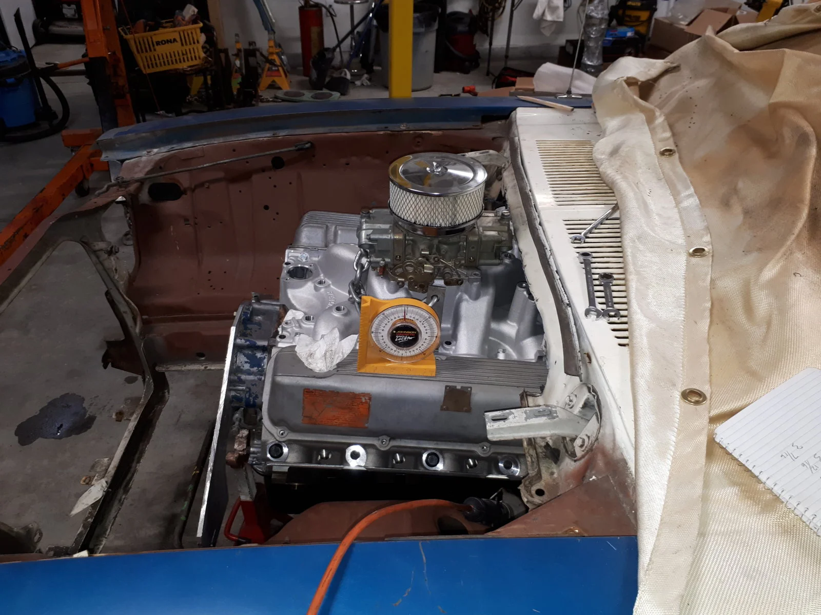

Building a 1978 Mustang. Should be fun.

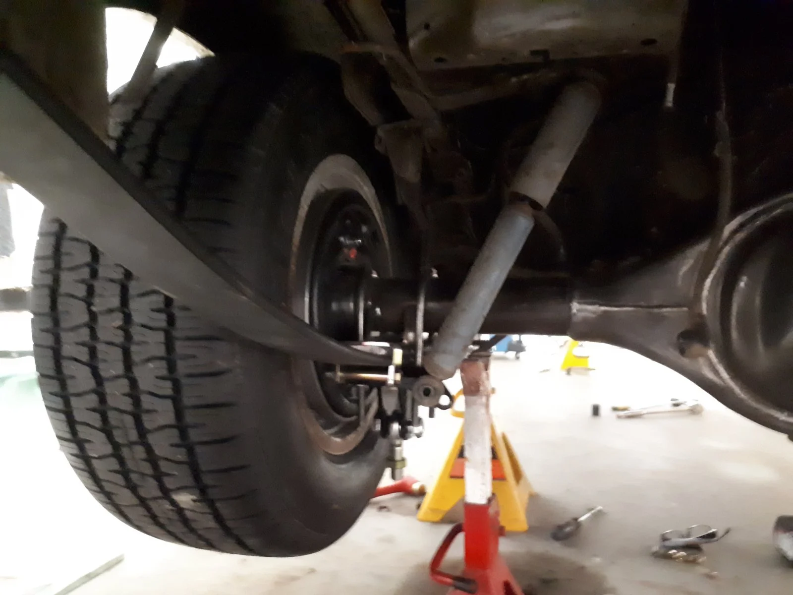

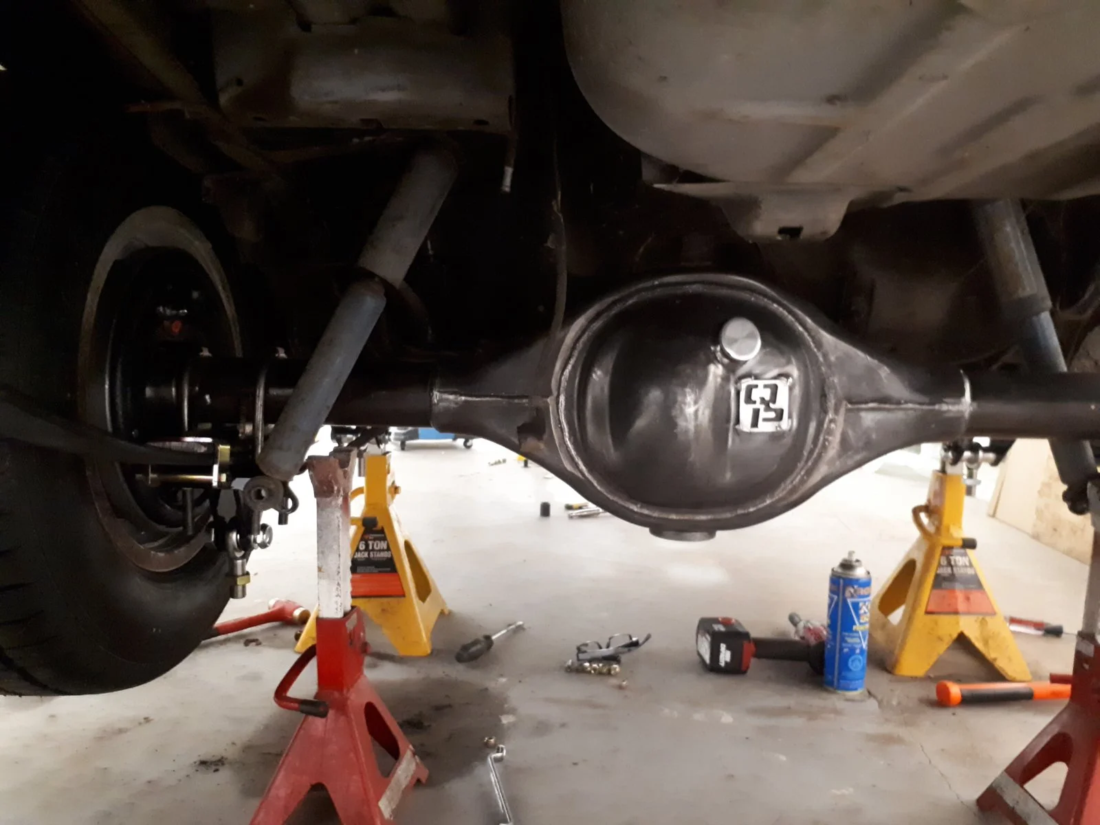

Has a 1970 429 CJ and will have a new 31 spline close ratio top loader once it arrives. Got a 9" built for it 35 spline locker 3.70 gears.Built it for maximum room in factory wheel wells which are actually pretty big. Diff ended up being shortened about 2" Complete cal track set up on rear with Cal trac mono leaf springs.

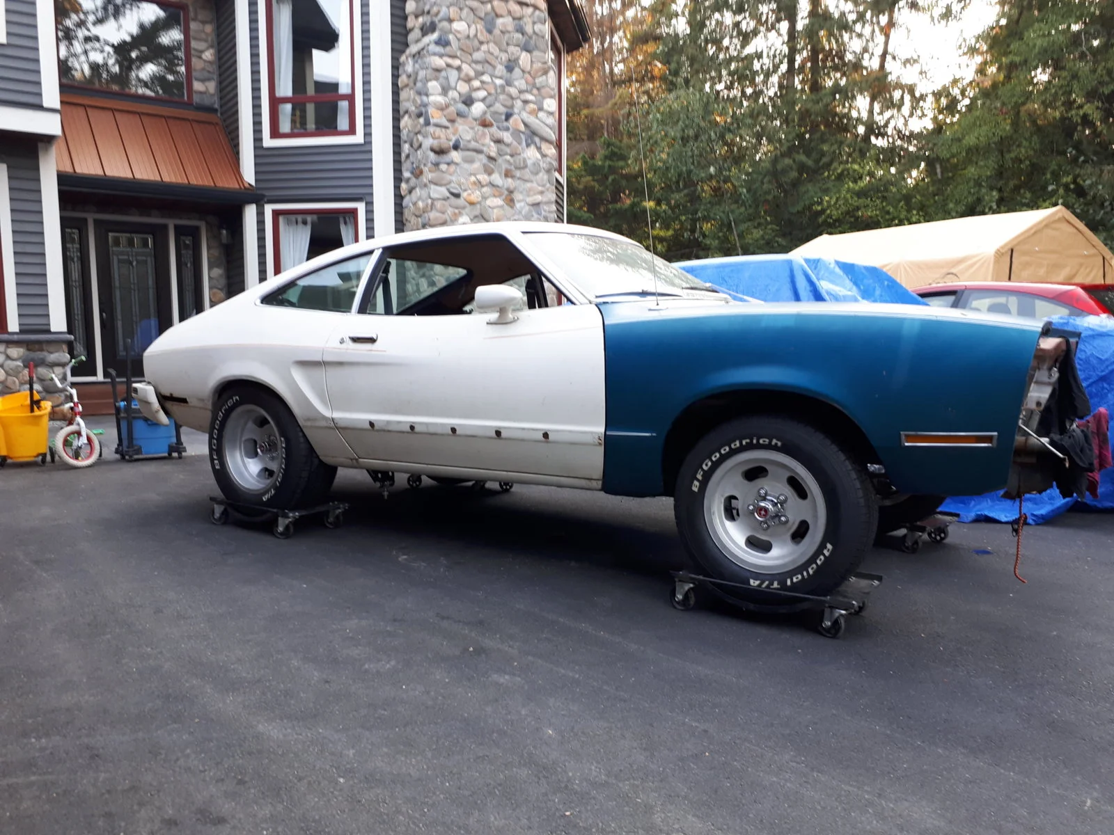

Not tubbed, trying to leave wheel wells stock. Converted to 5 lug wheels all around. 14X6 in front 15 x 9.5 in rear. BFG 205 front 255/60 rear. Currently Frame connectors on order and will have a roll bar 4 point kinda like a stock 69 shelby style.
Car is rust free, was (is) white with black interior 302 auto with a/c car originally. Thinking either white or maybe gulf stream aqua...not sure yet long way to go before paint.

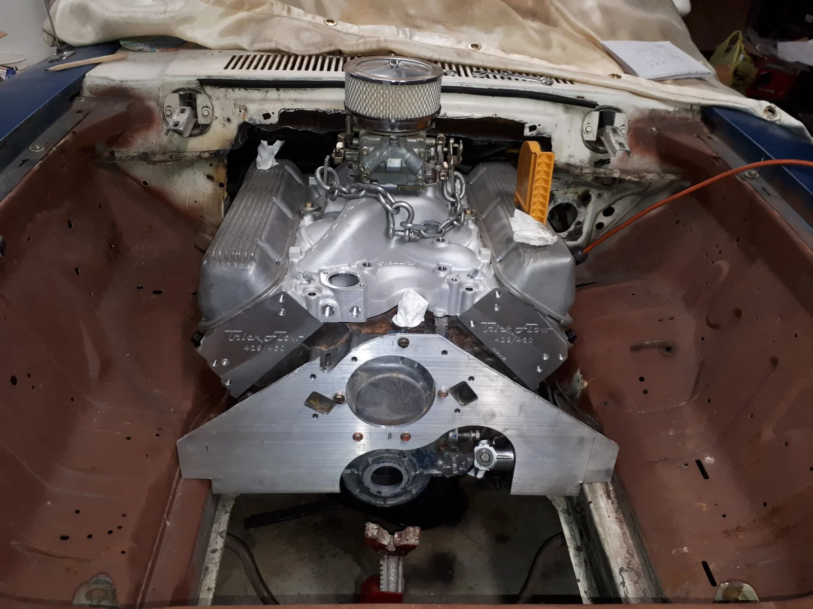

Engine is set back about a foot in chassis. gaping hole where firewall used to be right now, but still in fab stage.
Using an aluminum engine plate for engine mounting,
Planning on fibreglass mid tuck front and rear bumpers and a fibreglass hood. have to devise some sort of scoop as air filter sits above hood height.
Well just thought I would say hello, Now I'm gonna poke around on the site.

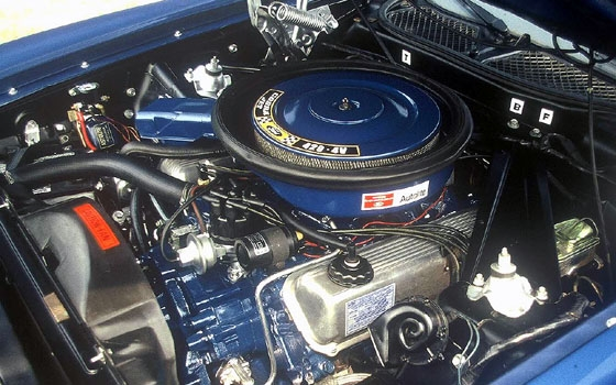

Big Block 78 mustang!?! , we are needing some serious pictures of this.
Ford_429_Super_Cobra_Jet_Engines_fcf65b25-4b36-4d72-bb1f-b22805d8d8b4.webp plus 7f3b74999df0d5f7d145f895fadc04a6.webp equals 71ef66b8ce343ca3967b278048912d96.webp

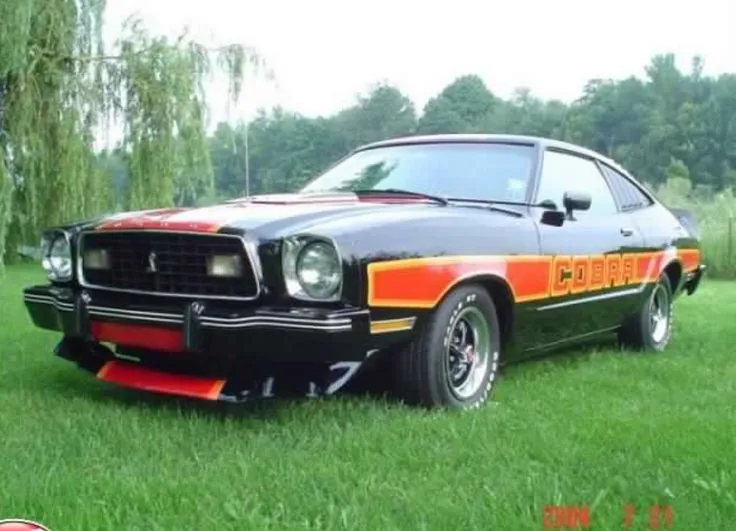

10 years ago I bought a 78 black/ gold 302 4 speed billboard cobra off the original owner but it was really rusty, so I sold that one too (should have kept that one in hindsight. It was complete with all options and rear aluminum louvers )

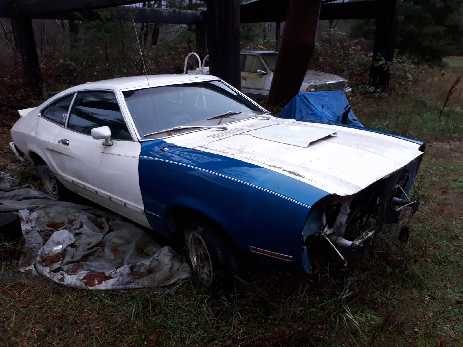

Fast forward a dozen more years of trying to find a rust free example that was cheap enough to allow the major investment in parts required to do the job and here I am now.
Picked up my car less engine and trans for 800 bucks. Bought a 1970 D0VE 429 engine and trans for 500 bucks, sold the D0VE heads off it for 500 bucks, bought some trick flow heads etc etc and started building. It now has aftermarket rods, forged pistons and a mechanical cam.

I wanted to make it as sleeper as i could which is why I went with the slots, because it came with 13" slots, and my 77 Cobra had 13" slots as well.
I paid more for these wheels than I want to admit, but I needed particular offsets and the right type of slot.
