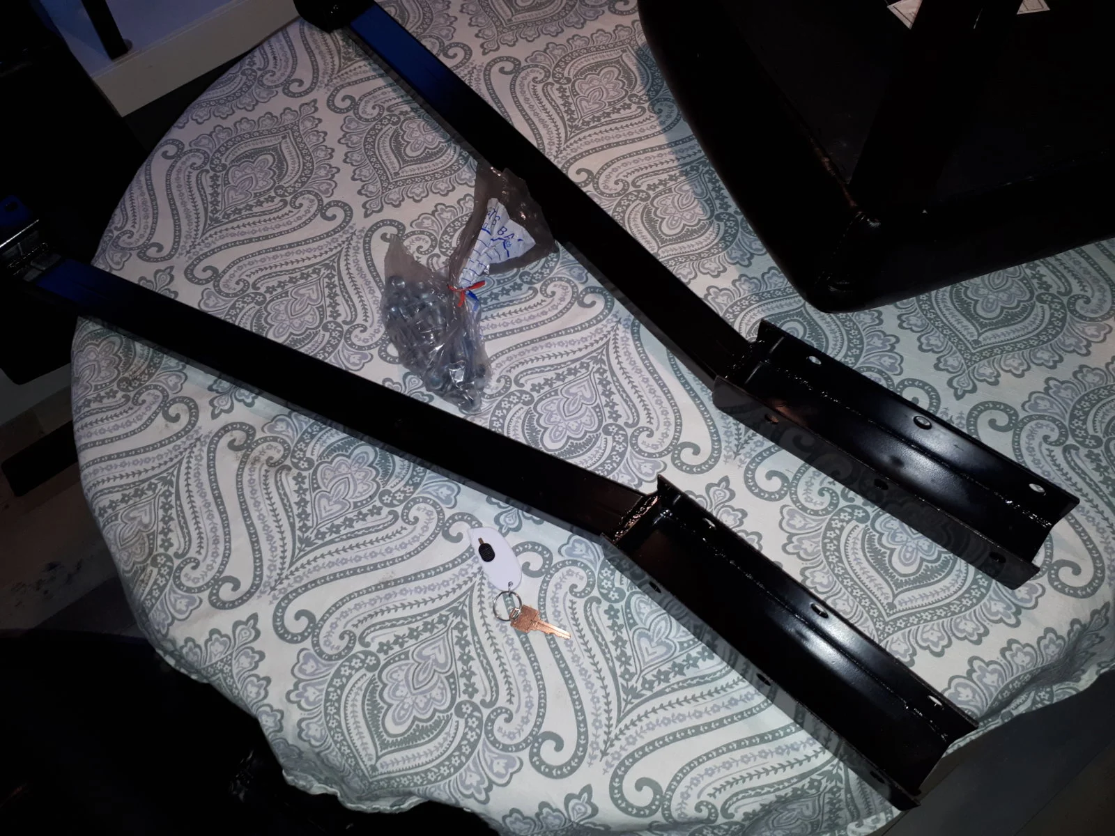

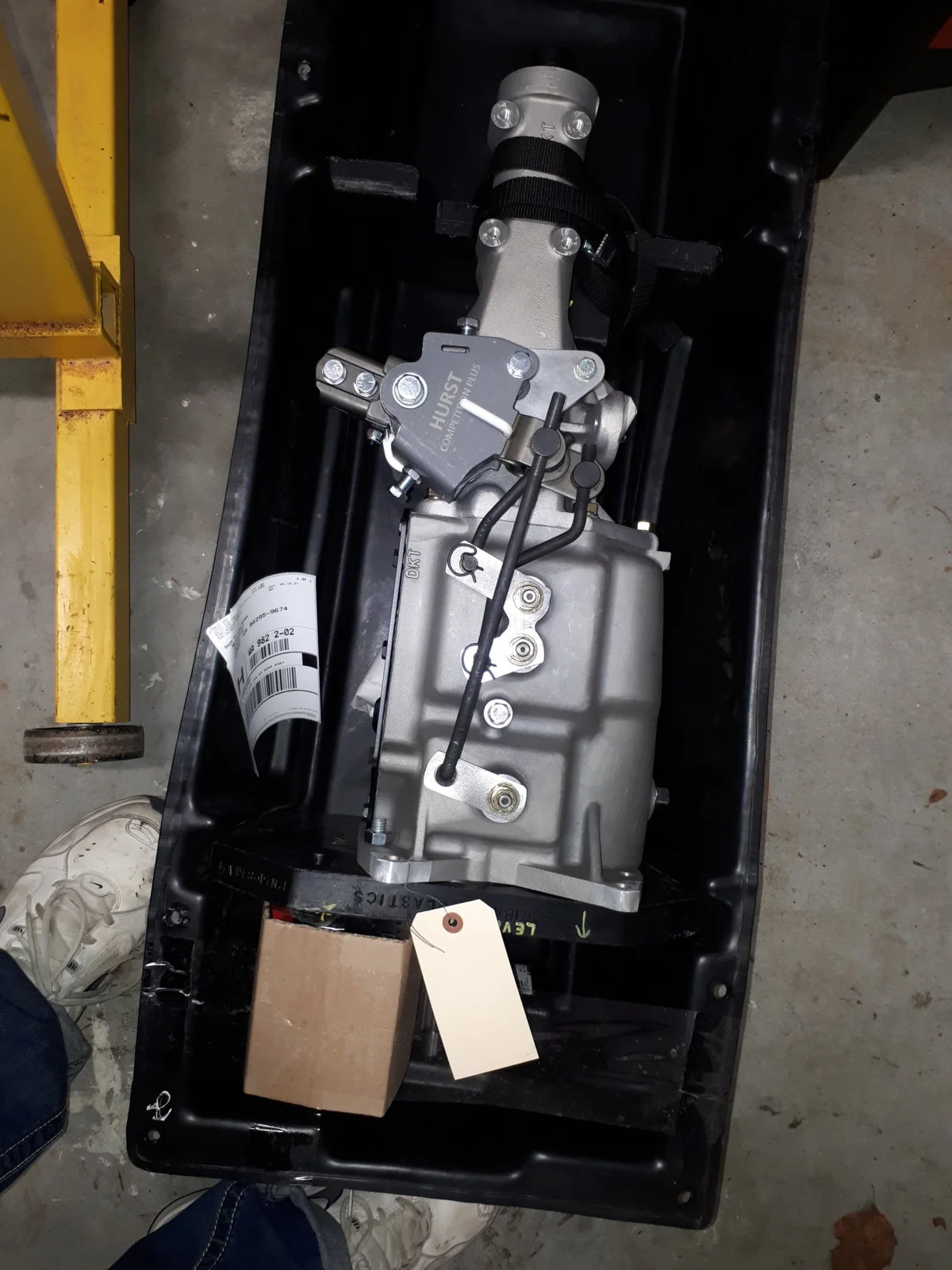

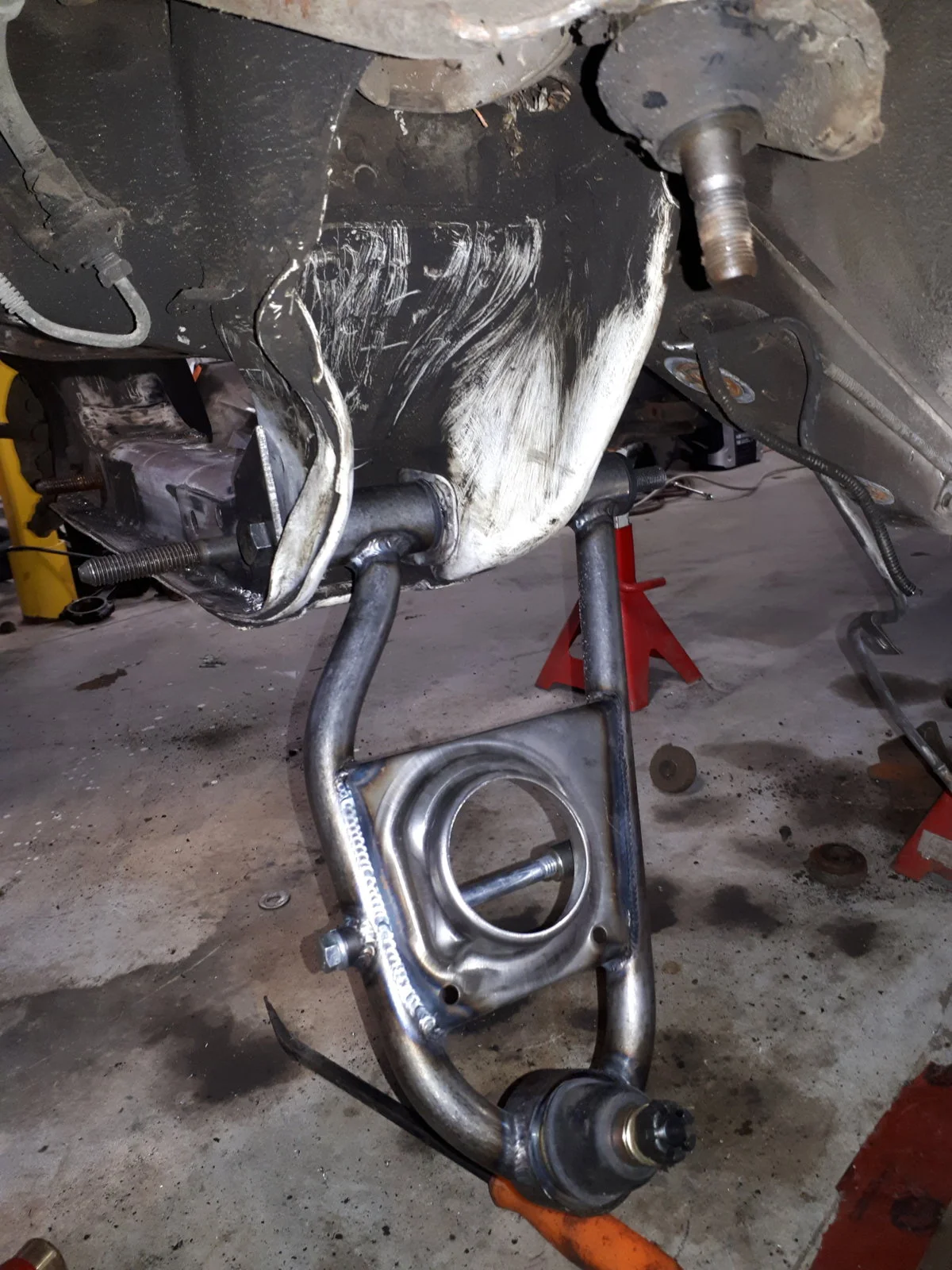

Just started mocking up the crossmember reinforcements and tubular lower control arms. My transmission arrives tomorrow from David Kee. Subframe connectors supposed to show up too. I better get busy. I will post some picks of the control arm and subframe mock ups soon, Just need to upload the pics to my computer first.

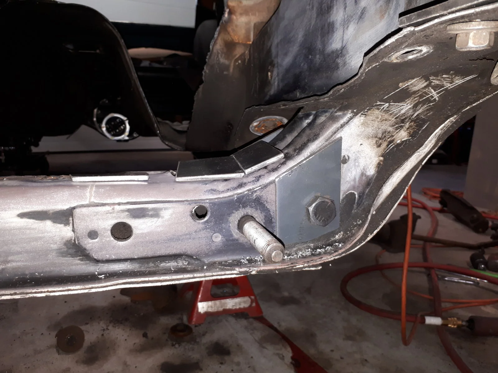

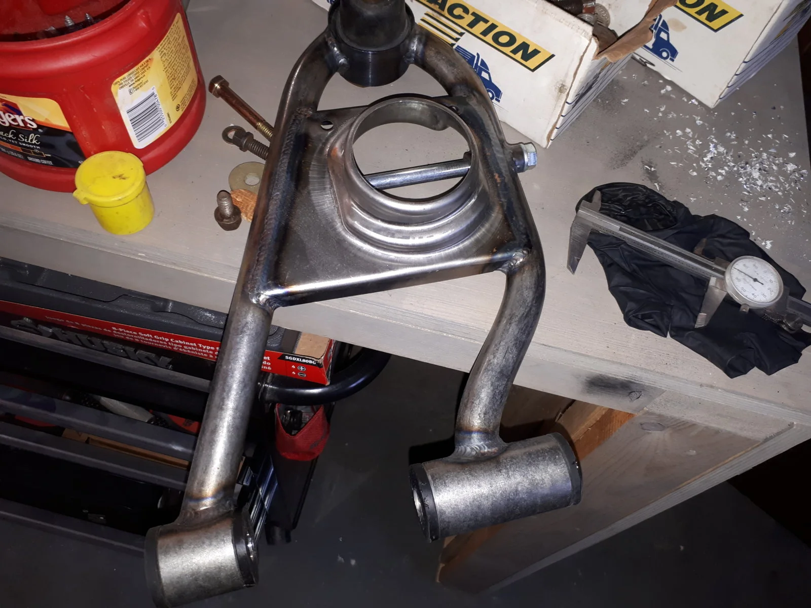

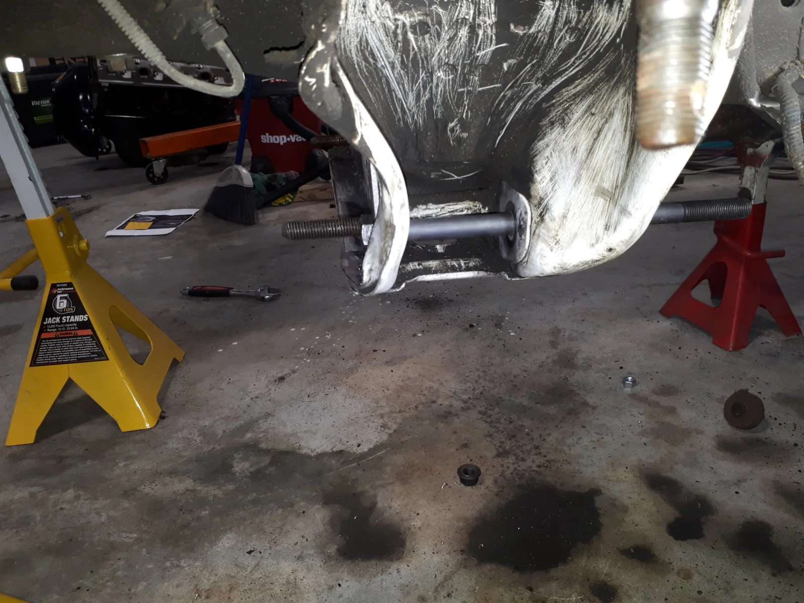

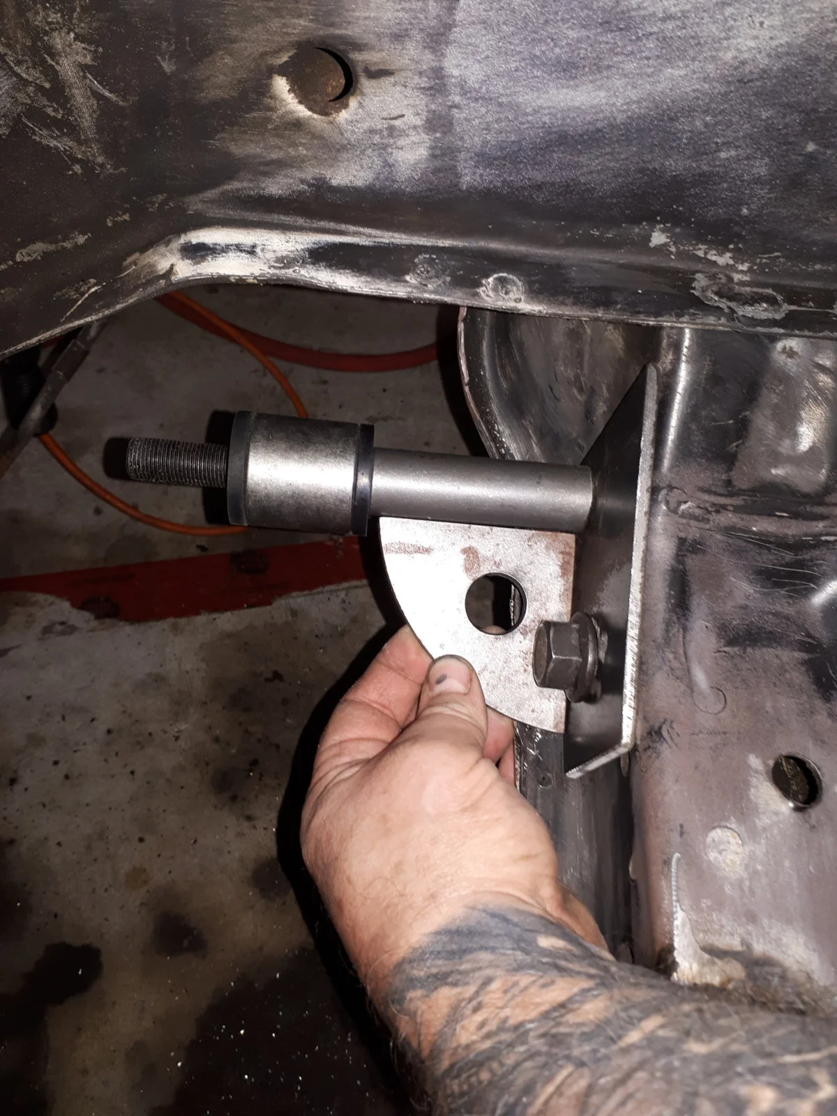

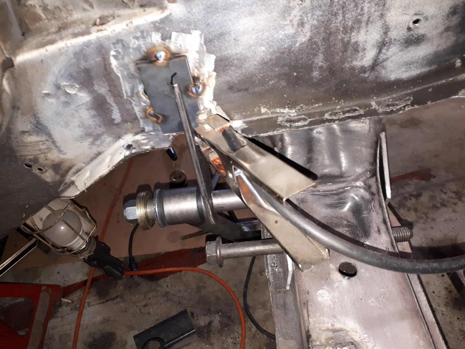

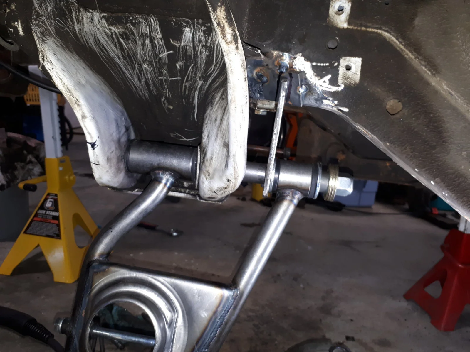

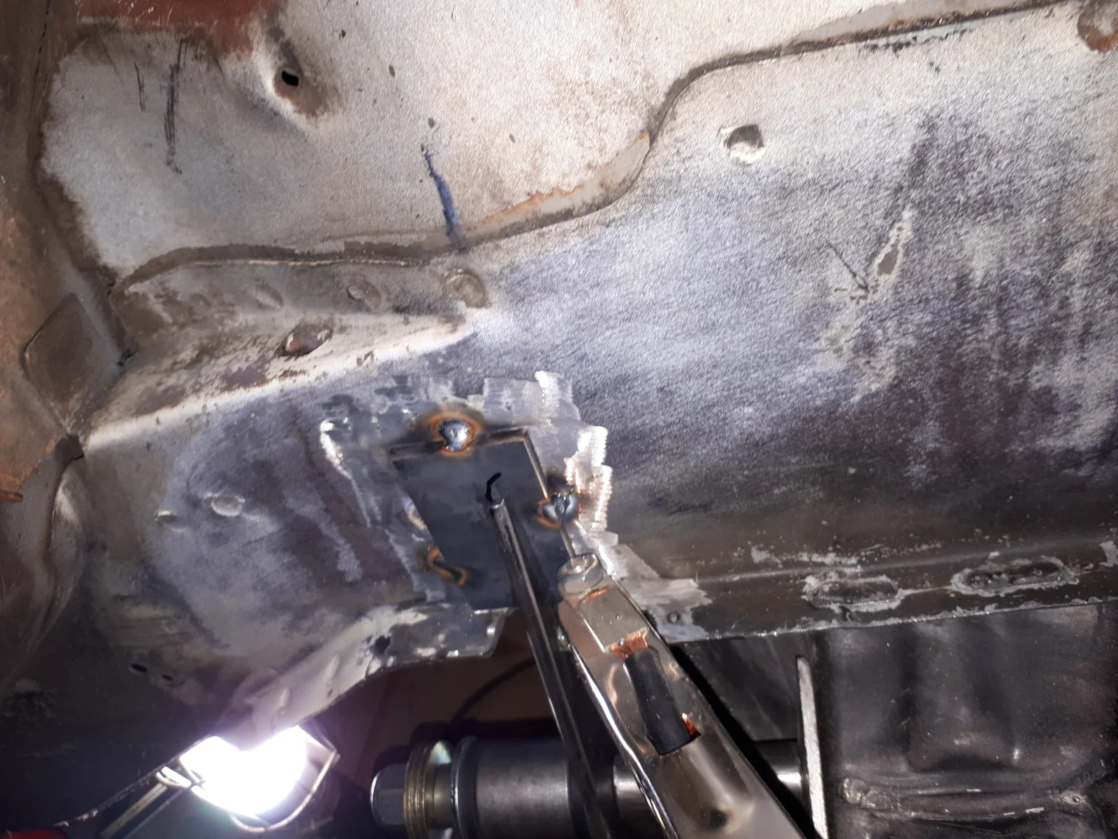

Some pics. Got my trans finally. Started fabbing the crossmember reinforcements and lower A arm adapting.

I haven't seen that tubular A arm, doing away with the rear mounted strut rods, Nice!
Do you have to can the bolt in cross member behind it?
Stumpy subframe connectors, ( what? no stumpy's traction bars?) I want to see pics of this install.
And look at that new DK trans in the box, its just like Christmas I tell ya.

Yeah I wanted to lose all the strut rod stuff for header clearance. So these a arms from Full Tilt Street Rods. They are meant for aftermarket crossmember so a little tweaking is required but they will be sweet and strong.
The lower bolt normally just has a gusset but I am going to gusset and support in double shear. Need to make the bracket, It will go where the big strut rod bracket used to bolt on and solidify that area as well as support the rear of the new a-arm.
The design of these arms means the rack stays in the same place instead of having to space it out for a-arm clearance.
I am reinforcing the crossmember with doubler plates, although technically there is less weight on it now than with the 302 due to the massive engine set back. My car had a/c also so my front springs are really stiff, and I may need to lop a coil out for proper stance.
My whole rear suspension is Calvert racing. Mono leaf springs and the Calvert traction system which is absolutely the best leaf spring set up for stick cars, so thats why I have that, Its an engineered and fully adjustable rear traction link system.

more pics coming shortly, I got the first lower a arm in with all the brackets and reinforcements ready to weld up. Just tacked in right now.

esab em215 rebel. those plates are all now fully welded. I'm not a great welder lol, but the penetration is good and I probably didn't need to fully weld them all, but makes it strong so that is good. I wish I could make the pretty welds but I just don't get enough practice.
