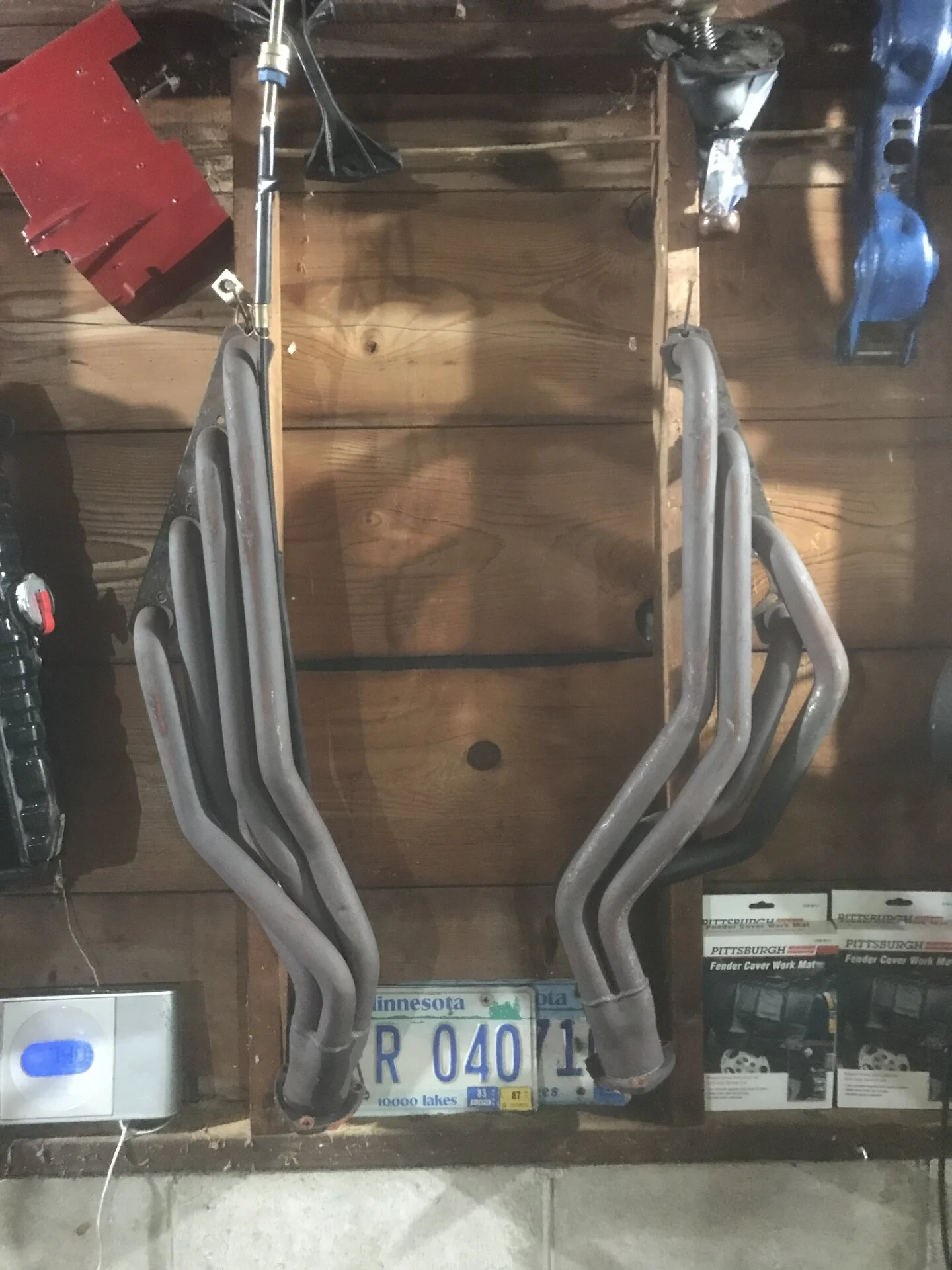

My headers originally were black. Now they're rust. Is there a way to clean them up?
I'm more or less in the same boat. When I decide to pull them out and pretty everything back up I'm planning on having them media blasted and ceramic coated again. I'd start there. If there's anyone around the Minneapolis/St Paul area who does automotive ceramic coating I'd ask them. They may do both in house or have someone they send them off to, so that would make it a one stop deal for you.

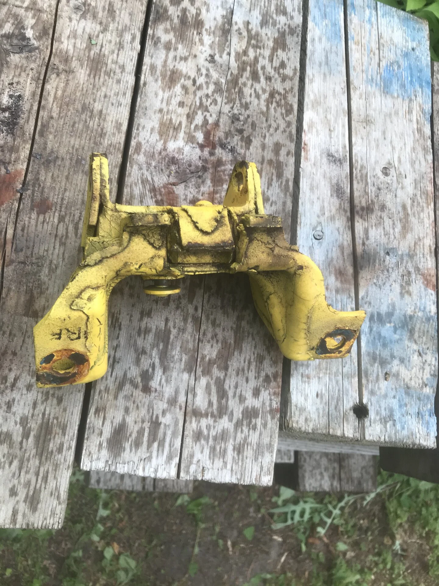

Then I started to replace the old rubber motor mounts. It started to rain and the mosquitoes decided my garage was safer than outside. Called it a day. Besides I need to get some window grade urethane which would be normally easy to do but, all the auto parts stores in my neighborhood are burned to the ground. Now I'm searching on the internet for the closest one which I think is in St. Paul. Geez.
Taking the headers in to get blasted and coated tomorrow.

Go out to the shed and fondle the exhaust for two beers and sand the gold spray paint off engine mounts.
