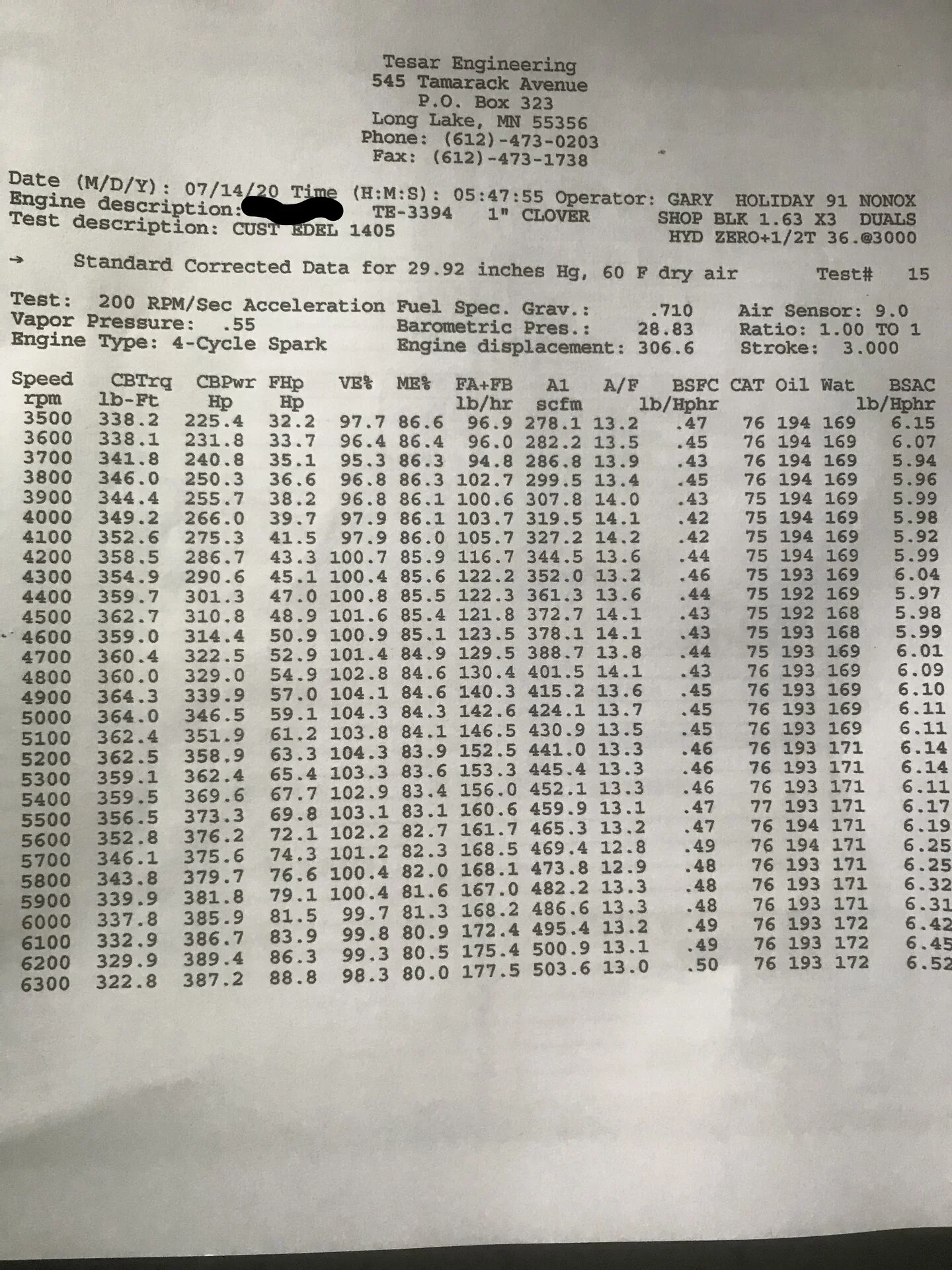

This afternoon I went to the engine builder to see the Dyno test. I would have put together a short video but I'm having issues with my PC stuck in the never ending spiral of death with an update....
But here is the sheet with my edelbrock 1405. He just bolted it on and ran it. No adjustments needed as you can see.
