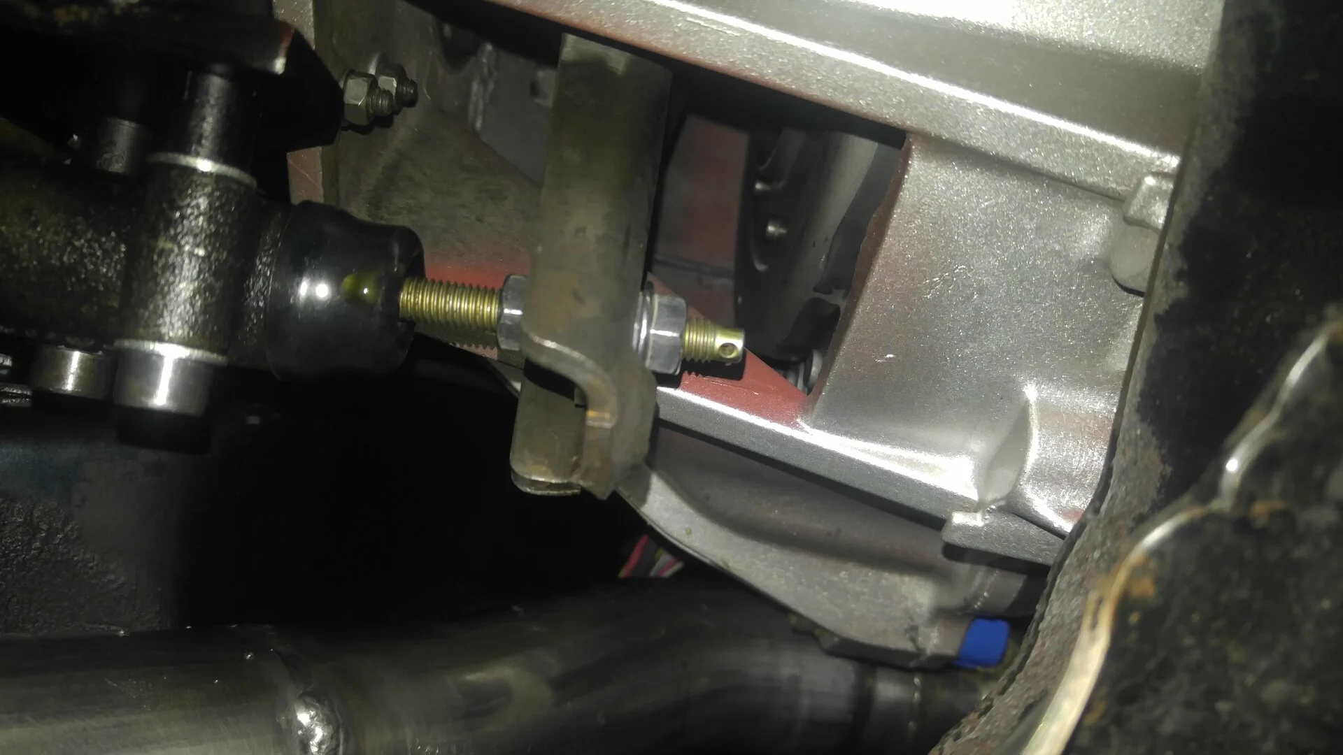

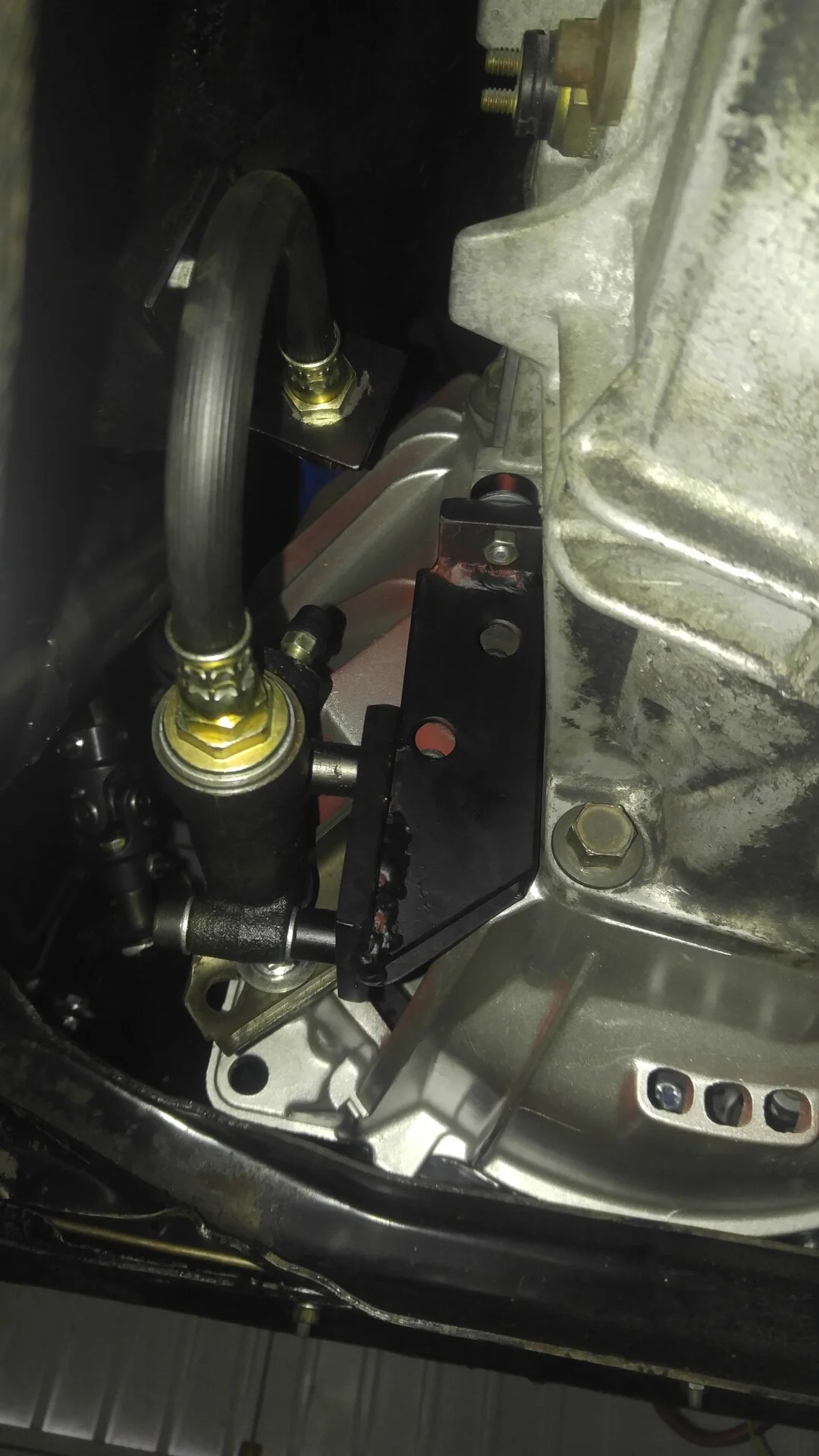

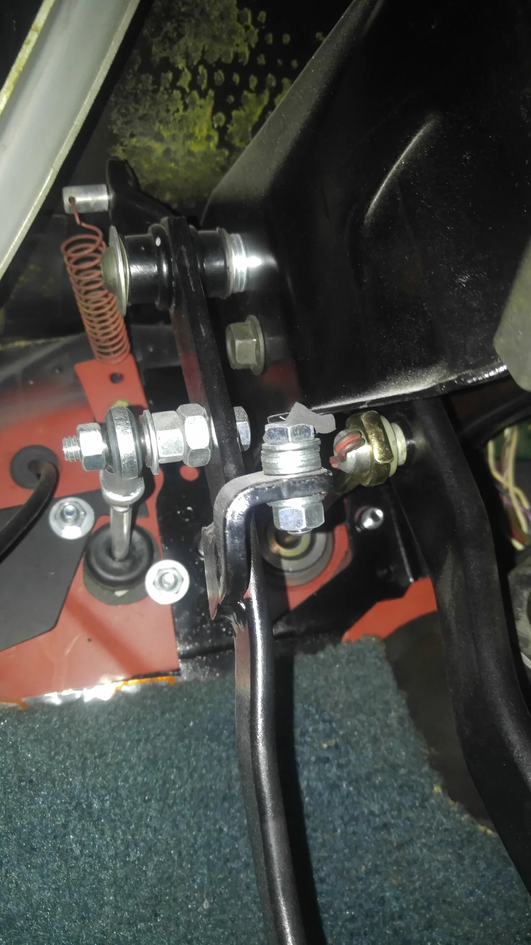

I have just a rod with a ball joint bolted to the clutch pedal (no levers). My master and slave have the same diameter, so I have a similar distance from pivot to cable attachment. You can have a look to my build thread there are some pictures with the master clutch cylinder beside the brake cylinder (without booster)...
So does your master cylinder pull? I mean are you attaching to the top of the clutch pedal?

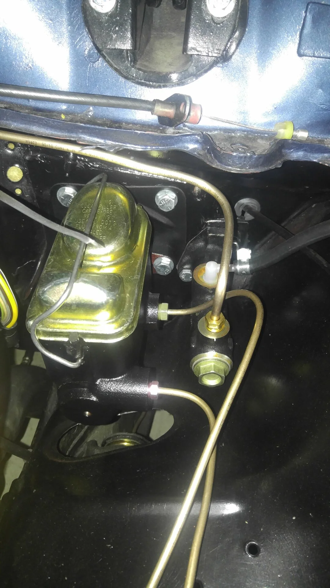

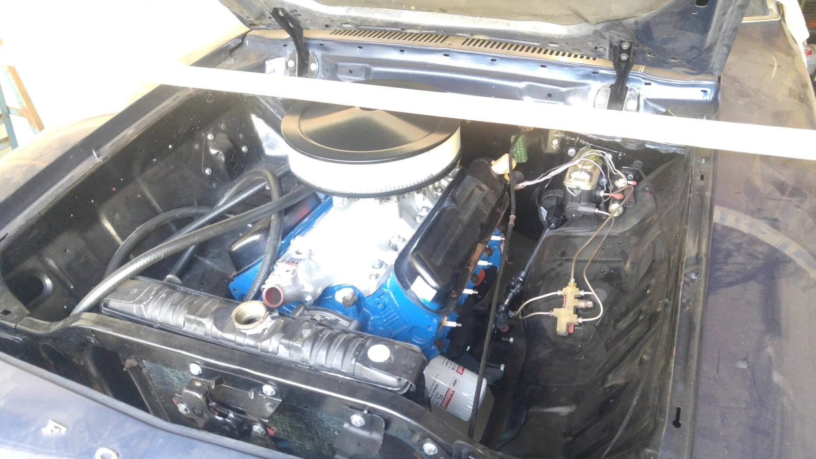

Sorry. Its my bad description. The rod is pushing. And the rod is attached below the pivot point of the clutch pedal. The distance between clutch pedal pivot point and hydraulic cylinder is the same as the distance between clutch pedal pivot point and cable clutch attachment. Because clutch cable and my hydraulic cylinders have the same ratio 1:1 (which every cable has... obvious). My clutch master sits a little bit lower than the brake master and very close to the side wall of the engine bay. I have a reinforcement plate mounted inside the firewall.
It's a solid line in the beginning and than there is a bracket where the solid line is elongated by a hose. It's like every brake system. You can also use a pre made steel flex line with the right length. A friend is running the same lada hydraulic cylinders with long steel flex in his 64 rally falcon. I like more the clean look with the solid line and the short flex hose underneath.

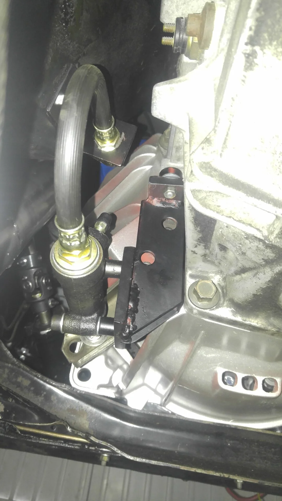

My slave cylinder sits behind the clutch fork.
I can make more pictures, when I will finish the exhaust. I try to get better pictures with less frontlighting.
Here is a better picture:

An air cleaner, GT40P heads, and a master cylinder? :jester:
Oh wait, not that pic.....
