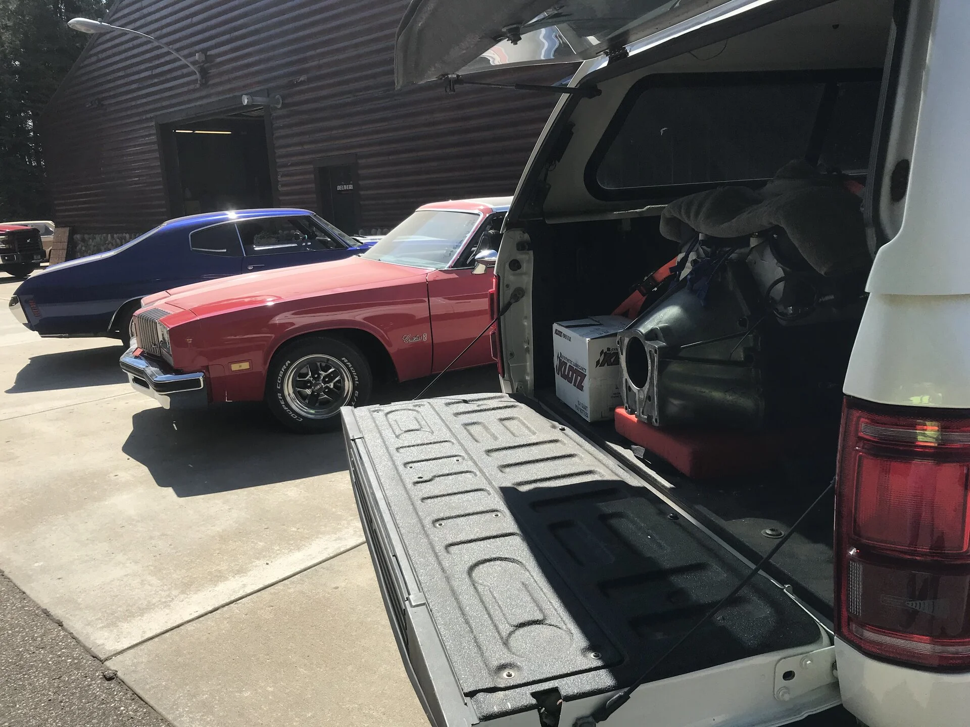

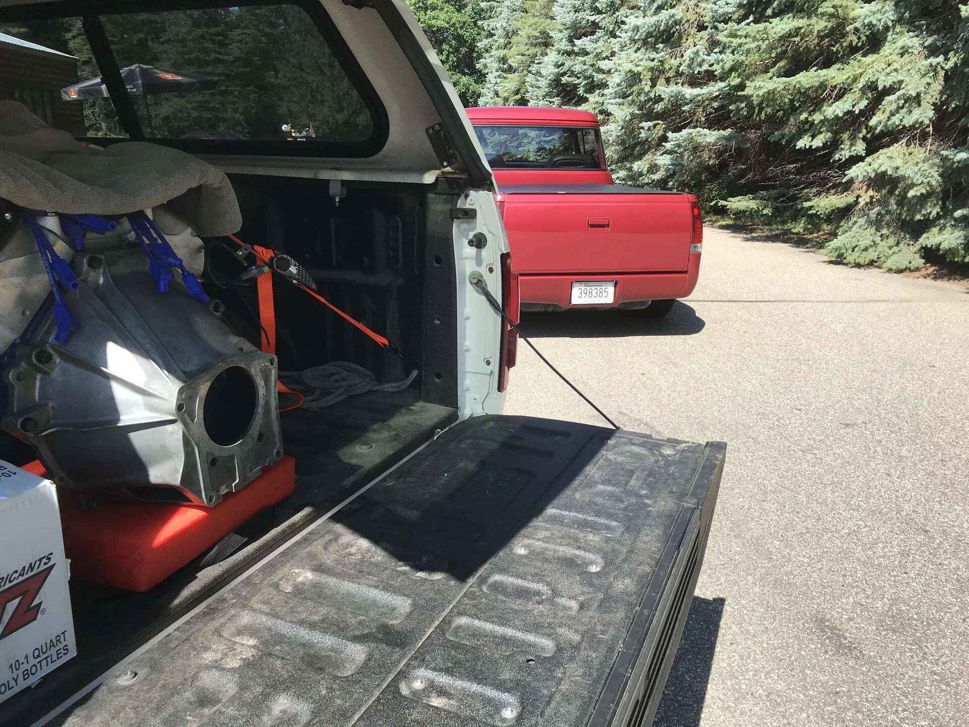

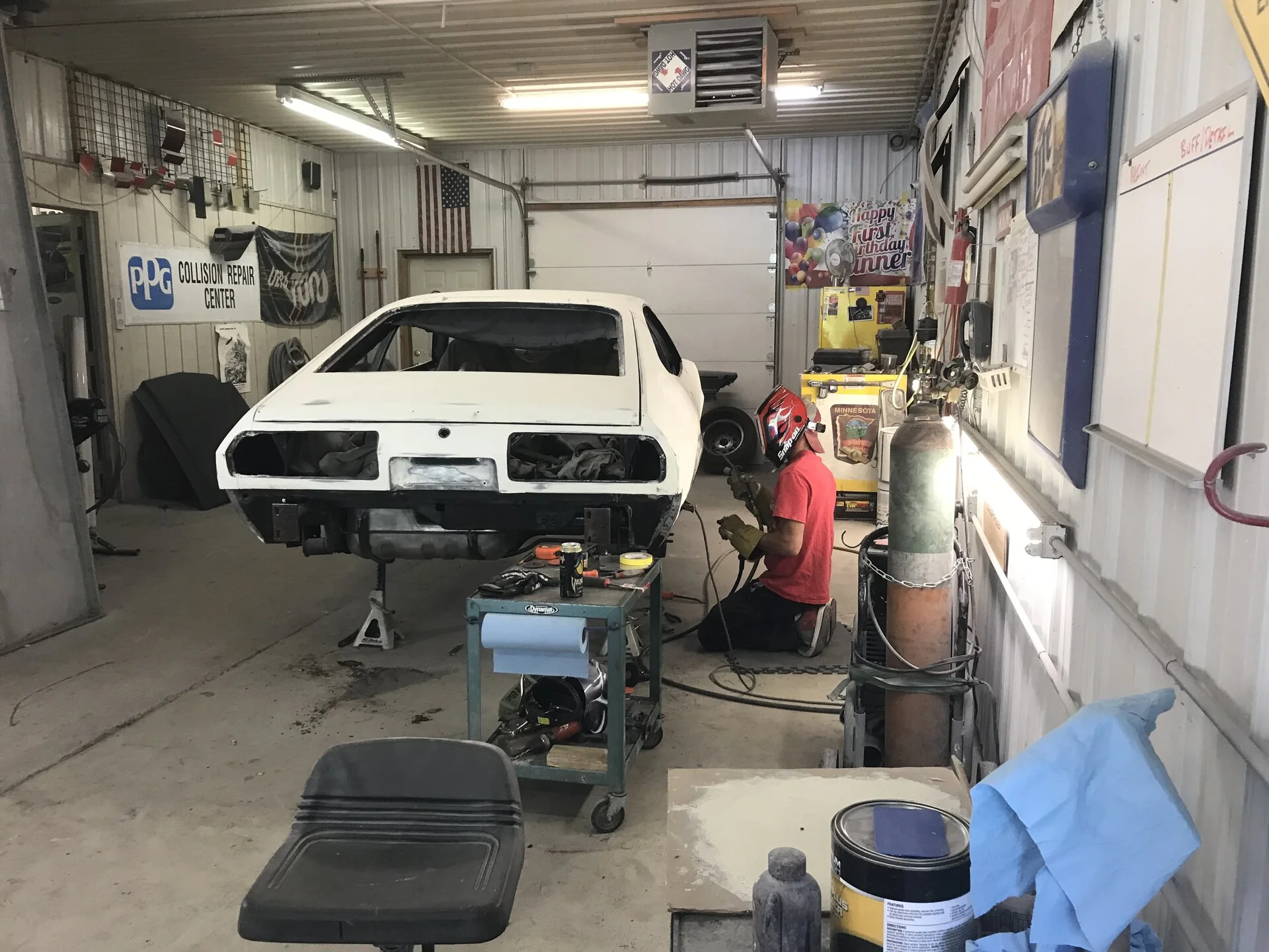

Dropped off the motor today. They were welding up the steel. Things should progress nicely now. Fishing trip planned next week, again.

I had to look twice but yes. Not sure of the year. But it was a CutlessS. Somebody just drove it in to see what they could do for it. Covered with dust but looked really nice. Behind that was a 454 Chevelle.

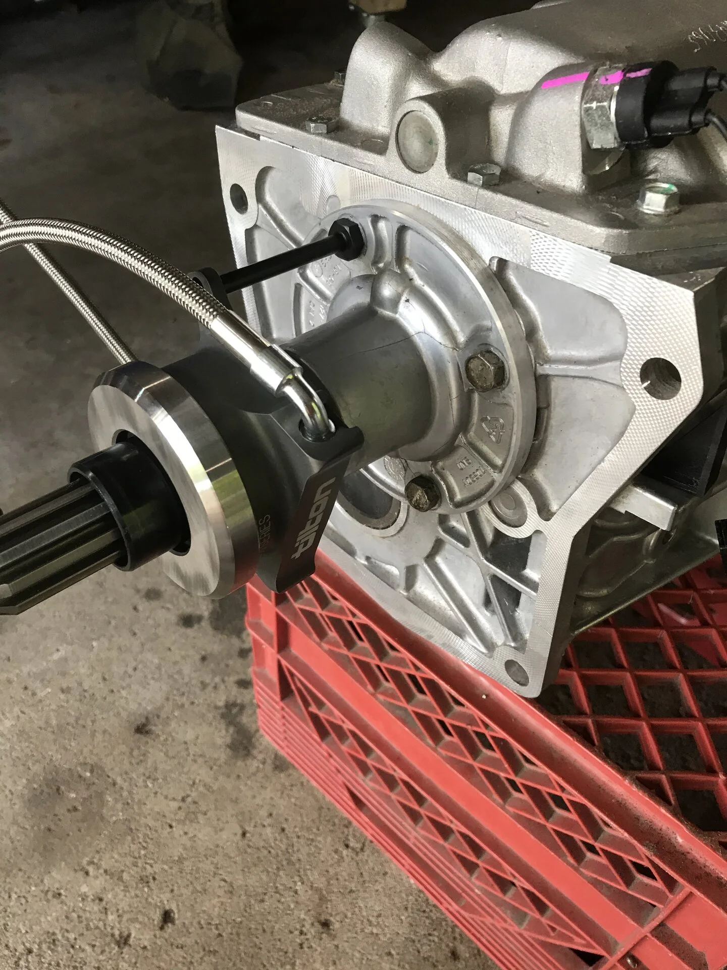

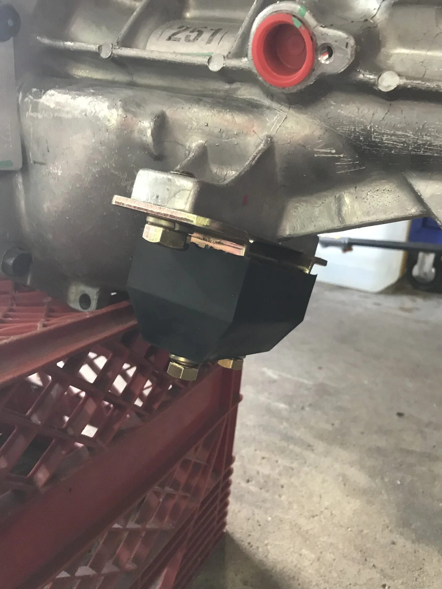

Installed the hydraulic slave cylinder and the prothane transmission mount today.
