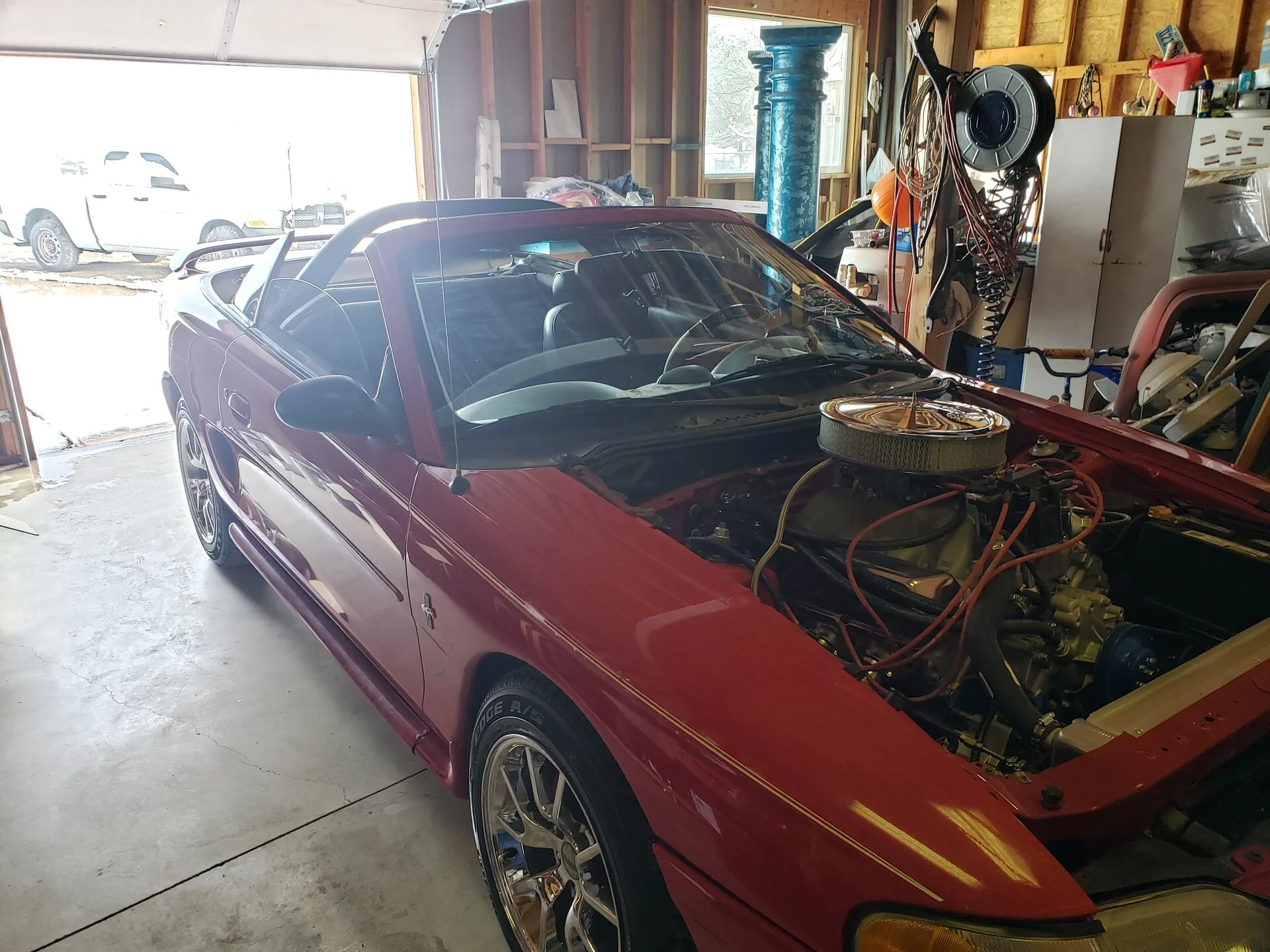

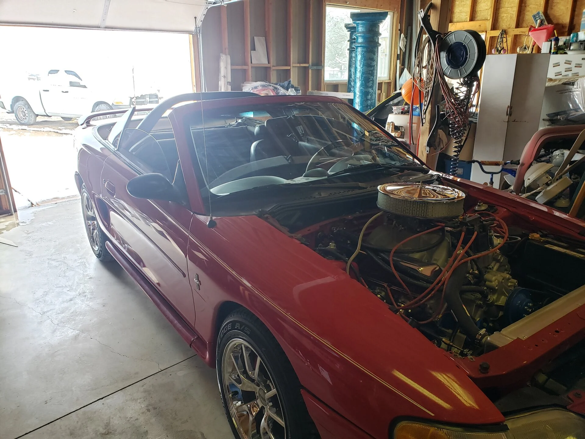

Just my input I have a DOVE 460 with the C-6 and 3,500stall (very loose) unmatched cam and intake and a 750 carb went 12.50 at 108. so for drag racing it's good. car with over all stock interior came in at 3080 lbs. I now am building in a diffrent car, a stock bottom end Trick flow heads and intake single turbo car to play with. The 460 went in easy and was worth the build. but not a very streetable car.
It is a 1971 460 with C9VE-A heads. C6. Comp Cams extreme energy . 585"/. 588" lift. Weiand Stealth II. Edelbrock 780 vac sec, man choke.
B&M Hammer Shifter. Roush FR500 rims.
Hooker Super Comps (ceramic).
Strange man mast cyl.
Oh ya, it's a convertible!
