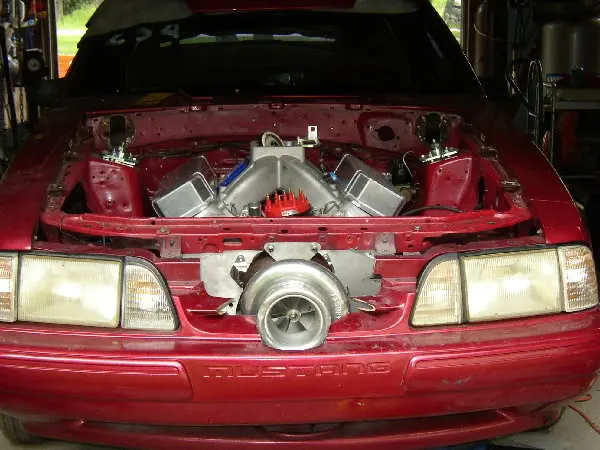

i was doing a bbf 572 with a 101 mm turbo. i was looking to make 2000+hp to run true 10.5. a 460 is alot of money to build it right. it is heavy and everything is alot bigger. the headers was 2 1/4x4 and my pipe off the turbo was a 5 inch pipe. i put a rear end in that was 40 spline axles and it was over 5,000 for it. if u are looking to make 500-700 hp i would bo a small block. i never got to finish my big block because i had some 1 hit me on my bike

Man can you imagine just 8psi through a 540ci? DAMN.
