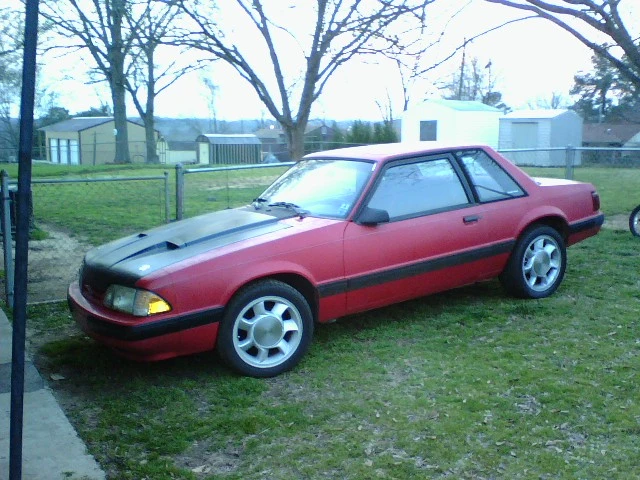

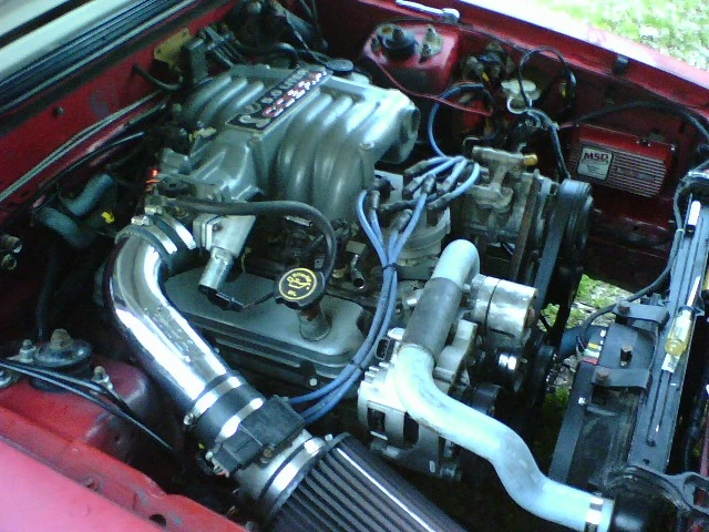

And a few other progress pics. I still have to put the fuel lines on.
The rear is a little high. Its because I haven't changed the rear stuff over yet.

My 91 Notch is a 4cyl to 8cyl swap. I used all 92 GT stuff.....If I remember correctly, I think I had that same connector left free also. I was pist when I was putting it together, and I couldn't figure out what it was for. If I had that I left it hang free.
Is that on the passenger side kick panel?? IF it is I had that too.

It is easy. I had both cars stripped, and one car done and running in three days..by myself. I had no help pulling, swapping or installing my motor/trans/wiring/clutch pedal box. I went from auto to stick, and swapping the clutch pedal box took the longest. I had a hoist and air tools, which helped me out.
GET A DONOR CAR!!!! That will make things fast and easy. Try to find two cars the same year or 1 year apart. I had a 91 Cyl Coupe and a 92 GT v-8. Easy swap, everything was the same!!!
