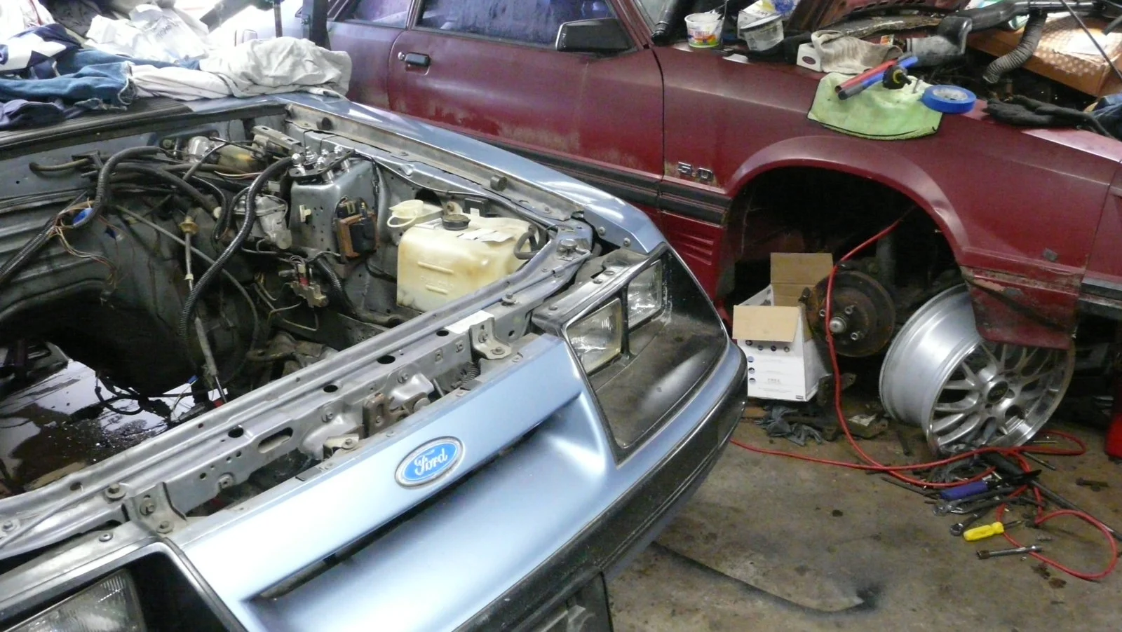

Hello. I currently have both cars side by side in my garage. one is an '82 with a 302 and 5-speed. The other is an '86 notch, 4cyl 4-speed. I have already pulled the 4cyl and 4 speed trans. What I need to know at this point is can I somehow use the '86 harness and modify it to work with the carbed 302, or would it be better to just use the harness from the '82? Or, can anyone tell me if the '82 harness will match up to the '86 dash harness. I have been reading threads for hours, I may have missed something. I wanted to get opinions and advice before I continue. I have owned the '82 for over 25 years so I am familiar with most mods other than the harness issues. Thanks for your help!

The 82 and 86 are a bit different. You could always swap The dash harness and cluster from the 82 and put it in the 86 with the cimputer sand engine harness.
It actually would simplify a bunch of stuff.
Thank you for your reply. I will do that.
