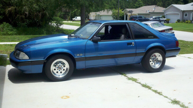

I just did this on my 93 hatch. Swapped the spindles, rebuilt the stock V8 calipers and machined the stock V8 rotors I had laying around. I replaced the wheel bearings and even pressed in new ball joints. Wasn't too bad. I bought new struts that came with spacers and I didn't swap the booster because it's still a 4 banger.
