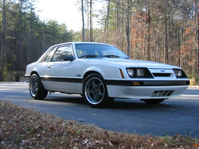

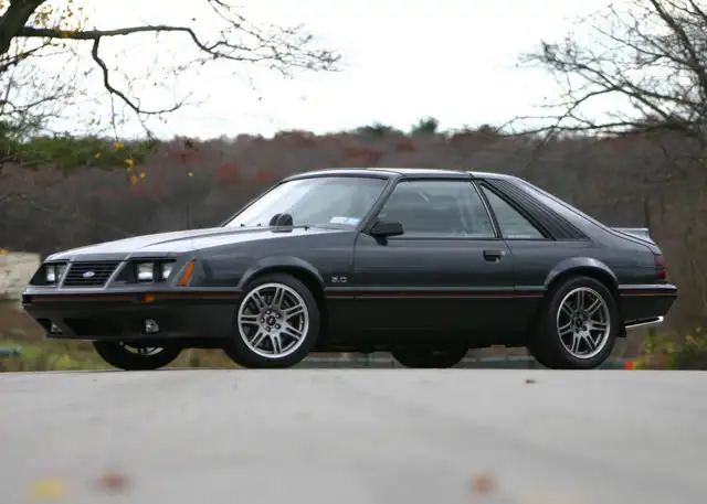

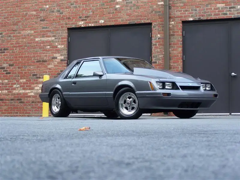

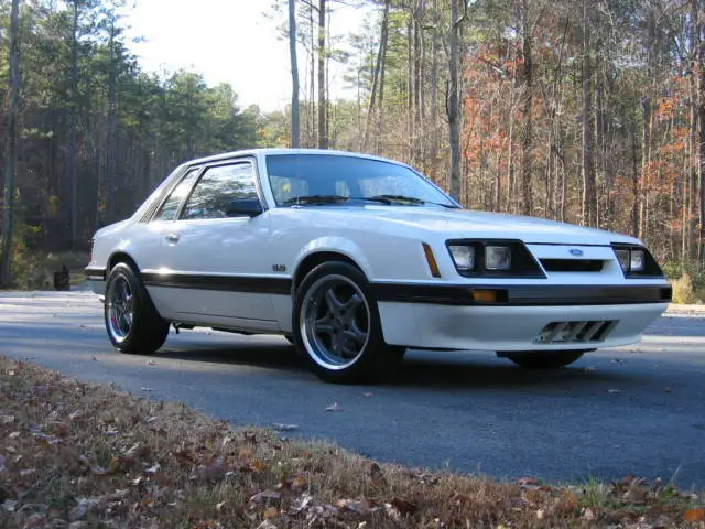

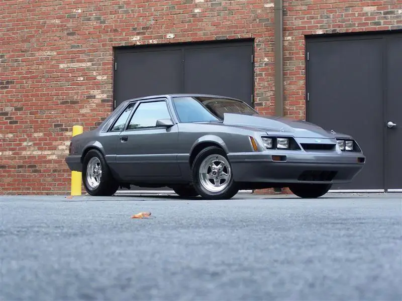

Can someone post some pics of 82-86 LX only noses. I'm converting to a 4eyed nose and what ideas of what looks like what. here is the pics i have saved already but not sure of the year of the car,so if you could name these off by year then thatd be cool!also i have a coupe and could i put 82-86 rear 1/4 windows in mine?
i really like these first 2 white ones best
are these 2 diffrent years? i like all these styles cause there is no fog lights
is this like a 83?

:nice: go with the 85-86 LX nose. leave the 1/4's that are already in there.
all of them are 85-86's but the one hatchback witht he 10th anny cobra wheels is an 83 or 84.
i know i know! but i want a 4 eye and there really isnt nothing here. i bought a 85GT roller a few years ago but it was way worst then i thought once i got into it :mad: if i could find another roller or non roller then i'd pick it up and take all my mods off the 93 for it. oh yeah and i wont say it's a 85/86 or what ever year nose i get, it will always be a 93 :( peace
john:p
They are all 85/86 LX except for the one with the 10th anniversary wheels which is an 84.

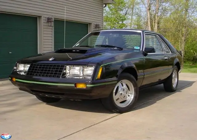

84 is an oddball year because the LX did not even have a valence like the 85-86 did, it has the same nose that all 83's had...looks much like the 84 T-Top coupe. HOWEVER, early 84 GT's also had the non-valence bumper that the 83's did.
Here is a breakdown for you...
1979-1982 Standard nose and 1979 Cobra:
1979 Pace Car/1980-1981 Cobra/1982 GT:
1983 ALL/EARLY 1984 GT/1984 LX:
1984 GT:
1985/1986 GT:
1985/1986 LX (only difference is lack of fog light openings):
