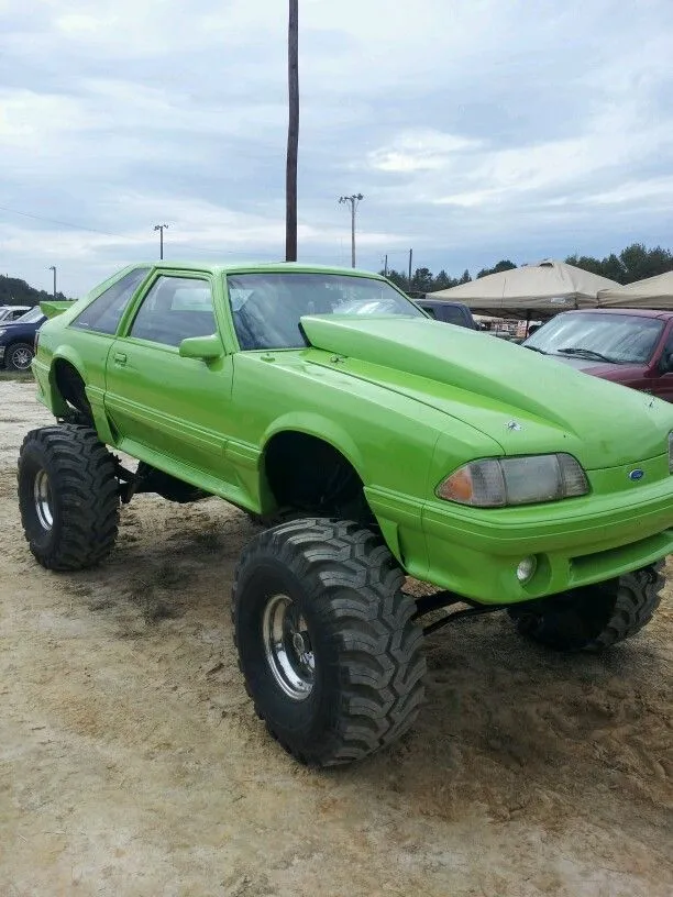

If you do not keep the tire height the same
and run taller tires, the wheel wells will be more filled, not less. At an extreme, running 17” mud tires will cause extreme scraping without big suspension changes and a lift.

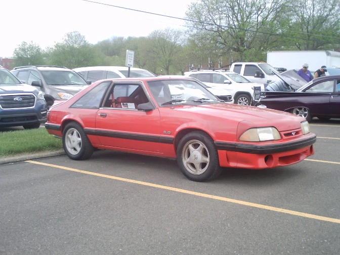

225/55-16
Reactions: MUSTANGJOE
