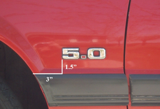

I am replacing missing 5.0 fender emblems. Not even a drunk MOPAR guy will believe LX means a Loud eXhaust 4 cylinder package once my car starts. How far from the door gap and how far up are the right measurements for the front fender emblems? Thanks! I think they are missing after a repaint.
I looked in my service manuals, but couldn't find any info on placement of the badges. If I remember tomorrow, I will measure mine off of my '87 and post the measurements. I know the passenger side fender is still original paint, so I will post those measurements.
I followed this and mine look perfect.
2" from the end of the fender
1" up from the body crease above the molding
I also found this but it's not what I followed. It's from a 4-eyed and I felt it looked too high on mine.

Just measured mine. 3 1/4" from fenderwell and 1 1/8" up from moulding.

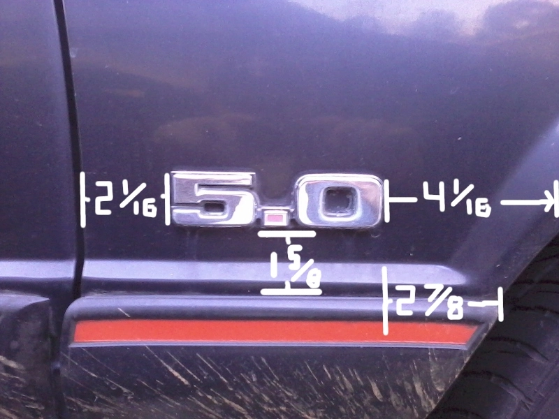

Alrighty, this is what I got. Please excuse the shotty GIMP image editor work, and the dirty car, it's been a long week.:) '87 LX, original paint, never been wrecked.
Thanks tca and ERM636 - I was hoping someone had a low mileaged / know no wrecks car to measure. I'm repainting my project - still going back and forth on 5.0 emblems / no emblems / could go 5.8 (installing a 351w) but those are - I don't know - odd to me - or small pony emblems (from 03/04 V-6) - Newer 5.0 coyote emblem .....leaning towrds the stock look and location of the original 5.0's.....:nice:so this great.
