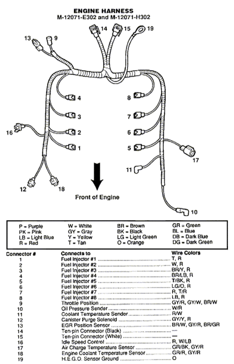

hey guys, i'm in need of some dier help..
to the 5.0 guru's...
http://www.fordracingparts.com/parts/part_details.asp?PartKeyField=23
is this the main harness i need to complete a 4cyl to 5.0 swap? I know i need the injector harness as well. anything else i might need to complete the engine harness besides the computer?

wow, I have never seen that before.kind of looks like the MAF harness. I would find a v8 the same year as you four cyl and grab all the harnesses from that. it will cost less

The harness you made reference to is the same one as this:
And it is the correct body harness for a 5.0 Mustang.
You will need the engine fuel injector harness if it isn't already on the engine.
See the following website for some help from Tmoss (diagram designer) & Stang&2Birds (website host) for help on 88-95 wiring http://www.veryuseful.com/mustang/tech/engine/

First off what year is your car?
The only aftermarket harness (like the one in your link) is for the 91-93 mustangs, If yours is in those year yes that is the one you need. If its from 86-89 you will need a 86-89 harness. 89 and 88 where the only year that had MAF (88 cali. cars only). And a 90 is a year of its own.

Match the harness to the year of your car. You will save yourself ALOT of headaches.
90 is definitely a year all to its' self. BTDT Installed 3 harnesses ( all wrong year) before I got one to work.

I just bought a complete harness off ebay for 140.
