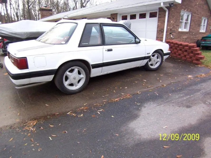

Trying to get back in the loop after all these years of being away from stangs..
I'm picking up a 1990 5.0 Coupe tomorrow. It's in awesome shape for its age and I will be repainting it, etc. I'd like to give the engine a refresh but nothing to serious. What are some things I could do with the original motor? I'm just wanting to overhaul the engine a little and add a nice cam to it.. maybe a B303 to make it sound good. What are some things you can do to the factory engine, heads, etc... Nothing serious... I'm just after a nice running motor without having to spent a few thousand on it right now. If anyone can give me a break down that would be great....
Thanks!
