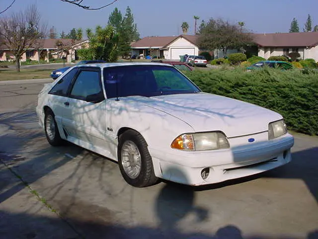

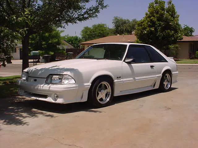

I picked mine up for 3000. Had a couple of things that needed to be replaced and it had 200,000 miles. Paint was good, everything worked great. I attached a couple pictures. MVC-024 was the day after i bought it last January. MVC-007 was 2 months after. Currently it looks the same outside.

Yours looks almost exactly like mine did when I got it. I paid $5000 for mine, it was bone stock, in perfect condition. Mines no longer white though.
