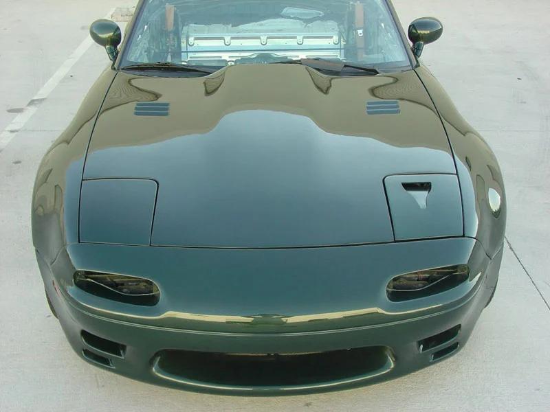

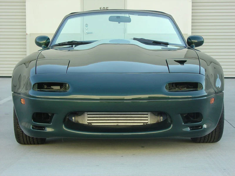

The guide does actually call for milling .25 off the lower. But that's for the fox HO intake. Not sure if my sn95 would be the same height as that. Some pics I've seen make the later one look taller. Will likely just end up going with the earlier GT 40 intake anyways as a lot of the conversions are making it work. That cobra one looks nice though. The tubular one looks real nice.....holy pricey though.
It would be easier to raise the bridge rather than lowering the water... get a hood with some cowl....

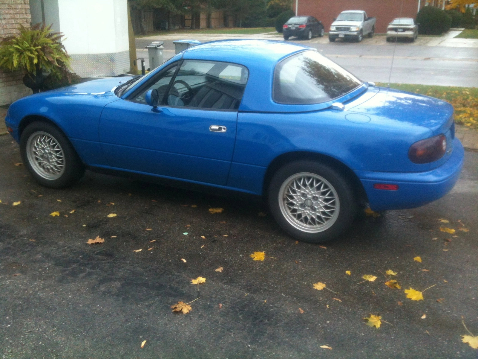

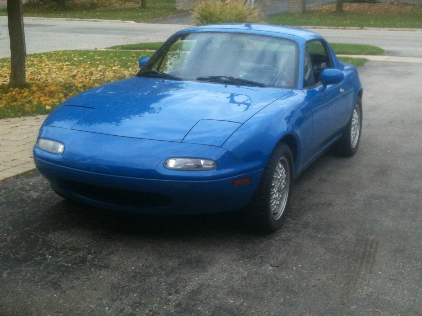

I have the car. Got a nice '90 base model with about 30k miles. Once I get the engine I'll post a "freshening up" thread. I'm sure I'll be asking a lot of questions as I go along with that. Plan is to put some miles on the car as is this year while I gather parts. Hopefully start the swap late fall. Once I start tearing into it, I'll want to get it done fast.
Here's a pic of my little chick car.
