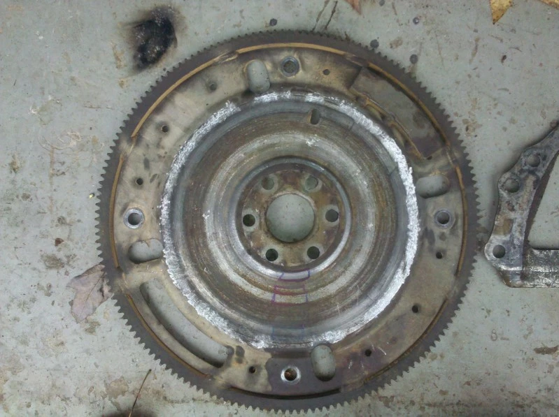

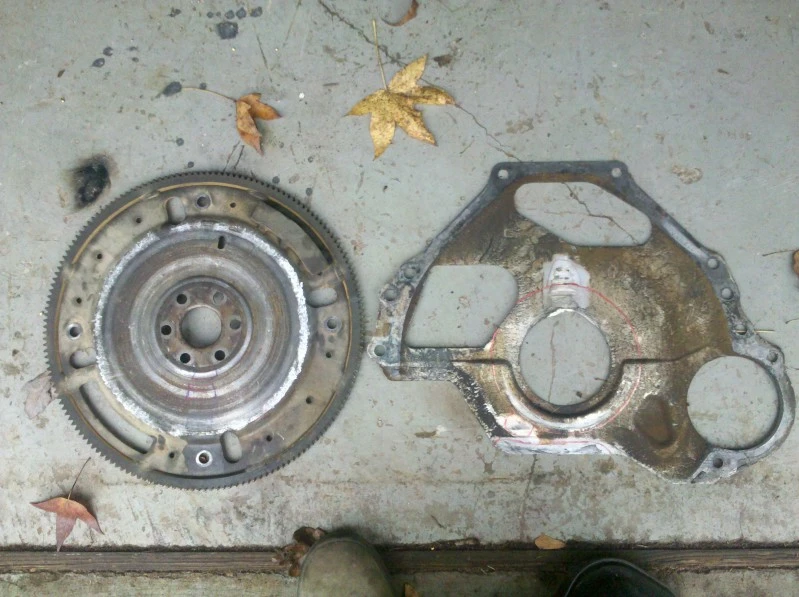

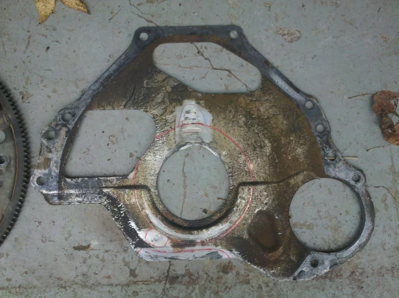

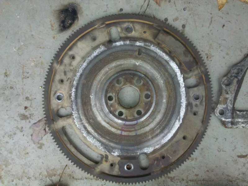

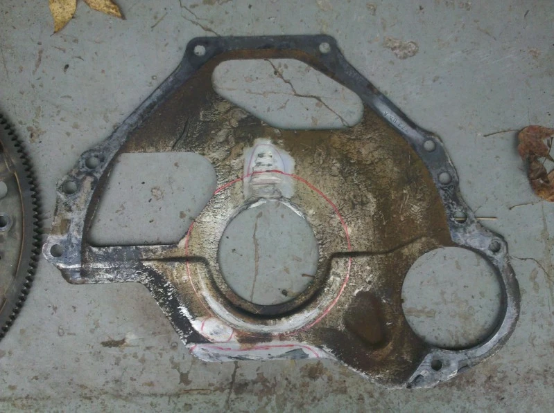

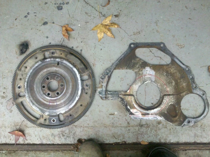

Pulled the transmission with the intention of replacing the pump. When i got it off I saw evidence the flexplate had been rubbing against the shroud as seen below...
The white you see on the outer diameter of the flexplate is white chalk I was using to troubleshoot when it was still installed but it had been rubbing there at some point as indicated by the galling on the shroud as well as in multiple other places as denoted by the permanent marker.
As soon as I saw this I thought I had the answer and did not pull the pump to investigate further. Though I know the sound of the plate rubbing on the shroud is much different, like a lighter metal scrapping sound unlike what I currently have, I figured it may sound different especially at the inner diameter of the shroud where it is more secure.
I cleaned up the galling from the shroud and cut about 3" from the inner diameter to ensure it never rubs again. Purchased a new flexplate just in case it was warped and even threw in a new converter just in case swelling was an issue. Dropped a cool $300 on those two items.

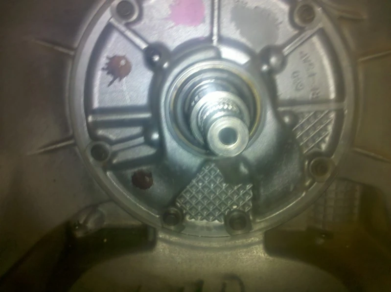

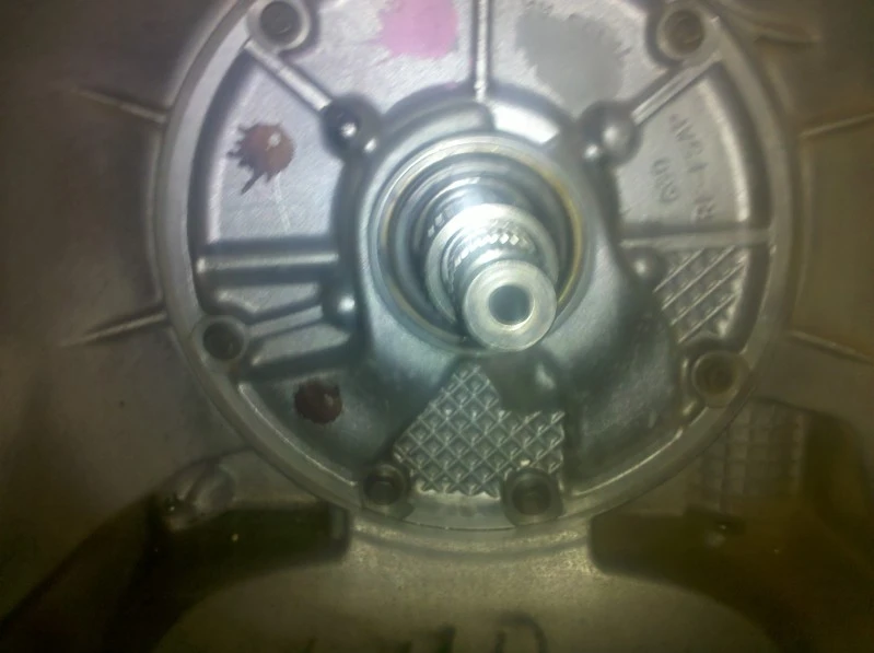

Here is a crappy shot of pump...
Thanks. :-[
