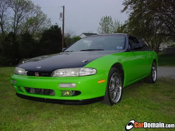

302 into a nissan 240SX
hey guys i'm not of the mustang world but i am a ford guy. however, i currently am restoring this:
instead of the usual (easy) turbo route and because of my specific goals im looking for good solid NA power. i checked out the LS1 and due to price and Size it appears to be ill-fated for my car, however, the 302 fits cause i've seen it done AND i love the heck out of that motor.
so i'm here trying to find block/tranny dimensions, weights, and pretty much any kind of information i can possible absorb from these forums to aid me in my build.
so... resources?
Now thats definitely original; a 5.0L S13 240SX. I like the JDM tail light lenses too. You probably already know about SR20DET swaps, but that KA24DE can really make some torque with boost ;). I know, get a Titan V8.....
