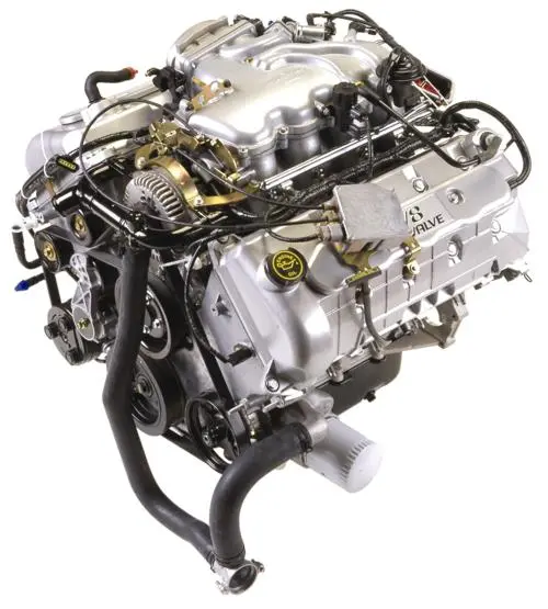

Looks comfortable in there i think =) No where near as practical as a pushrod mill but poping the hood on a focus and see'n "5.0 liter CAMMER" on the valve covers would be to much :lol: FRPP actualy made one of those with the 5.0 cammer engine and can be seen here. The trick would be gett'n a quiet enough exaust so people didnt think you have a v8 under there.
